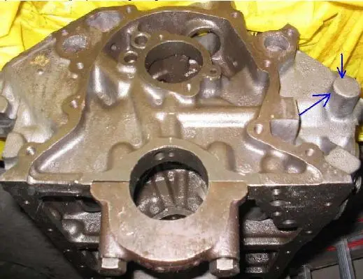

Vans and trucks are your best bet for a mexican block. Best way to tell is the mexican "bump" it is on the front and looks like somewhere an acc brakcet would bolt up, but theres no threads. Once you see it it will obvious, but I dont want to go take pictures.

I found a picture of what you mean(uploaded), and these following casting numbers:
D1ZM-6015-AA
75ZY-6015-AA
89TY-6015-AB
And the obvious, if looking at a bare block I would assume, the valley etching saying "HECHO EN MEXICO".
I'm just lookin on some online junkyard searches, thats why I asked what models would I find a mexican 302 in, but it looks more like something I have to go local junkyard jumping for and pure luck.
How can you tell in pictures if I find a mexican block online if its ready for hyd roller setup compared to older blocks that arent? Are there extra holes drilled I should look for?
