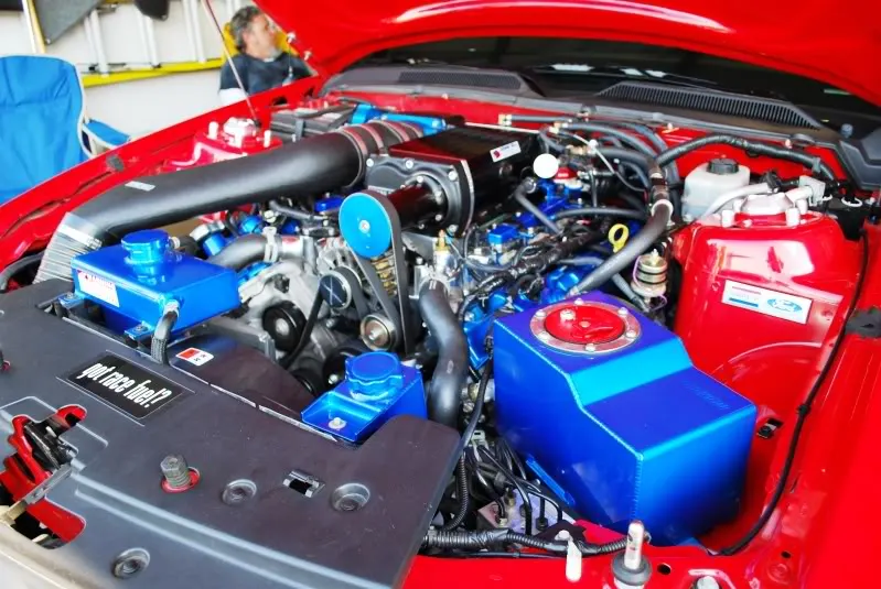

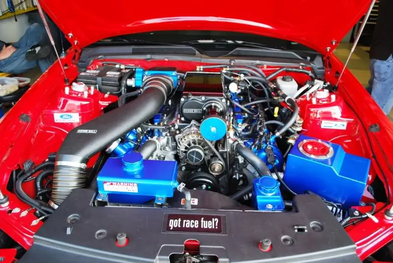

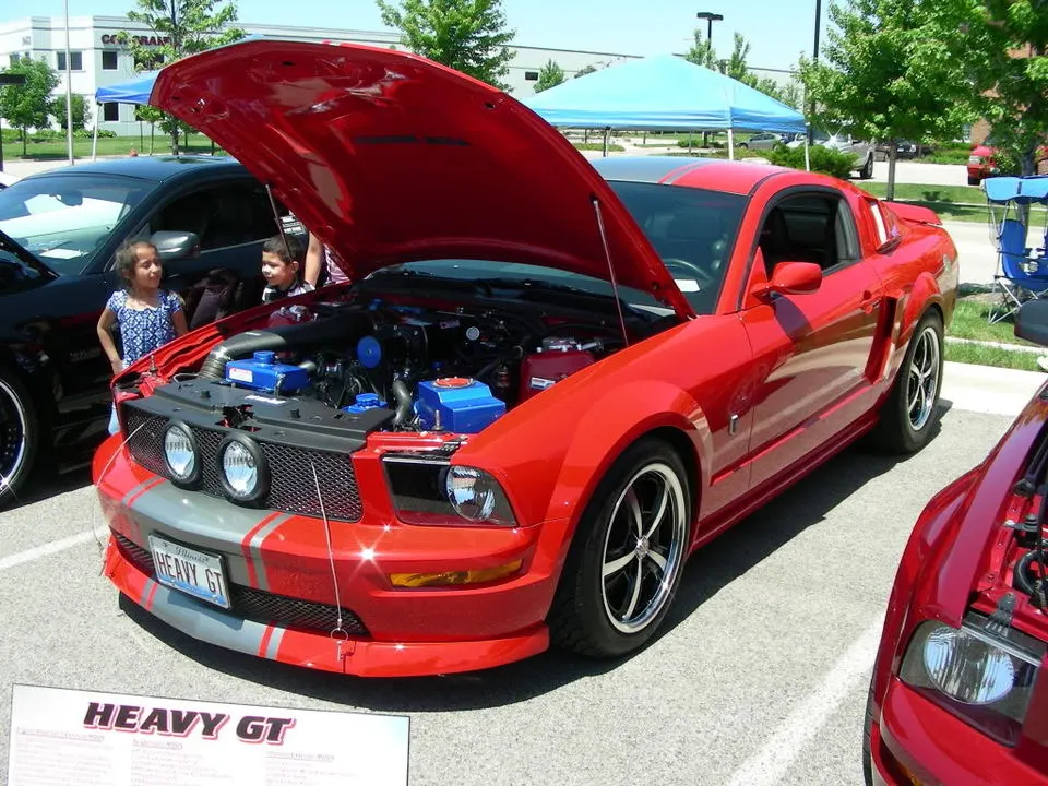

I went with the KB and am glad I did...
I like the FRPP/Whipple kits personally. Physically, all of the Twin Screw/TVS kits are capable of 600+HP and are all rock solid. Money aside, for me it comes down to fit and finish and visual appeal when you pop the hood.
I like the very factory look of the FRPP/Whipple and Roush kits. :nice:
HEAVYGT....you can certainly tell that there was a lot of TLC put into the under hood area of your car. Personally....its just far too much "pop" for my taste, but I've always liked a more suble, factory like appearance. In any case, I'm sure its a blast to drive.
Thanks Brian...and your right, she is a blast to drive, especially launching hard from a red light! :D
