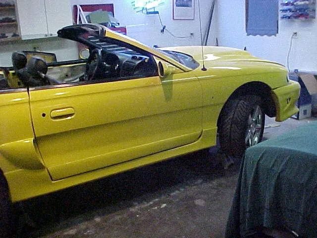

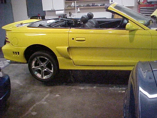

Im putting a off saleen kit from a guy that sells on ebay,probably a mr body kit knock off junk!!!!!!did not get a real saleen because of all the prep work on their urethane,but this thing fits terriable Every night I fit it a little closer buy the saleen kit and follow the recos for filling air bubbles etc

Yea this thing will have every bolt hole in the body elongaded before i'm done And probably 30 to 40 hours fitment,Ive been a service manager for 25 years and even stuff i bought 25 years ago fit better than this
I bought it because of the stories on saleens urethane prep work air bubbles etc
I tried a picture if it works i'll throw on my progress

I might buy a saleen kit for 700 which includes, front bumper, side skirts, door fillers, and rear bumper. They are all authentic saleen :D How hard is it to fit the kit to the car? double sided tape for door fillers?
TO my understanding the real saleen kit pretty much bolts on like the factory pieces/you will need to make a surport for the rear bumper cover underneith or us tie straps The side skirts are no problem 2 sided tape cleaner and body screws in the factory locations The front cover needs a light weight reinforcing under the spoiler To keep heat of the sun from saggingit just use a good epoxy under the lip 700 is a very good price I'd jump on that good luck bubbahd
