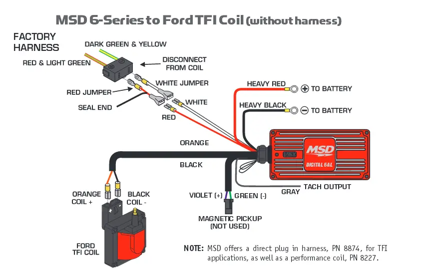

I also never bother with the $30 harness, All I do is use $.30 of wire and 2 insulated and 2 non insulated male connectors as a splice for the connector from the main harness and 2 insulated female connectors for the connectors going into the coil. All you need to do is unplug the wires and plug the stock connector back into the coil if needed.. It also makes a cleaner install with less wires.
Its the diagram on the bottom of page 50
That looks simple enough. Too late now, though haha
