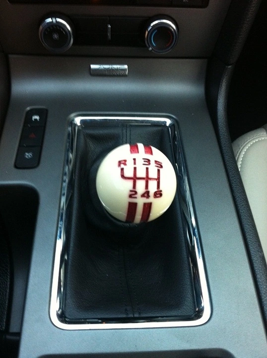

Also replaced the stock shift knob with a Grabber Pony 3D one with Candy Red numbers/strips... Pretty cool...
