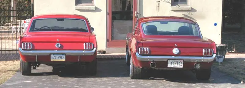

You can still put tail pipes on the car and keep it looking clean, there is no need to dump right behind the muffler. The red one on the left has full pipes on it, they have turn downs just behind the valance and are tuched up behind the valance so you don't actually see the pipes unless you squat down and look when next to the car....the bottom of the turn down is about 1/2 lower than the bottom of the valance.
Or you could go HIGH profile like the one on the right ;)
