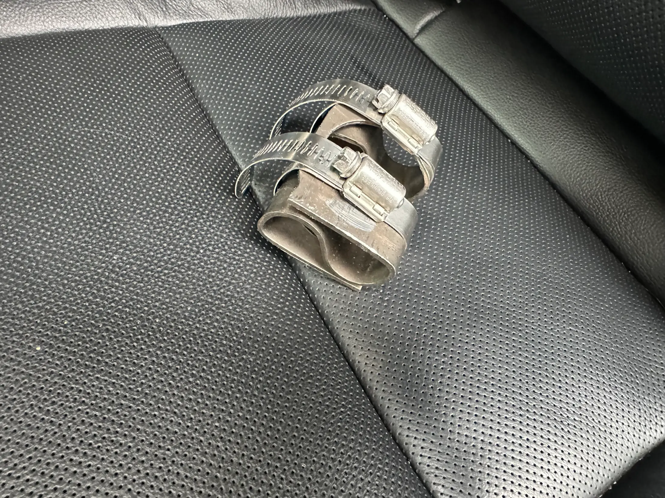

Well, the hose clamp method worked. Made this little hand-grenade at work, and it went right in.
Everything mostly buttoned up. Just need to refill the diff, reinstall my panhard bar and maybe polish and ceramic coat my wheels before I put them on. Maybe it will stay mild enough for a test drive.
Unsure if I’ll do the SN95 now or spring. My wife a little irked at me for stinking up the place in friction modifier. Might want to wait until windows open season. Or maybe not.

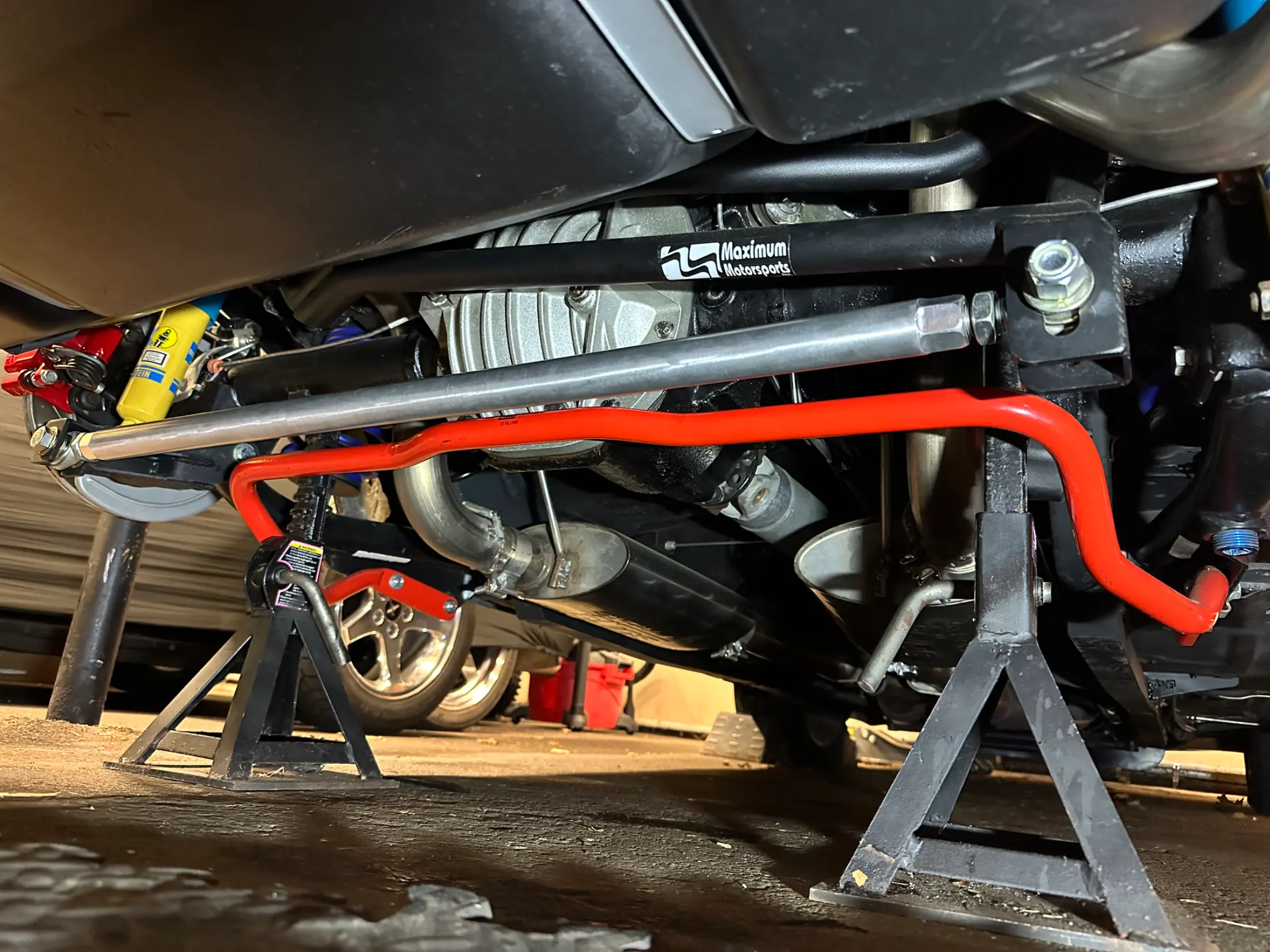

These little squeeze packs of diff fluid sure are nice. Just attach a 1/2” ID hose and it was really simple to fill the diff.
Just need to adjust the Panhard bar and done.

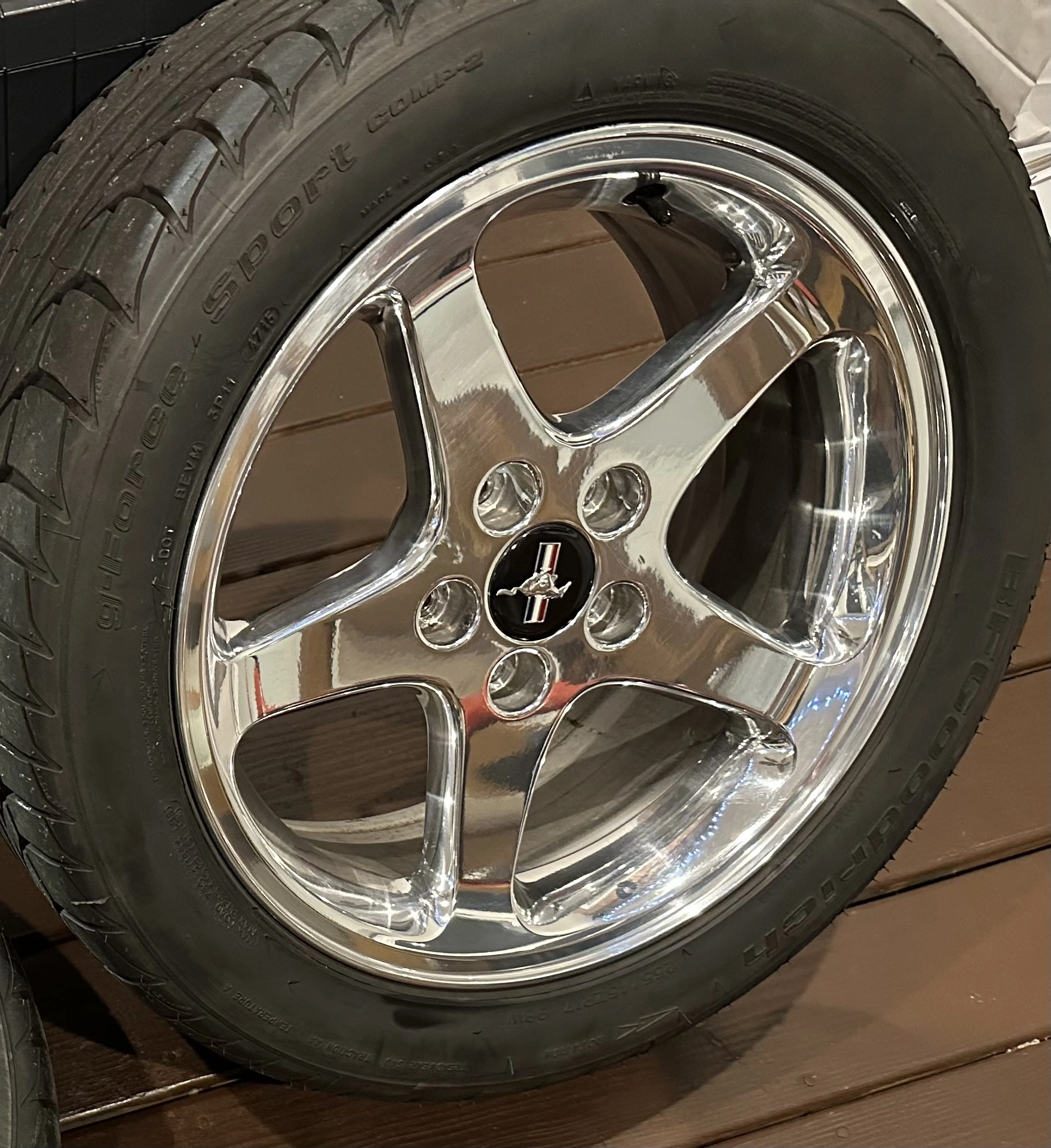

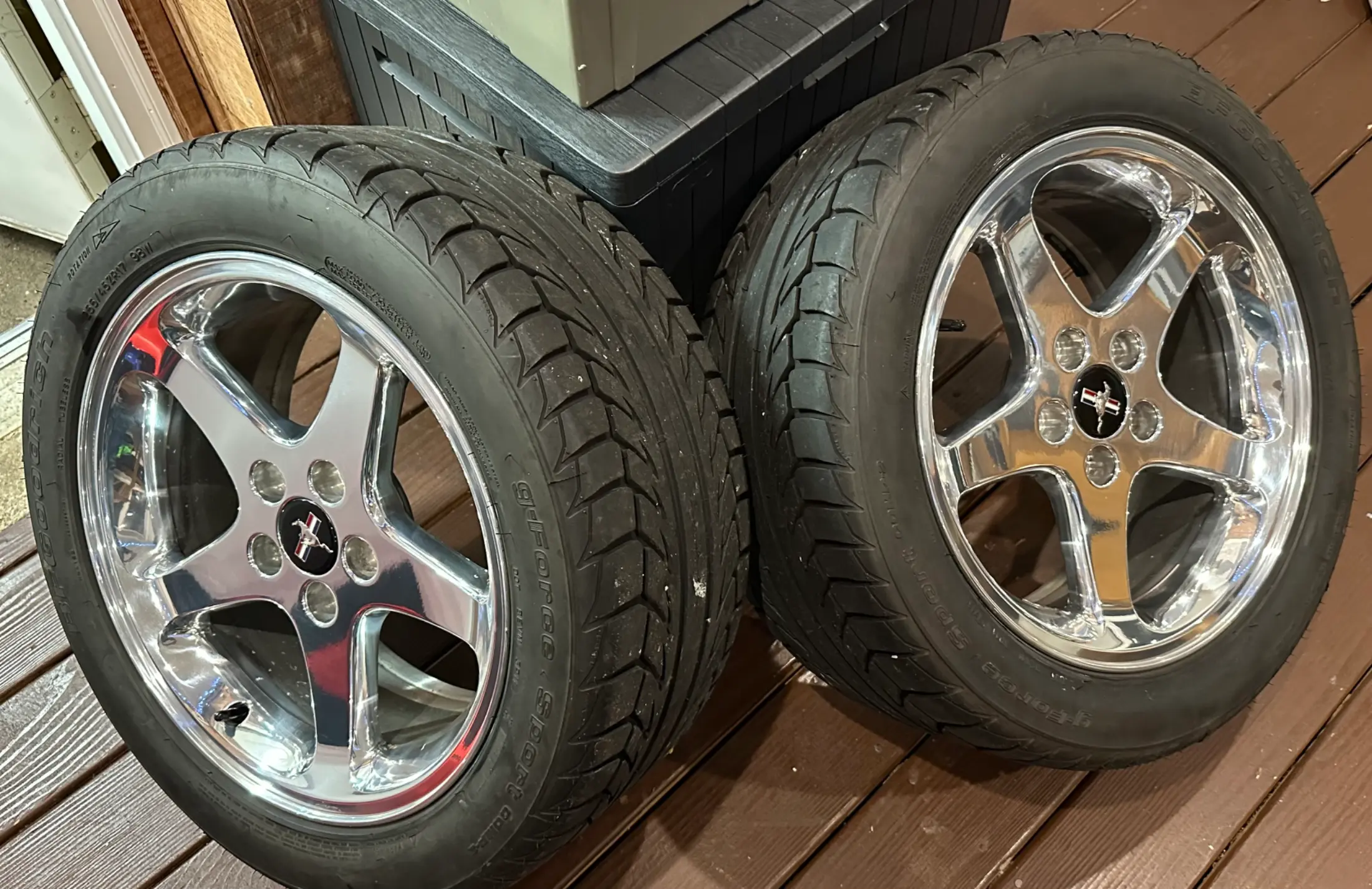

Ok. Polished up and ceramic coated the rear wheels. Will do the fronts another time.
Really wish these things were reproduced in a 9” wide version. I like them a lot

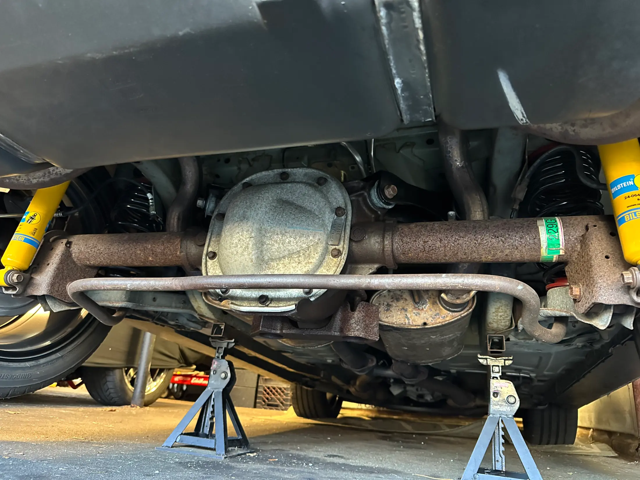

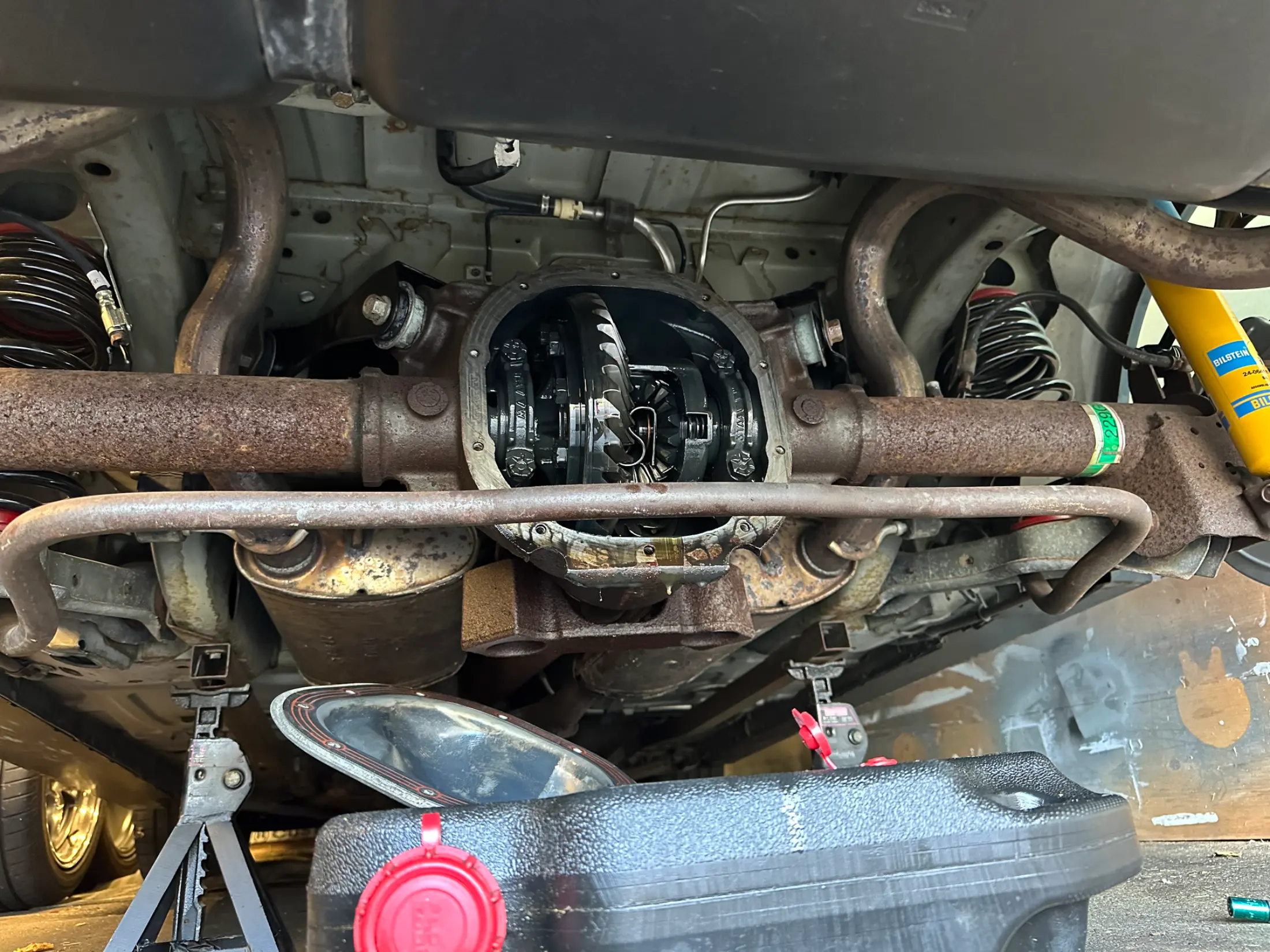

Welp. Round 2

Get it man! Curious to see how worn the clutches are.

Both sides measured about 0.635” thick. The fox was 0.642” thick. Reinstalled the stack at about 0.655” thick.
Visually it didn’t look that worn. There was still friction material on all the disks p
All done. Just need to grab some diff fluid in the AM. Banged through it quick to minimize the open diff cover and the smell. Didn’t hurt that it was 60 today so could do it with garage open and assemble the stack out in the driveway.
