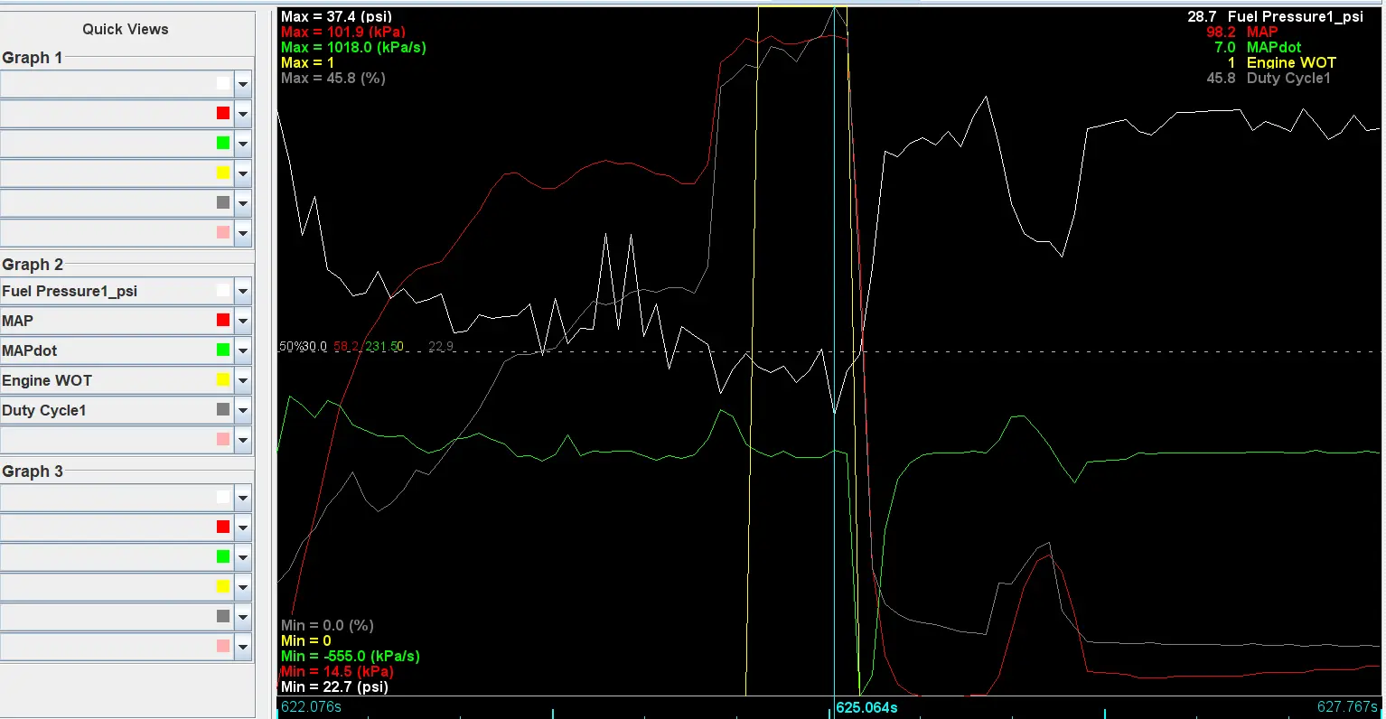

Just happened to be browsing through the data log and noticed something interesting.
WOT pull. I hit 5100RPM before upshifting and letting off. Fuel pressure is interesting.
As i rolled into the throttle and got under load, pressure dropped to 29psi. Recovered back to 35-37psi when I let off. Duty cycle was 45% but my AFR was still lean at 14.2 for that KPA range.
190LPH pump. I would think that's enough. No? I definitely need to go back and recheck the static FP setting to make sure it's at 39psi vac off.
verticle blue line is right at 5100 RPM. Now i have to go back and check other logs to see if i'm not giving enough fuel at WOT.

Mustang5L5 said:
190LPH pump. I would think that's enough? No?
Is 'maybe' a good answer?
When you start producing enough HP that stock fuel rails and lines begin to resist that fuel volume then a high pressure pump is recommended.
They [resist] the pushback, so to speak.
I do not recall your entire setup.
Also, see if you can get a read on pump voltage when this occurs. It's possible there is a voltage dip at this rpm that you're not aware of. This could effect spark too. I saw a scenario similar to this on a dyno-run. There was an unexplained dip in the power curve that started the investigation.

302 with TFS heads, cam and ported cobra. Maybe 325 crank HP. Should be in the realm of what a 190 pump should support.
I need to dig into this. Pressure shouldn’t be dropping off that much at WOT. I need to recheck my vac off pressure and maybe change out the fuel filter and shake it out. It should be new.

looked through more datalogs. Looks like just revving the engine causes FP to drop rather than go up. I see it rather consistently. I think something is going on here. Will need to investigate further.
Sits at 32PSI with engine running. ABout where you would expect. When you rev, it drops to 29psi and then recovers. I would expect it to rise to 39psi.
First thing i'm going to do is test the sensor and verify the MS setup is calibrated right. I can buy a cheapo on Amazon, plumb it into a pipe nipple with two coupling and fill it up via compressor and gauge to various pressures just to make sure the MS is reading properly.

I think you got it. I do think these readings are accurate. Looking at my logs, i see this as a trend which makes sense as when I was trying to work on Accel enrichment, i was having to add a lot more fuel than I expected and still seeing a lean spike.
I have some parts on the way to try and verify the reading is correct (i think it is) but I think I'd drop the fuel filter and take a look at that next. I have a full tank of gas so not really looking to drop a tank right now.

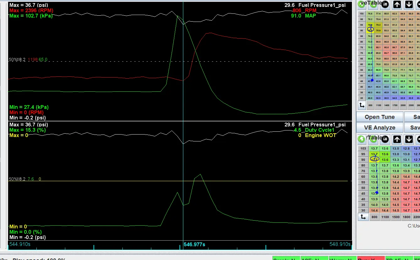

Heres a log snapshot. Idling at about 32psi. Blip throttle in neutral. Injector pulse width goes up. Fuel pressure drops to 29 and AFR goes up.
It;s as if the FPR does not respond to the vac dropping. The fuel pressure drop of 2-3psi could be due to the fuel injectors squirting a lot more fuel for that time.

Your 'blip test' pretty much eliminates the possibility of being the regulator.
If fuel pressure dips exactly when throttle demand rises, that happens before the regulator.
A regulator cannot cause a drop when manifold vacuum goes away; It would rise instead.

You might be chasing your tail in this scenario.
I can't get an accurate reading on the amount of time involved during this blip of the throttle, but given how many things have to happen to stabilize fuel pressure from a change in demand, it may not be something that can be "fixed".
Vacuum drops, this has to act on the fuel pressure regulator diaphragm. The fuel used in the rail has to be replaced to get rail pressure back to what it was.
If all of this takes place in fraction of a second, it may be physically impossible to maintain the exact same fuel pressure, or gain pressure in that time frame.
If you could use your cursor on the data-log to measure start/stop time frame of the dip in fuel pressure it might give some clarity with what you are dealing with.

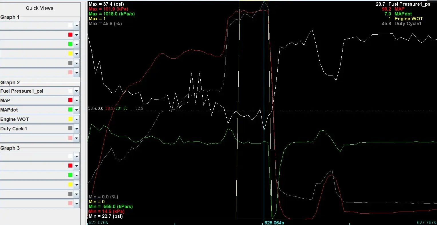

Lets ignore the blip. You are right it's too quick.
Originally what got my attention on this was a 2nd gear WOT pull to 5100RPM in which I checked fuel pressure and saw it was dropping to 29psi.
I guess the question here is wouldn't one assume the FP to rise to 39psi (FP with vac off) during this sustained pull provided the fuel pump can sufficiently deliver enough fuel?
Snip below. I don't have RPM plotted but blue vertical line is right at 5100RPM. You can see MAP (red line) rising to 98 kpa and fuel pressure (bold white) falling to 29psi as RPM climb.
Maybe I am chasing my tail here and nothings wrong, but I'm going off the assumption that under this sustained pull FP should rise to 39?? Or is that wrong?

Your MAP reading at 5,100 rpm is 98kpa.
This is at WOT?
How is that possible?
100 kpa is 14.5 psi which equals atmospheric pressure, which would be a key on engine off reading from the MAP
What is MAPdot? In Green.

MAPdot is rate of change in MAP. So a reading of 7 indicates MAP is still climbing.
WOT with throttle blade fully open should equal 100kpa or close to it. If throttle blade is partially of fully closed you’ll see less kpa
Unless you have a restriction on the engine with Intake being too small for heads and displacement (unlikely in your situation)

I'm not seeing signs of restriction. kpa numbers are where I would expect them to be.
I think I have my list of things to check. Just need time. Car is kinda put "away" so this will take place when i get some time. I might need to siphon some gas out of the tank to inspect a few things with a borescope. No mood to do that right now.
