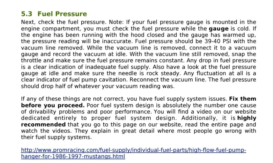

Not sure if this is helpful or not. It's just part of the instructions that came with my tuning download.
It sounds like a bad pump or S- hose to me. But I wonder if the intake being soaked in fuel is a clue. Like a bleeding down injector or something.

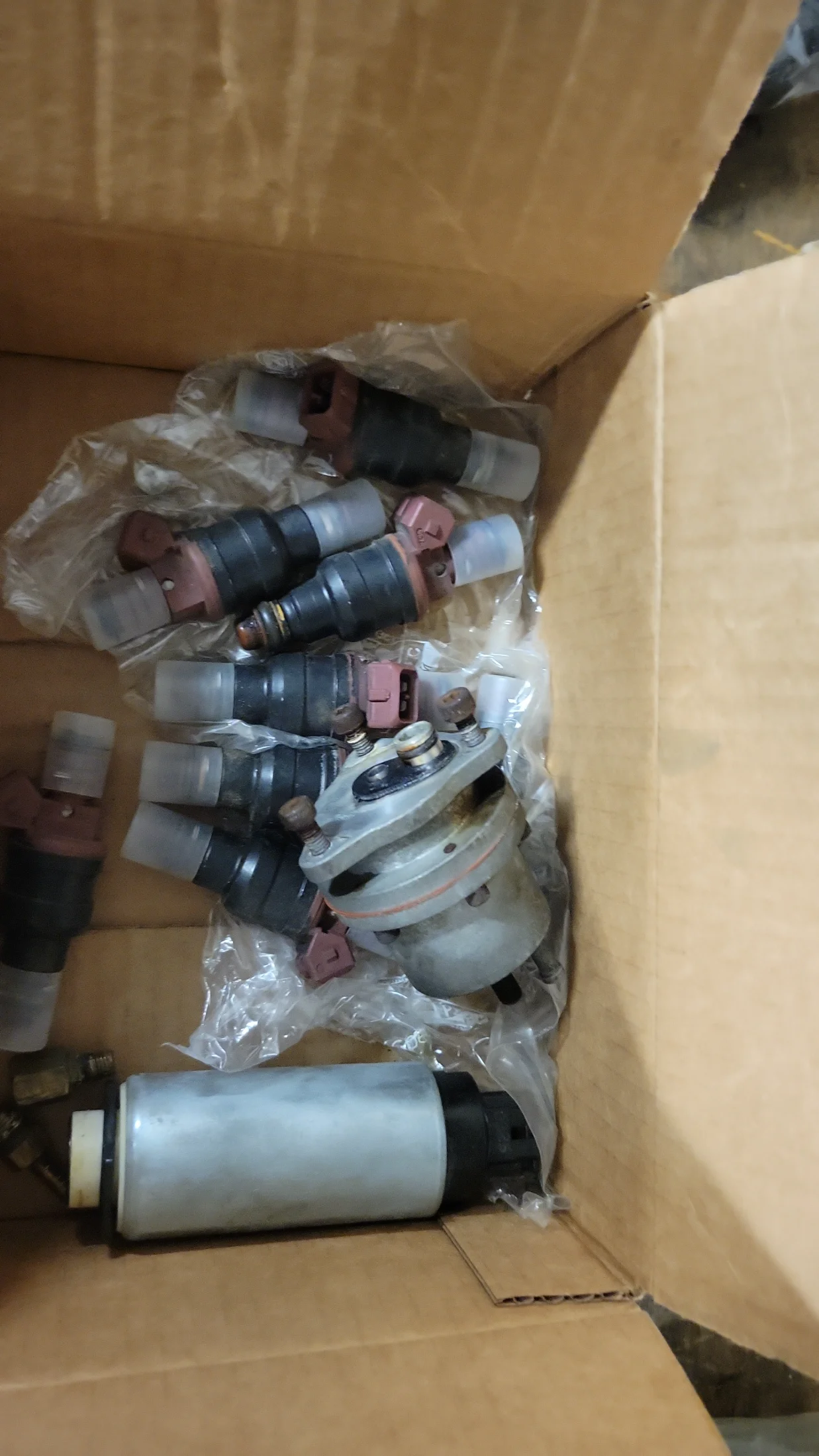

I'm sure I have a stock regulator kicking around if you want to try that route

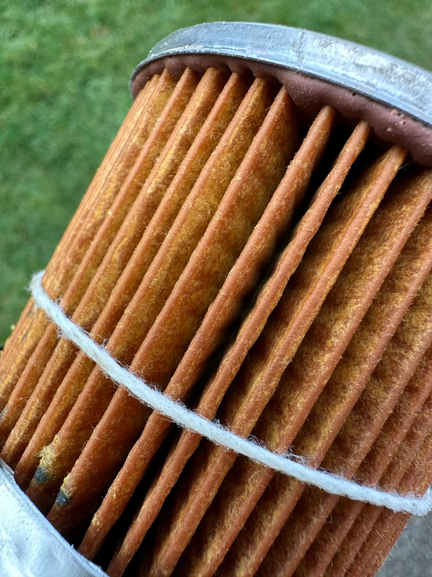

Pulled the old fuel filter. Cut open the filter. Didn’t really see anything bad about it

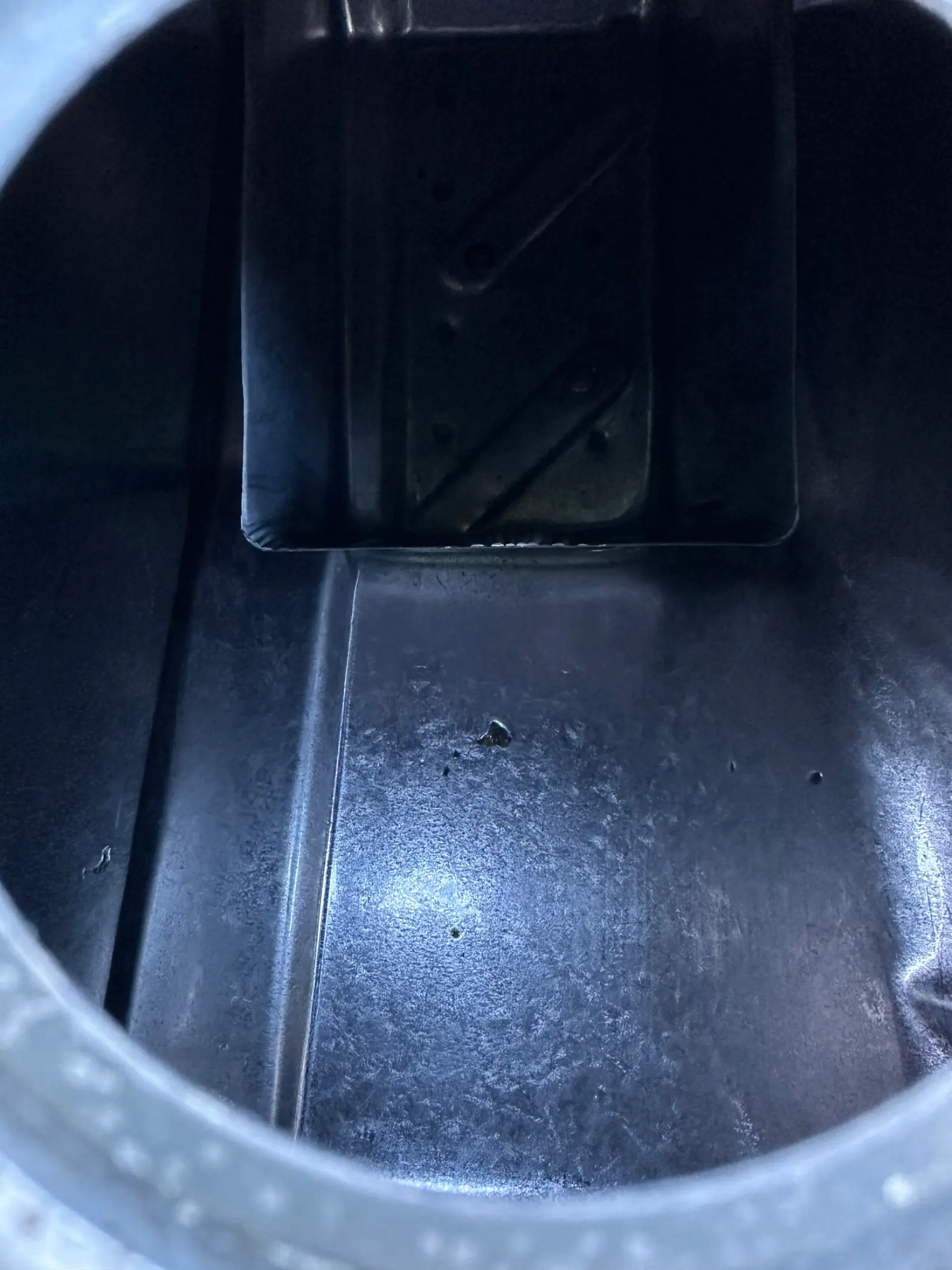

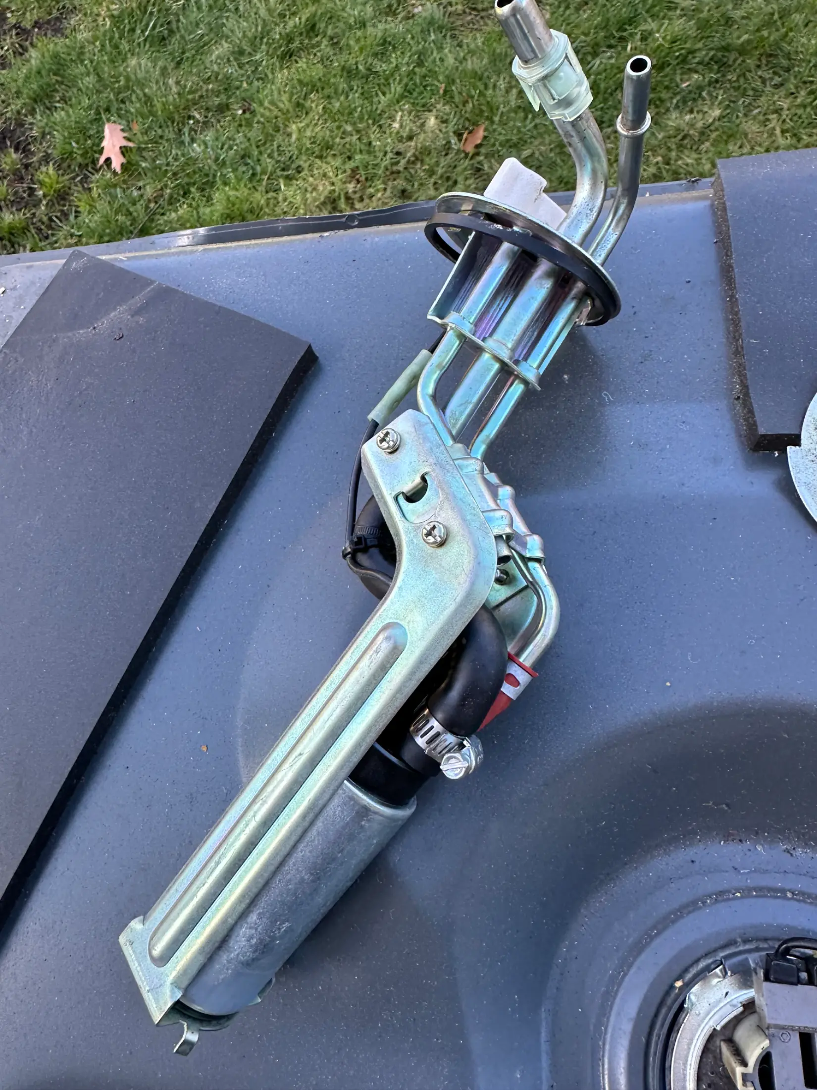

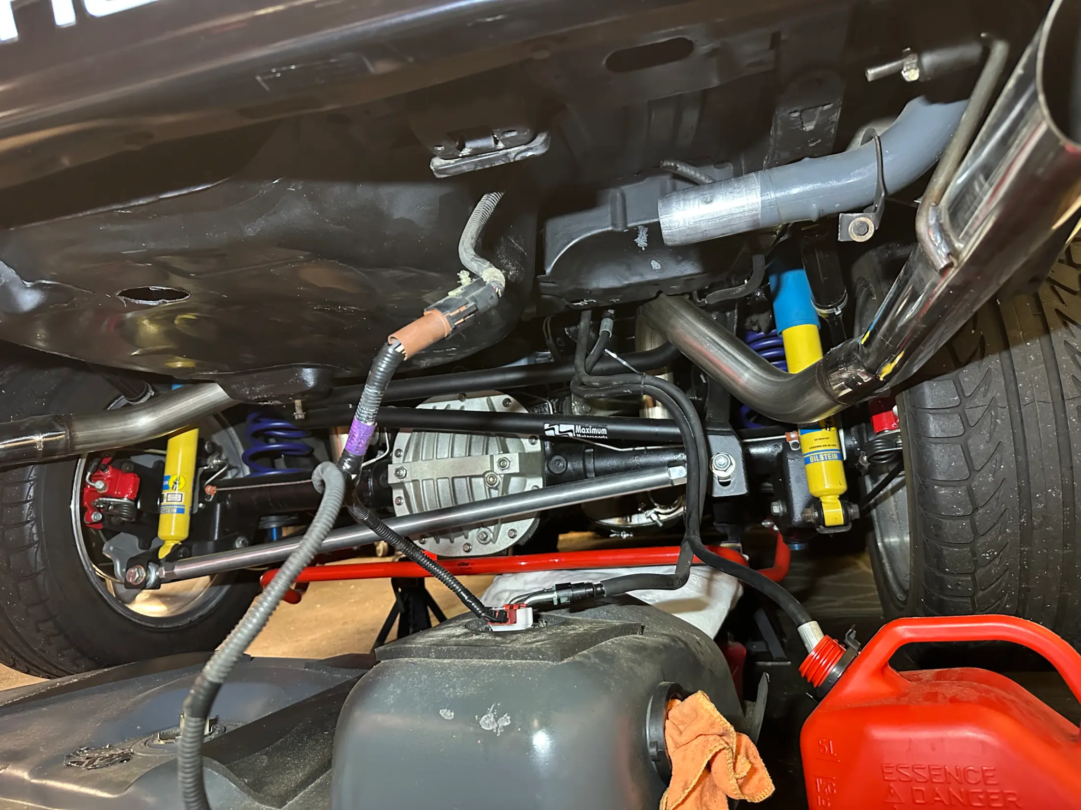

Siphoned off about 8-9 gallons and dropped the tank.
No rust inside.
Pump looked fine. No split s-hose from what I could see

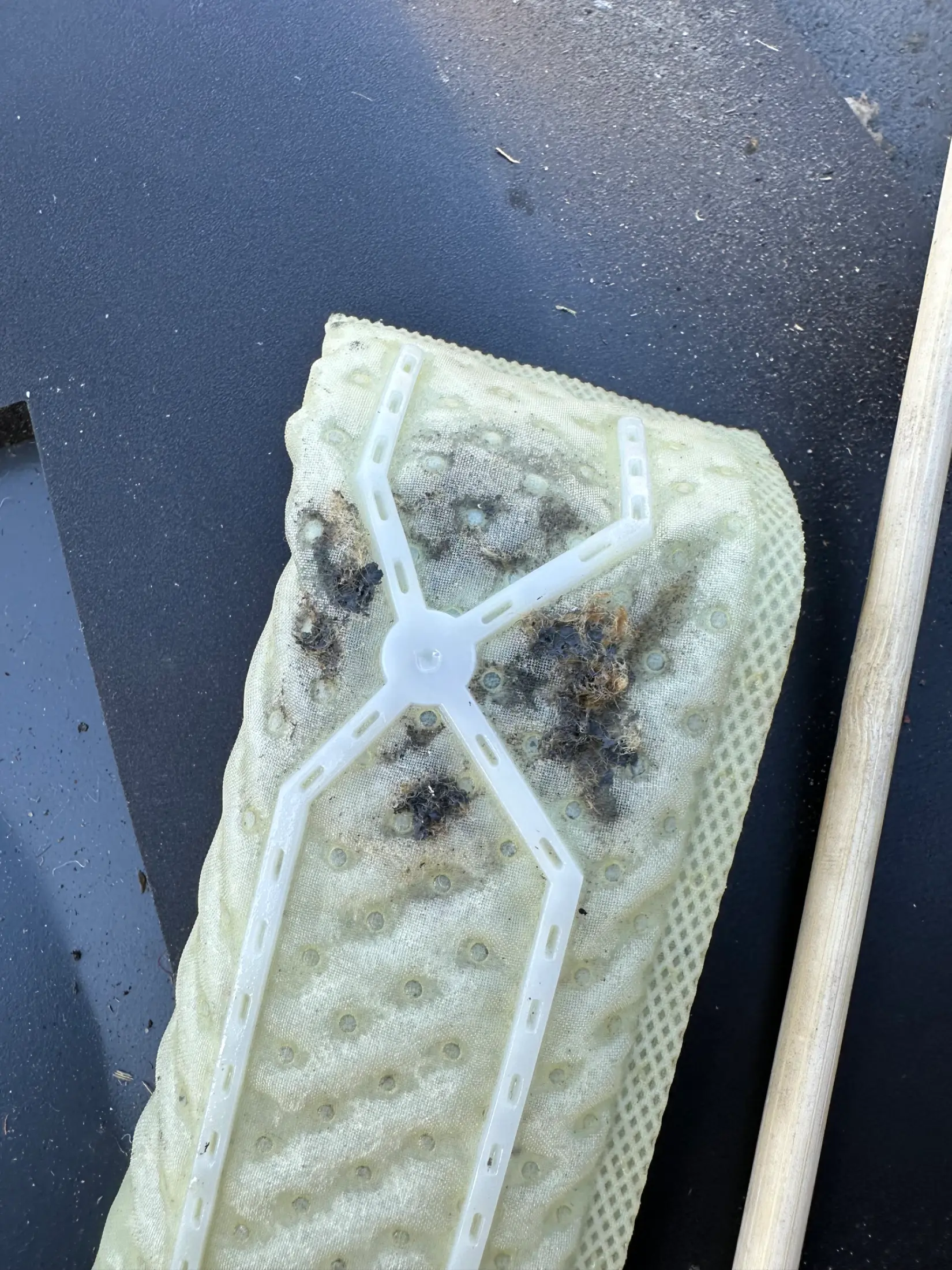

This was the bottom of the filler sock. Would this be enough to do it?

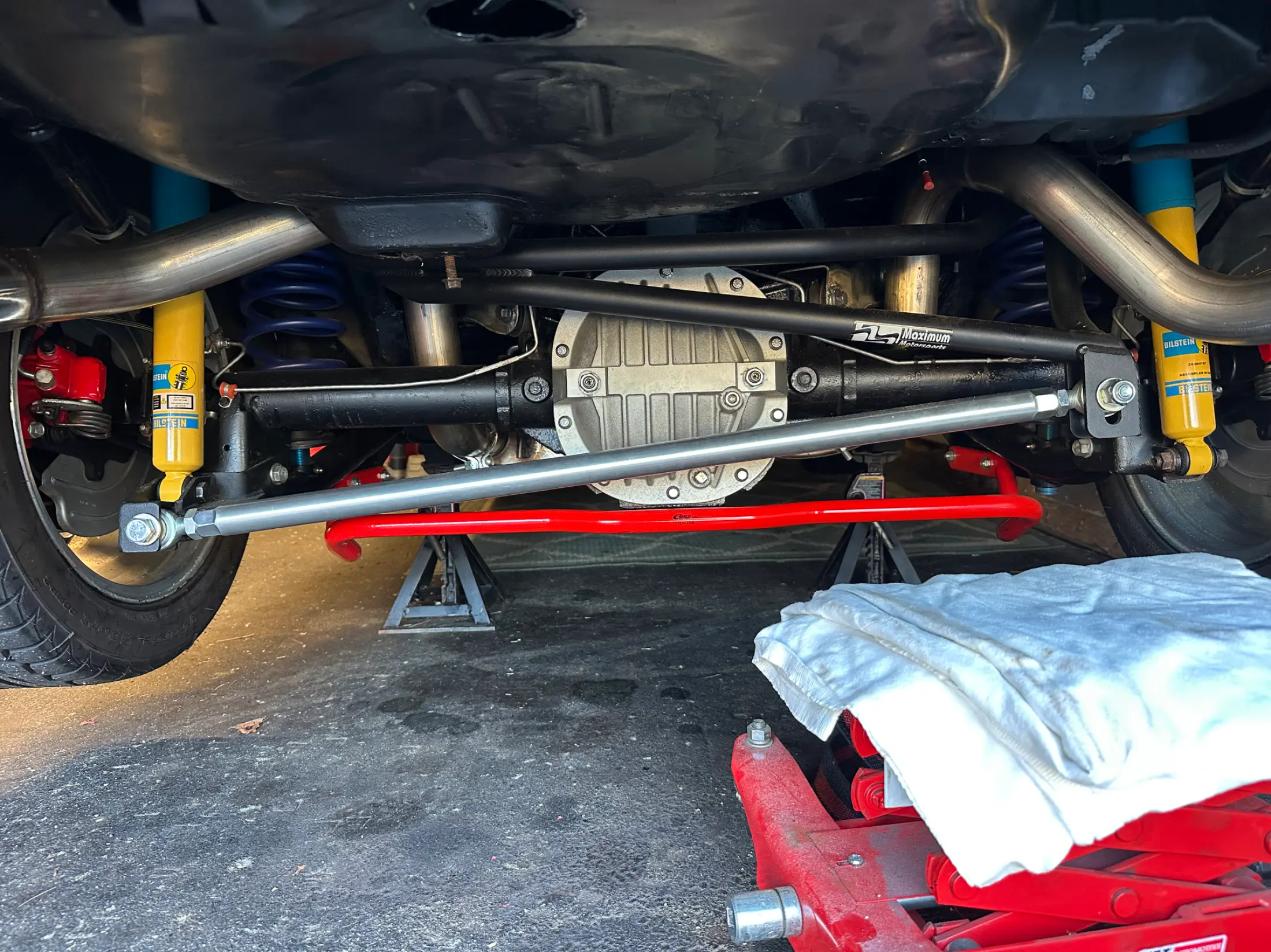

How bout that rear suspension?
Btw harbor freight trans jack also works very well for gas tanks.

I guess if you wanted to know the answer to that, you'd have to flow test it with and without the sock. But, I'm sorry that there's no clear Smoking Gun. Kind of sucks to play guessing games when a pump is expensive. I like having spare parts on the shelf for stuff like this. I could swap my known good pump and see if it cleared things up. If interested, I'd send it to you and you can give it a shot. My fuel system box is pump, regulator, injectors you have pretty much everything except the rails, lines, and filter at that point.

Relatively new. 8 years?
i have no idea what that crud stuck to the bottom of the sock is from.

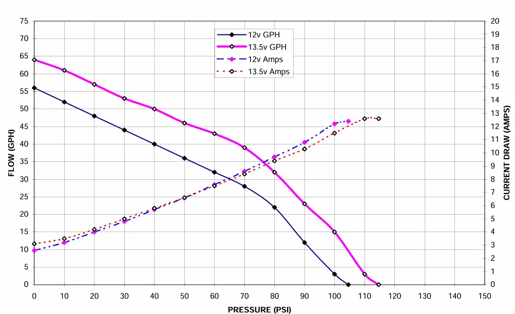

So did a fuel flow test. Hooked everything back up except the return and stuck that into a gallon gas can.
Idea was to run the system at 12v and calculate how much flow flow I have in 60 seconds and compare to this chart.
https://www.tanksinc.com/pdf/2_series_fuel_pump.pdf
So my test was 12v at 44psi. I got just about 1/2 gallon in 60 seconds.
According to this chart I should be around 0.66-0.7 gallons after 60 seconds. I got 0.5ish.
I need to check voltage under load, but it's looking like this might be a pump issue.
