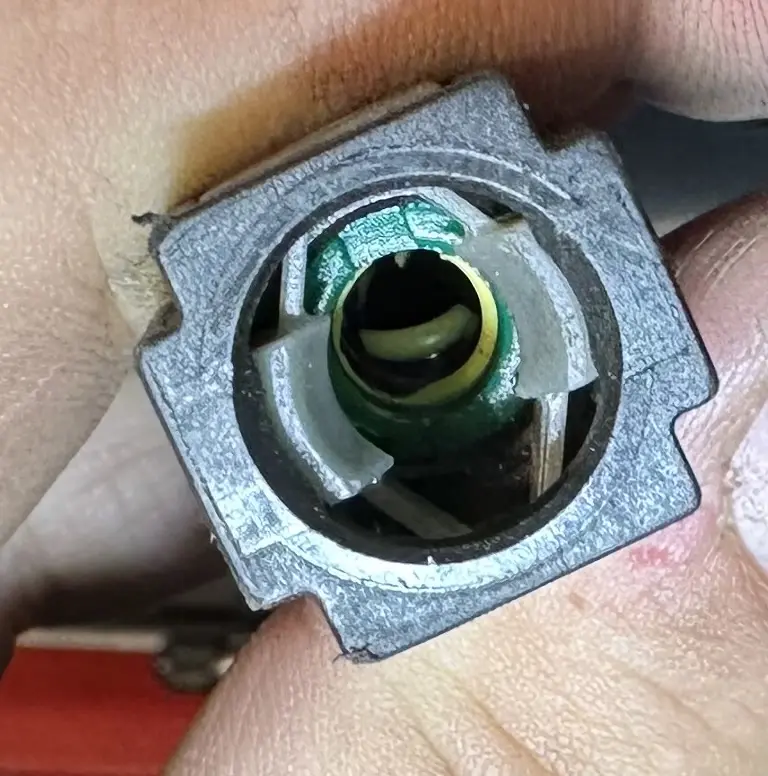

I started working on voltage testing. With the pump disconnected I get battery voltage at the plug. Was hooking up the lines for the return and it went going on right. Of course I forced it and buggered up the seal
So $64 for a new one incoming. The feed line is original so might be a good idea to just replace both.

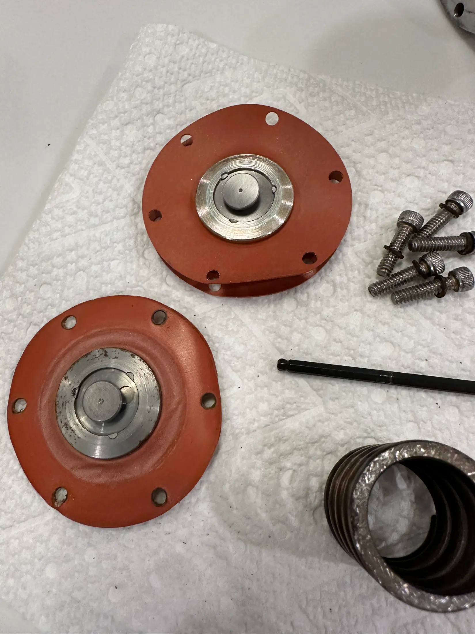

One small update. Now diaphragm for the Kirban arrived. Switched that out and reinstalled it. So engine bay is all buttoned up now.
