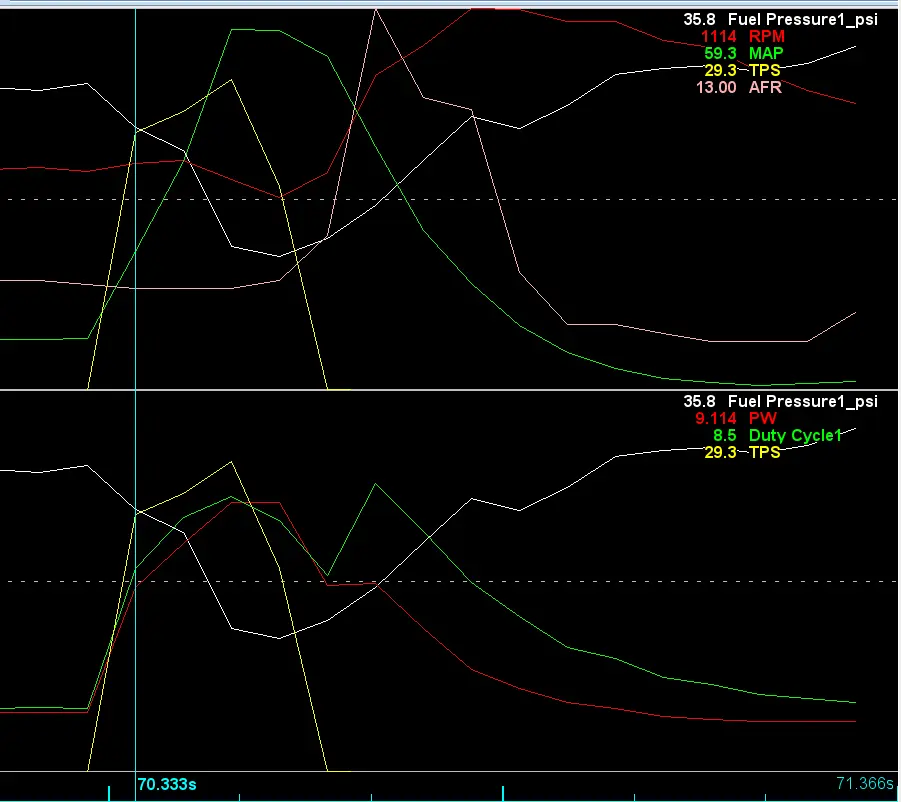

Swapped the pump. Fired it up.
No dice. DIdn't make a difference. Same exact thing. I played with it a little bit but essentially I got the same darn numbers. Any sort of blip on the throttle and pressure drops.
Not sure what else it could be. At this point it could be a blockage. It would have to be ahead of the pressure gauge, as a blockage after that wouldn't register the pressure drop I assume. SO i need to blow out the main feed line from the fuel filter to the soft line connect on the pass side. I can't rule out debris in the lines. WHen i rebuilt the engine I stuffed some rubber plugs inthe lines. I can't guarantee all of it came out. It's also possible whatever debris was there jammed itself in the hard line with the pressure port just ahead of it.
Need to stop and think about this a bit more....
There are physical symptoms. The engine stumbles when I blip it.
Blue line is where i stab the gas. Pressure drops off, engine rpm drops, AFR goes to 19 shortly after. EVery time i blip the throttle i get the stumble.

Holy cow... That sucks. At this point, I'd be inclined to buy rubber hose and bypass the fuel lines to recheck that everything else is fine, and that the part of the line you're bypassing contains the crimp or blockage.
Starting to make me wonder if it could be more than one part.

Are you sure there arent two issues here? The FP dropping is an issue to be sure, but for the blip, is the accel enrich set up right? That would cause an instant lean and stumble condition.
