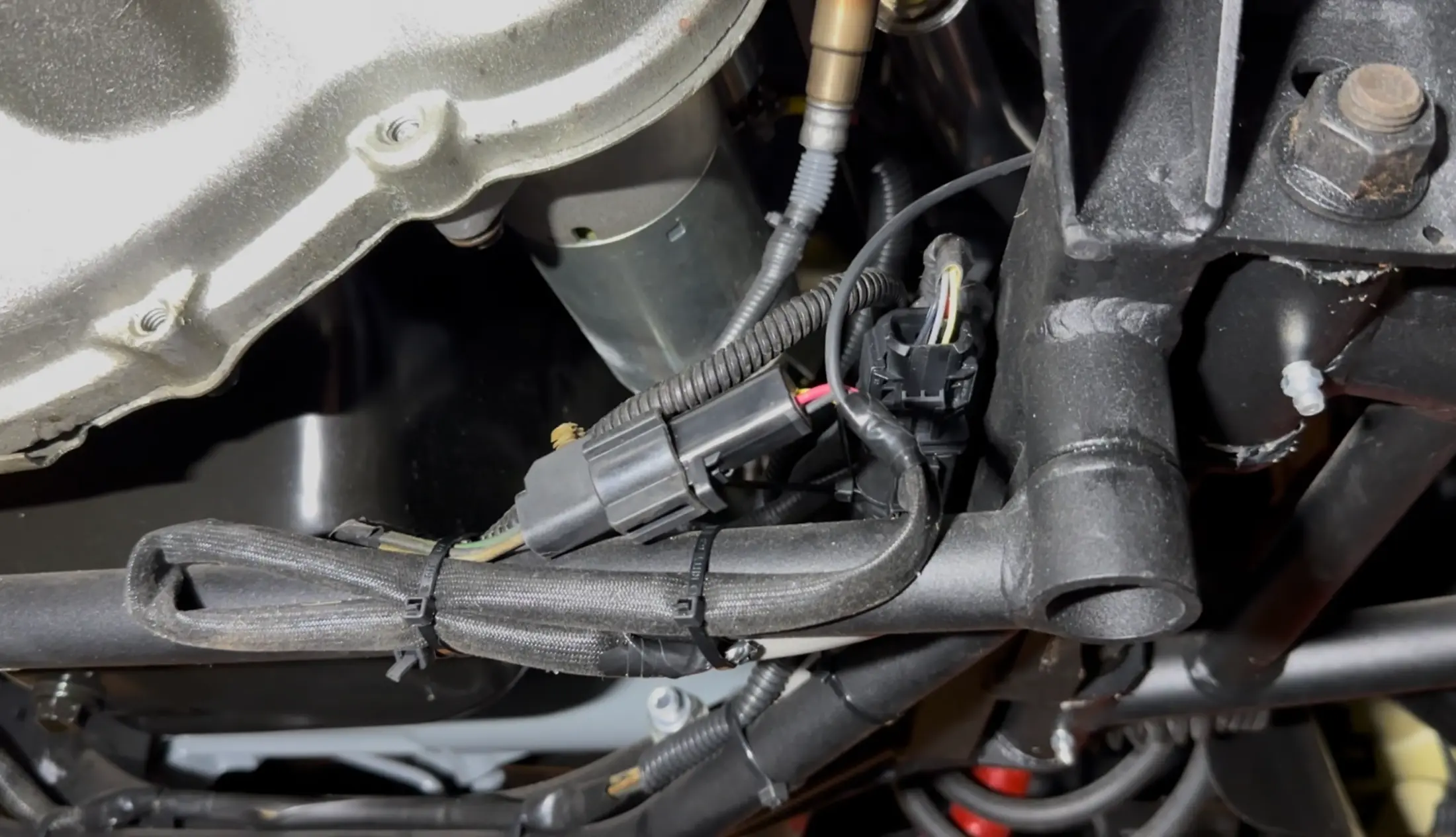

And that’s it. Tape your harness up and now the fun part of finding somewhere to mount it. The O2 sensors extension harness is the plug to the right side of the pin. Under the black sleeve are my crimps. Grey wire is to the wideband controller. The black wire coming out of the plug to the right is the O2 heater ground. This is the wire that connects to the white wire in the above diagram. I just left it long. Once everything is mounted, i cut and crimped on a lug connector and grounded it to the body in a safe/clean spot.
I ended up mounting mine to the K-member on the inside edge. It should be low enough away from engine and exhaust but high enough to not get damaged from road debris. I don't drive in the rain.
I used zip ties for now just to get up and running but likely will come back with a more secure means of mounting this.

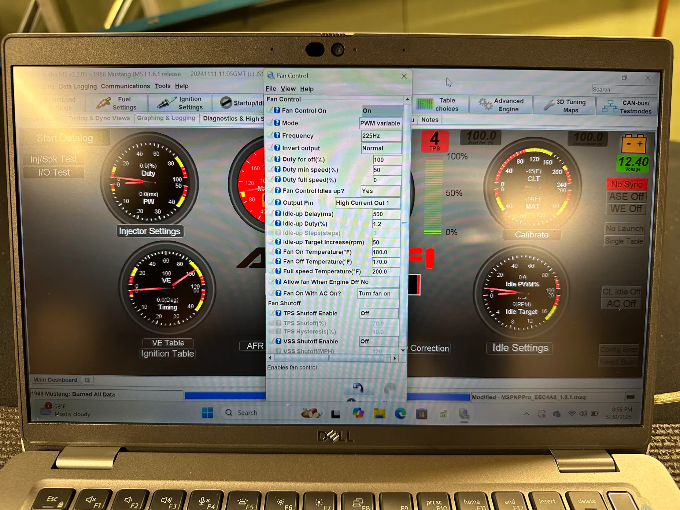

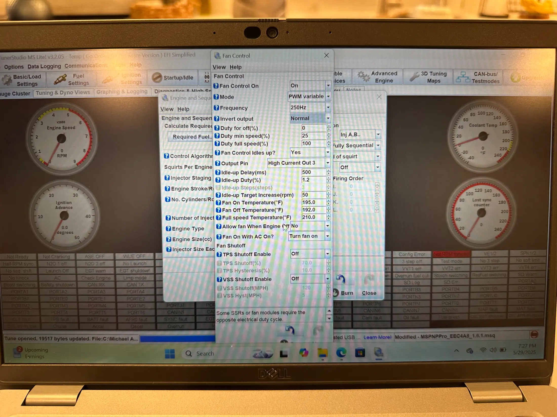

Ok plugging away. The website says this is 1 hour install time. I call BS. Spent an hour just trying to get the damn ECU to talk to my laptop. This install is a full Saturday start to finish if you did it in one shot.
But I got it. Registered my tunerstudio to get the full version with autotune. Updated the firmware on the ECU and loaded the base tune.
On startup my PWM fan controller ran the fan up to full speed, so that was the first thing to address. Set the output to pin L (high current output 1) which is where I connected the control wire, and added a few parameters to command it off and it’s done.
Stopped for the night. Still a few things to set up before first crank

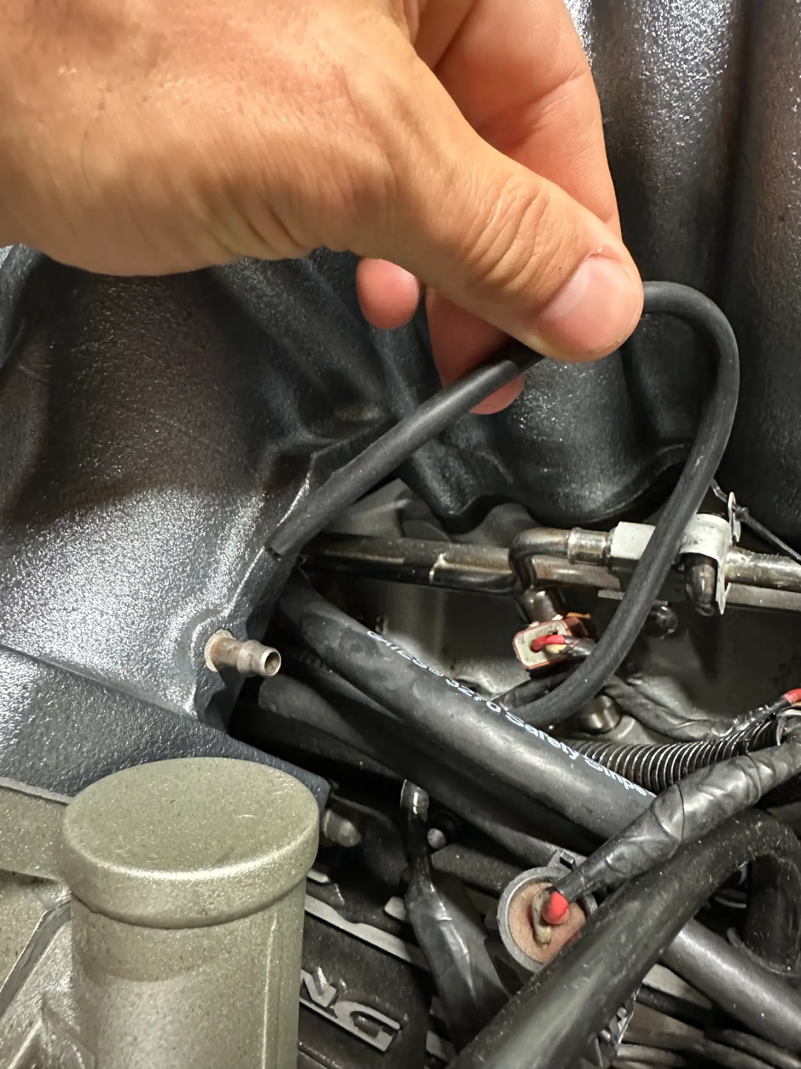

Finished the setup. Was all set to do a first start until I noticed I never hooked the MAP sensor vac line up.
The tubing size is a little smaller than this port, so I need to find an adapter to connect. So slight delay while I sort this
