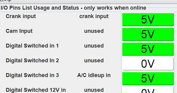

Digging through the manual. Pin 10 on the 60 pin is the AC status pin. Looks like it corresponds to a Jumper 2
Problem is this is not mentioned in the install instructions so i likelly didn't touch it. Will need to dig around a bit more because I don't want to pull the ECU out again. I just buttoned it all up.

More digging. FOund the input, and I can see it's getting a signal. 5V when no AC demand. Drops to 0V when i call for AC.
Means a setting is not right somewhere.....gotta find it
