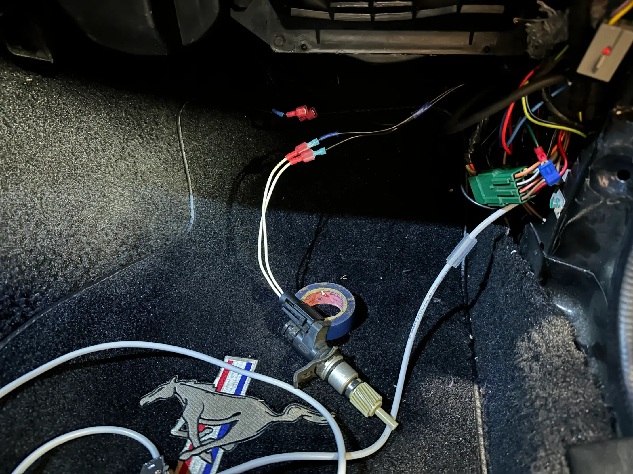

Chased the VSS issue down. Ended up cutting the two wires to add some quick disconnects. Plugged in a spare tps and spun by hand and the speedometer function worked.
Plugged the wires back like they were and disconnected the 60pin. Put a voltmeter in on pin 3 and 5 and set meter on AC voltage. Jacked up rear and spun tires and saw voltage fluctuation.
So something is coming from my VSS, but for some reason the MS doesn’t pick that one up, but picks up my spare unit. I have verified that it reads no matter what polarity.
So…guess next logical thing to do is jack up car and plug the spare unit in under the car and test it. If it works….i swap the VSS.

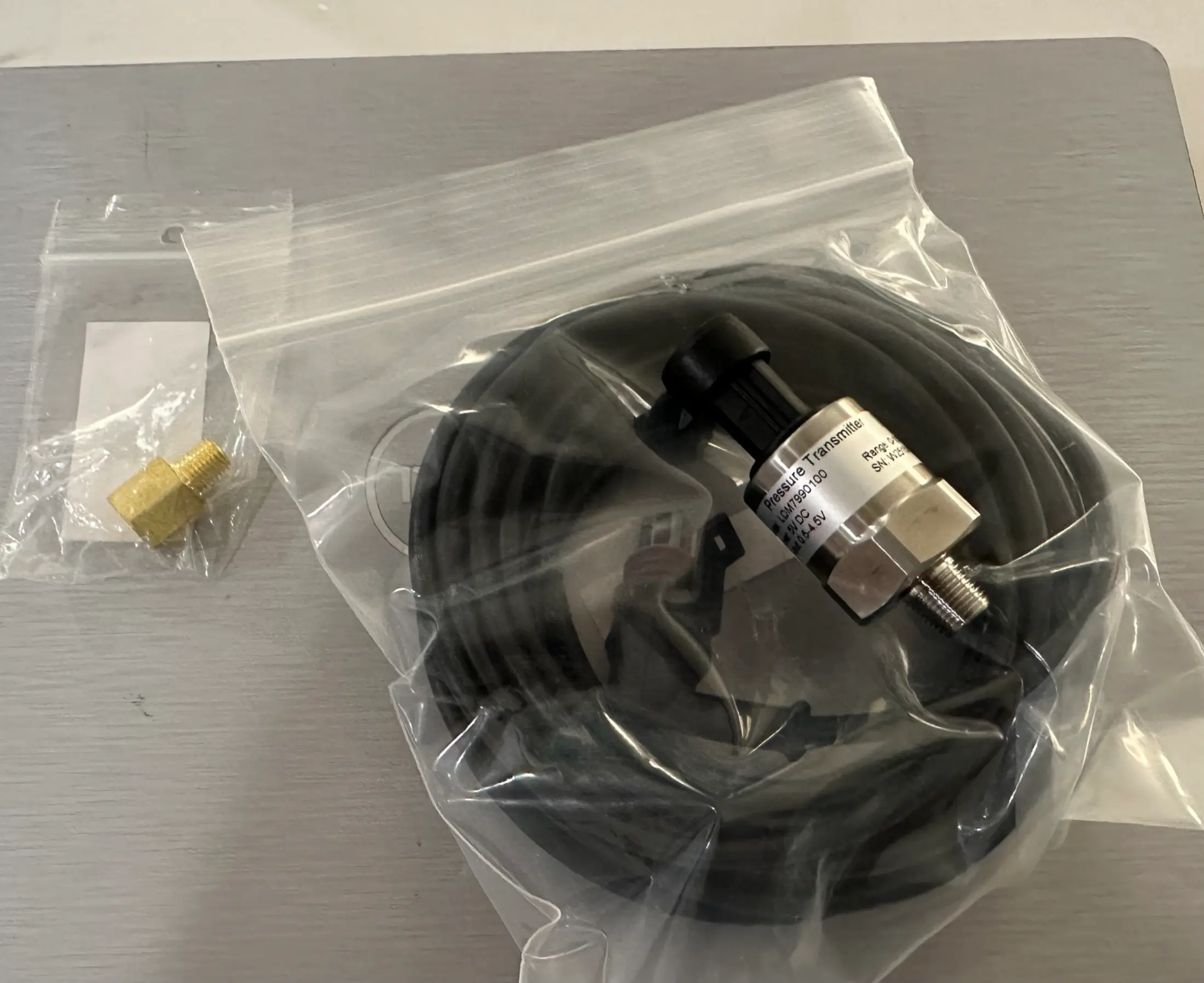

Also…picked up a fuel pressure sensor. So will need to wire this in.

Got under the car. Unplugged the VSS from the one in there and plugged in the spare. Fired up TS and did not see any signal display.
Gotta be a wiring issue in the car then. My guess where I tapped the wires in the driver's kick panel. No time to dig into that today

So, you're seeing it on the ac volt meter but not at the MS? I dunno. I'm back to thinking it might be the square vs sine wave. Maybe I'm dumb, but how can you test this? Does the MS manual tell you explicitly that it accepts and analog or sine wave?
FIxed it. Traced out the wiring. SOmewhere i had a bad connection. Remember, i added these VSS wired because i did a SD -> MA conversion before and VSS needed to go to the ECU.
ANyway, traced and ohmed out all my wiring and found the culprit. Now i have a speed reading.
I might need to make some adjustments.....

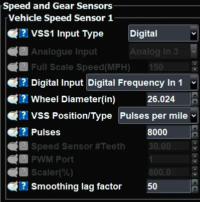

ANyway, trying to sort through the MS settings and it looks like i have this right. Ford VSS work at 8000 pulses per mile. I must have something wrong somewhere in the settings.
FOund this good calculator to help try and adjust it, but even it says 8000 pulses/mile gets me in the ballpark at least

I just did math based on taking the raw Hz reading from the VSS and doing some math with the reported (incorrect) speed to figure it was reading about 2.2 hz per MPH. So a little more math and I have an adjusted pulses per mile of 39,680. We will test at a later date.
I don't quite understand why this is however when everyone else uses 8000 pulses

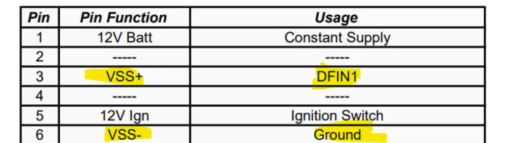

Well I think i figured out the VSS issue. Looks like it's a goof on my part in terms of how I set it up in TS and burned it to the car. I had 8000 pulses set...but I never sent that to the ECU. I had 2 pulses per mile on the ECU because I was trying to verify the VSS worked by spinning it with my fingers.
