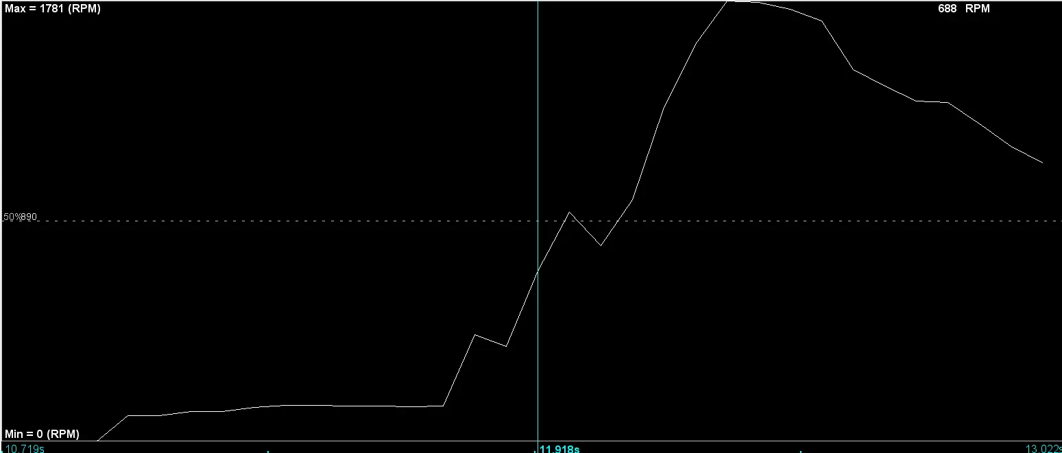

Got to test out my changes. Looks like i'm on the right path.
The pre changes start. This is the plot of RPM. The bump up to the left if when i start cranking at about 300RPM and then the big jump is when it starts. You can see it dances around a bit on the way up.
After the change. Removed some fuel from cranking pulse, raised the crank/idle RPM threshhold, and added a tiny bit of fuel to the cell it happens to kick over on. I can prob play with the After start enrichment to smooth out the transition down.
But honestly. i should stop. As soon as i change the injectors out I have to redo all this. Yeah, i'm learning...but rather than dial it in i should wait. TS should scale the fueling for the new injectors, but that's all assuming I set the injector settings correct for the 19's. I have published data for the 47's so this should be easy.
SO maybe I should just start pulling the top end off now anyway.

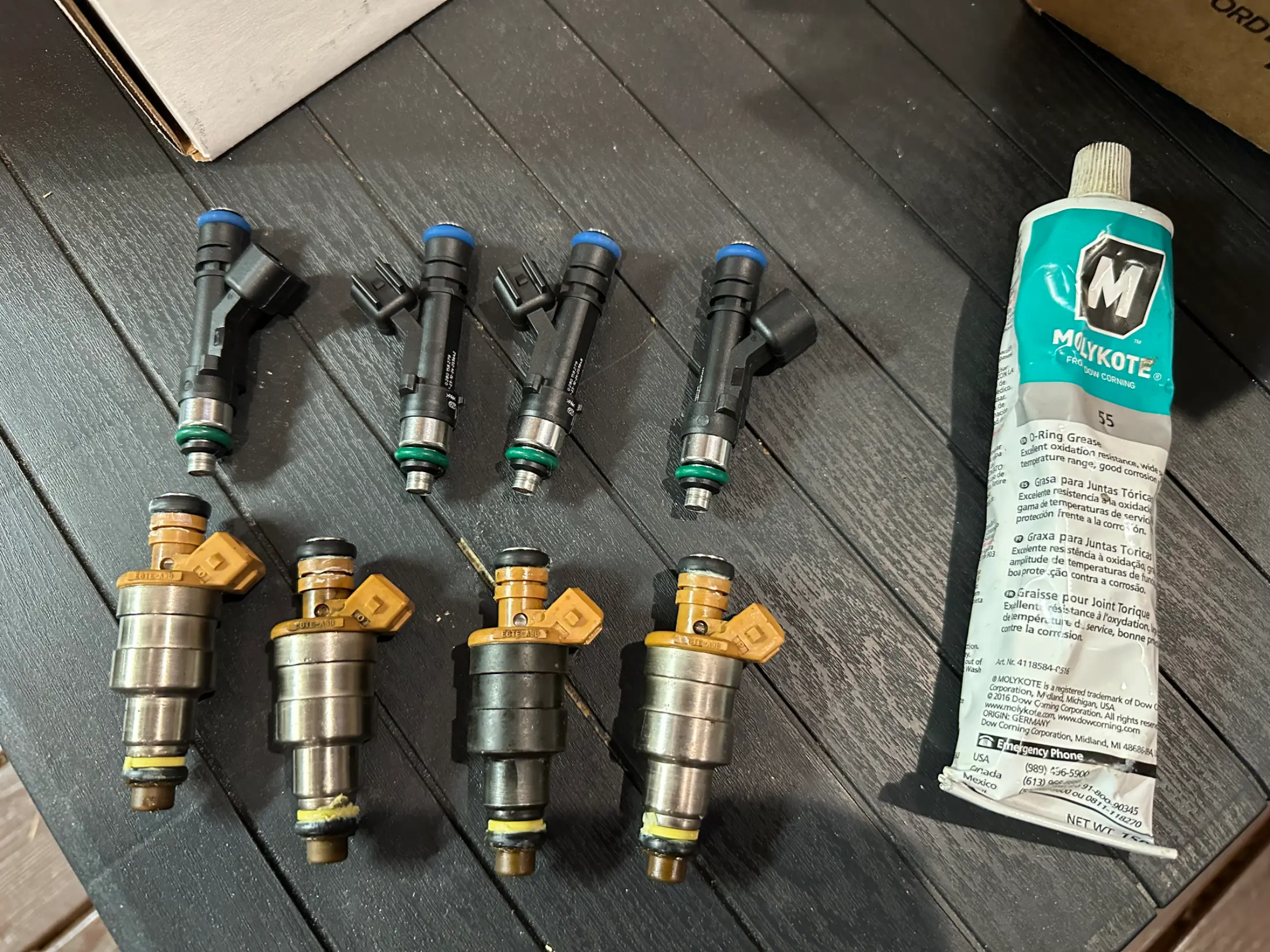

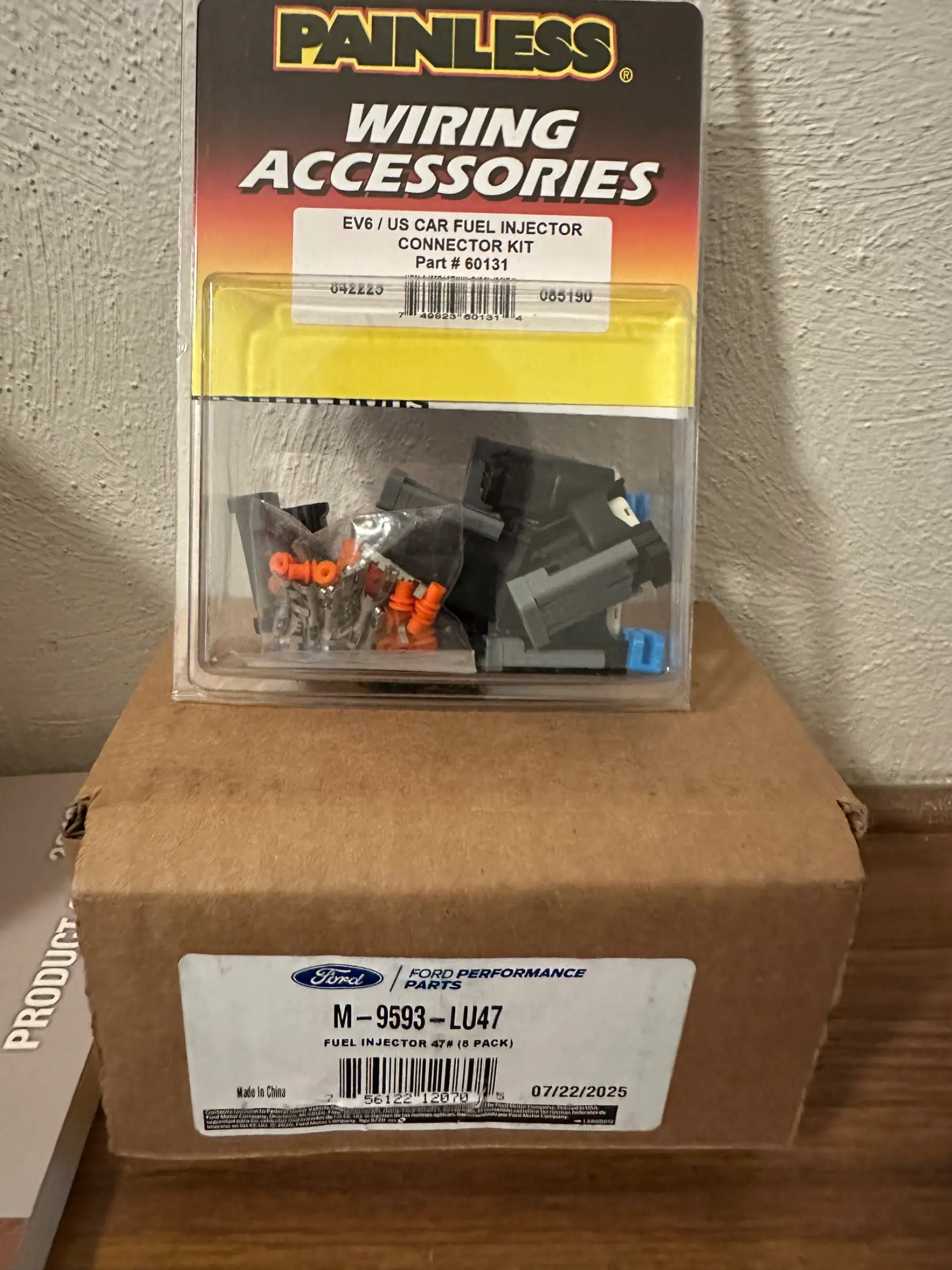

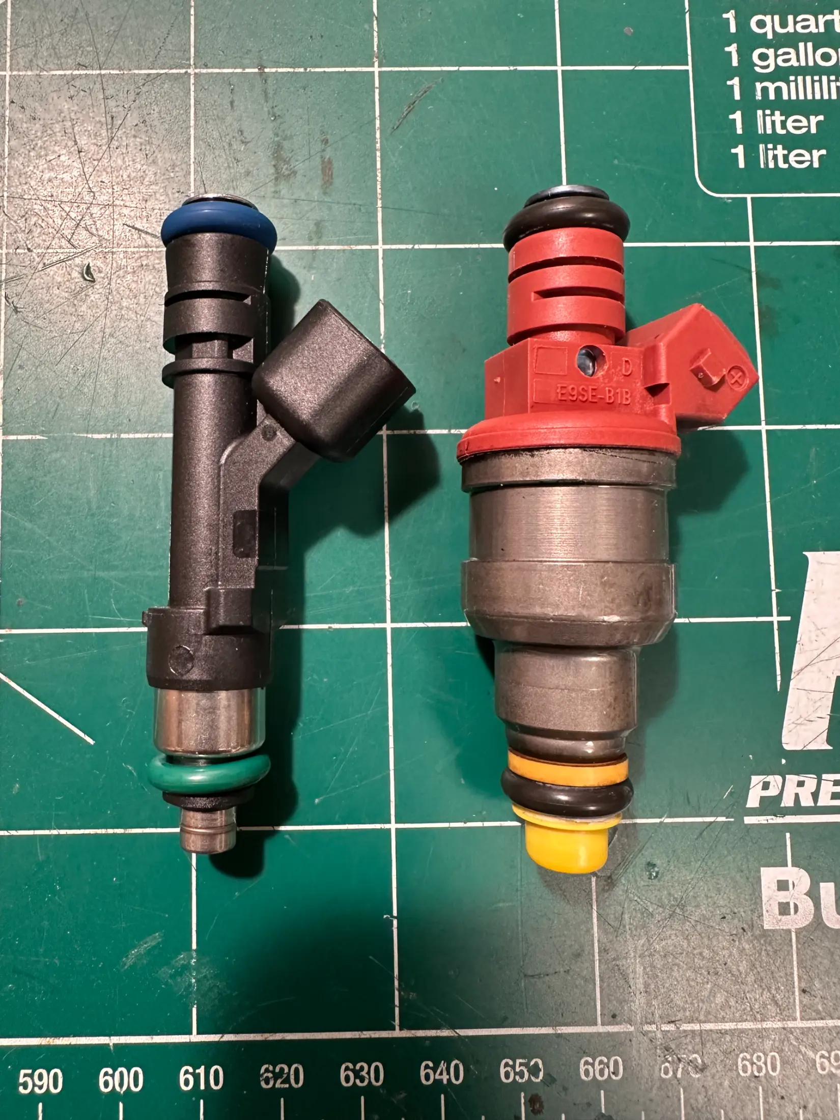

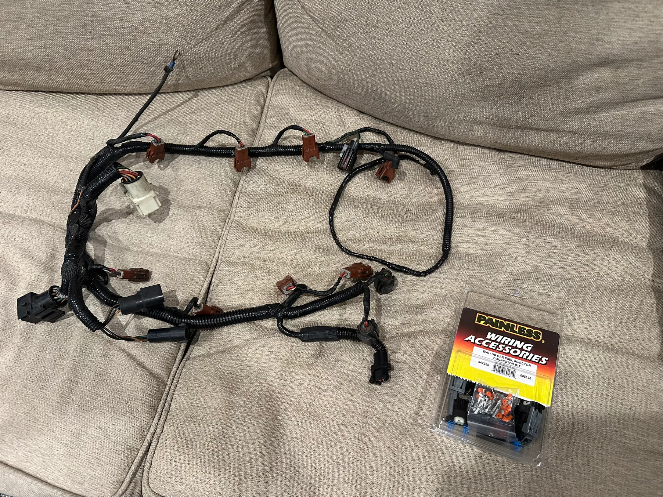

Injectors and connectors arrived
These new EV6s are skinny little things compated to the fat-bodied metal EV1s
Didn’t install yet. I figure when I take the fuel rail off, I should replace the end hoses. What size ID fuel injection hose is the right size for those? 5/16” or 3/8”

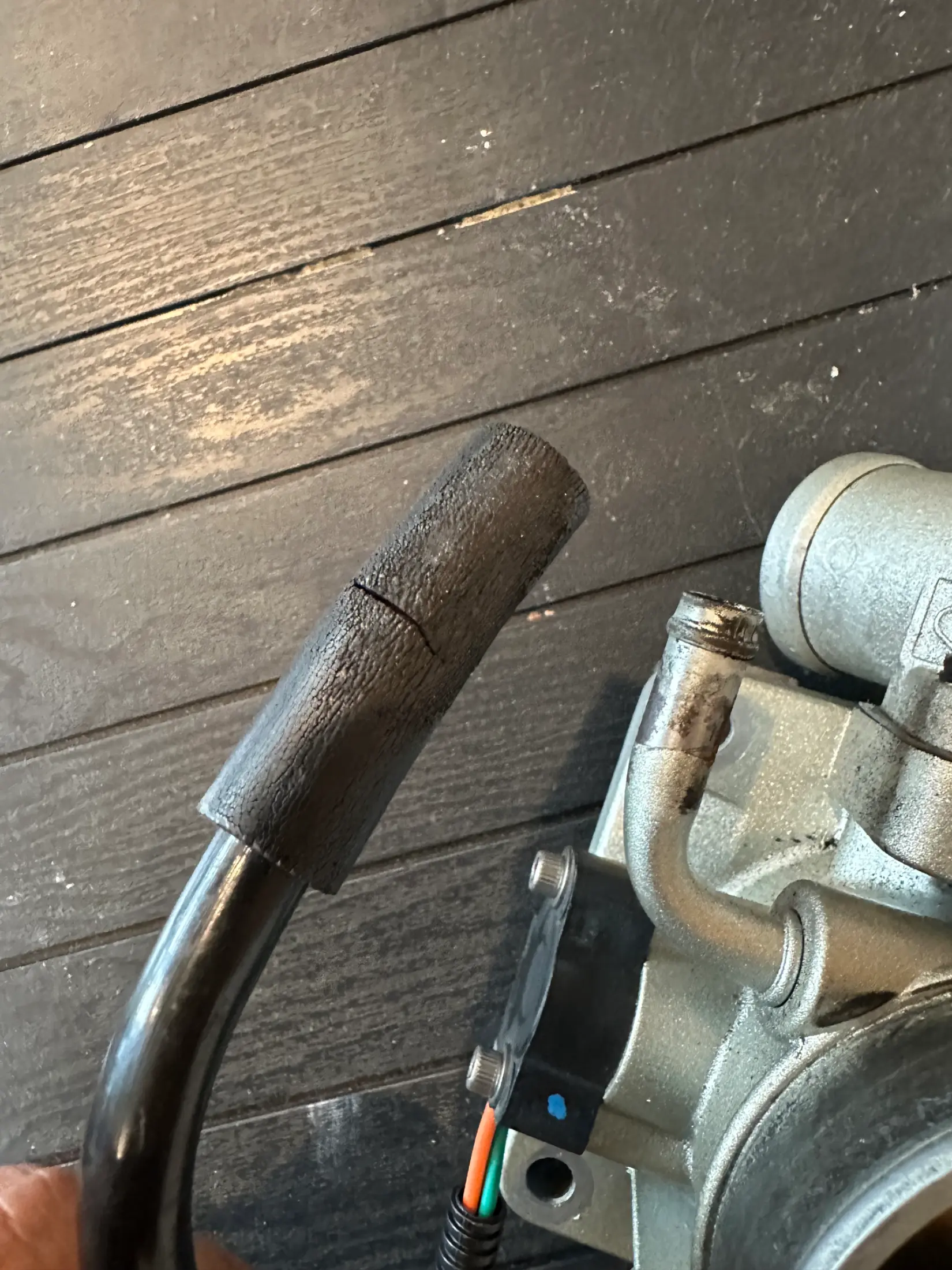

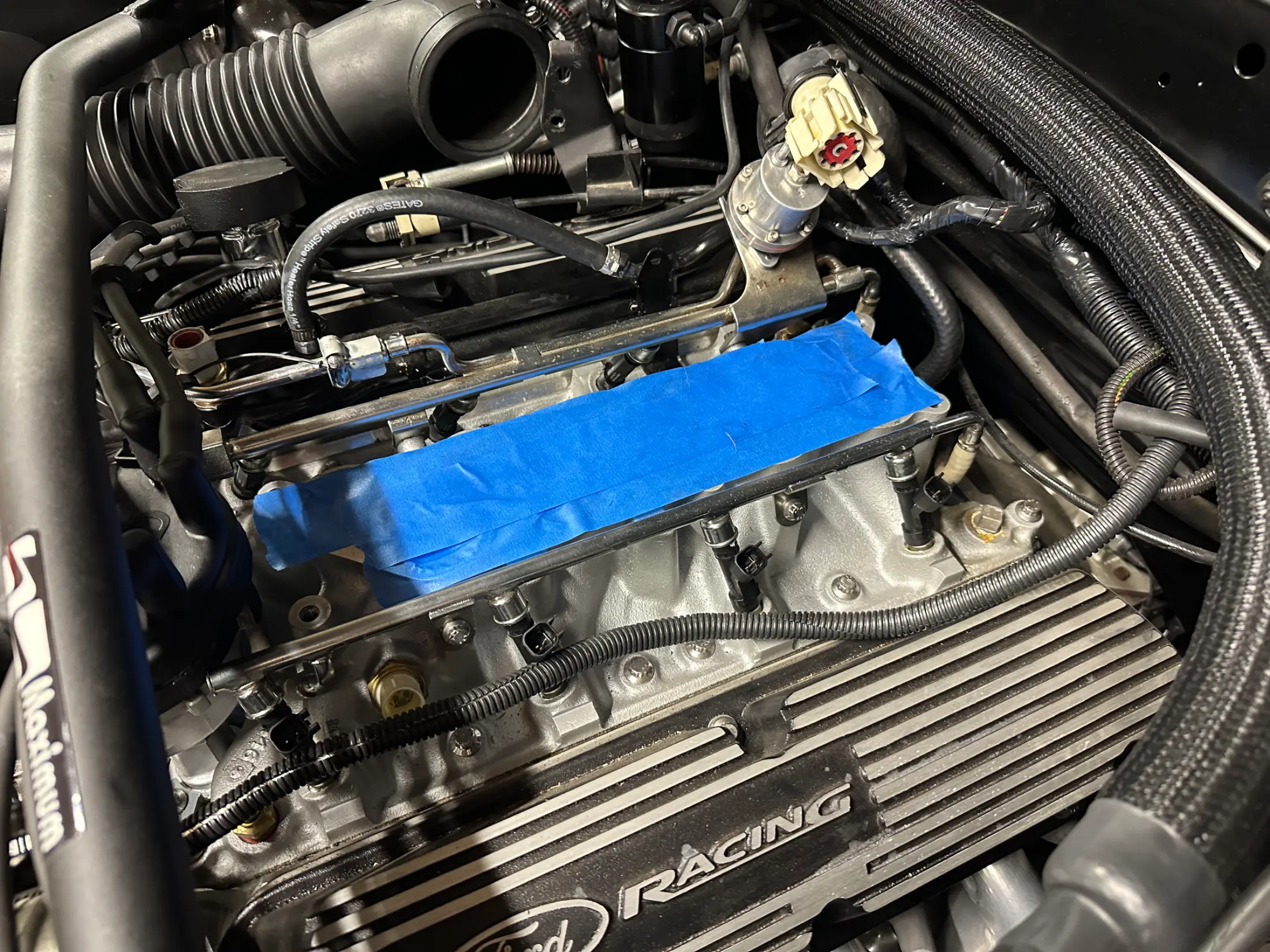

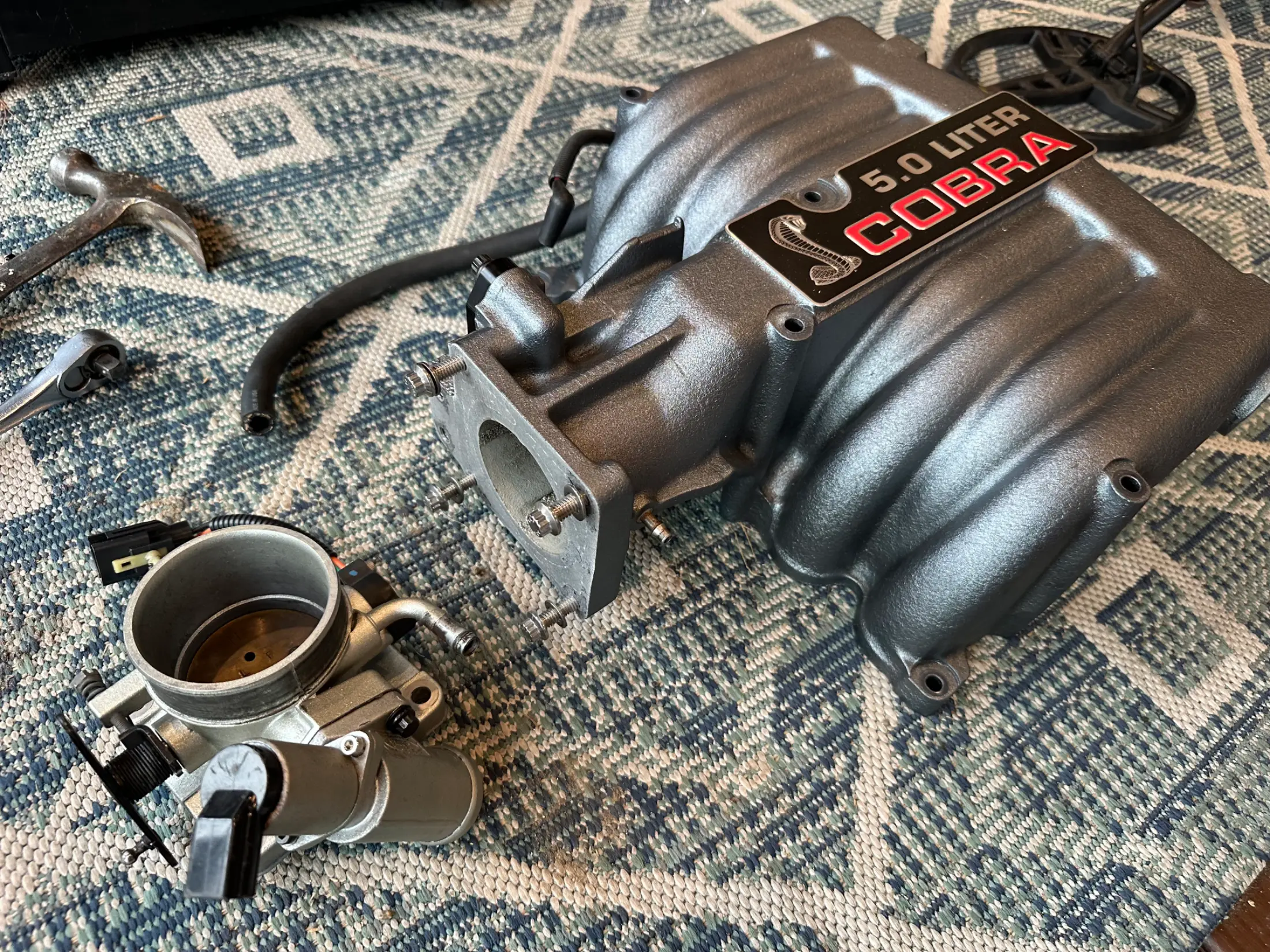

Intake off. Trying to judge my next move. Tackle the injectors and wiring…or pull a valve cover and check the rockers.
Pulled the old 65mm Explorer TB off. The gasket didn’t survive so need to order a new one of those.
Discovered this had dry rotted. So need to source a replacement or replace just the soft vac line

Injectors are in. Wasn’t too bad
Pulled the injector harness. Figure it would be easy to wire in the new injector plugs on my bench vs leaning over the car. I need to verify I have the right crimper first
Pulled the MAP sensor off while I was here. Don’t need the ford one as the MS has an internal one.
Going to pull the drivers VC next. That’s the easy one. Called it a night as I need to vent the garage for a bit due to the gas fumes from swapping the injectors.
Updated my Megasquirt tune for the next injectors and sent that to the car.
Hoping to fire it up next weekend

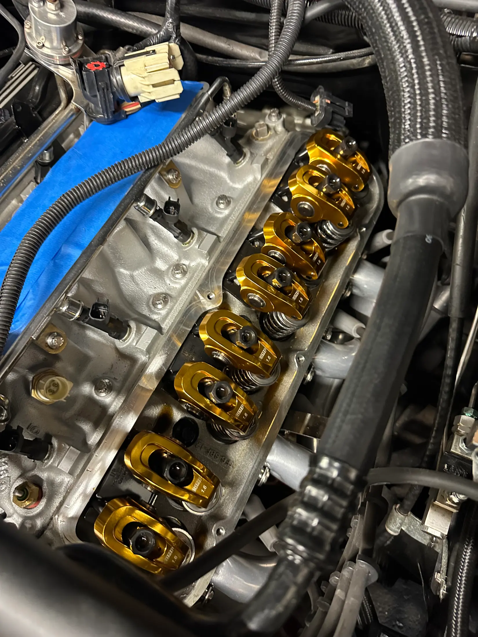

Those are the valve covers I like. Just not sure if they'll fit under stud mount rockers. You just pulling them to check things out? If so, and it's hydraulic and not making any concerning noise, I'd skip it. Maybe just check to make sure none of the bolts/studs have loosened since last time.
I have stud mount rockers under them.
When the engine is hot, i get a bit more of a sewing machine type noise from the rockers. I just want to give each one a wiggle now that the engine has had some run time and make sure they are all properly installed. It's a "while i'm here" sort of inspection.
Reactions: General karthief and FastDriver

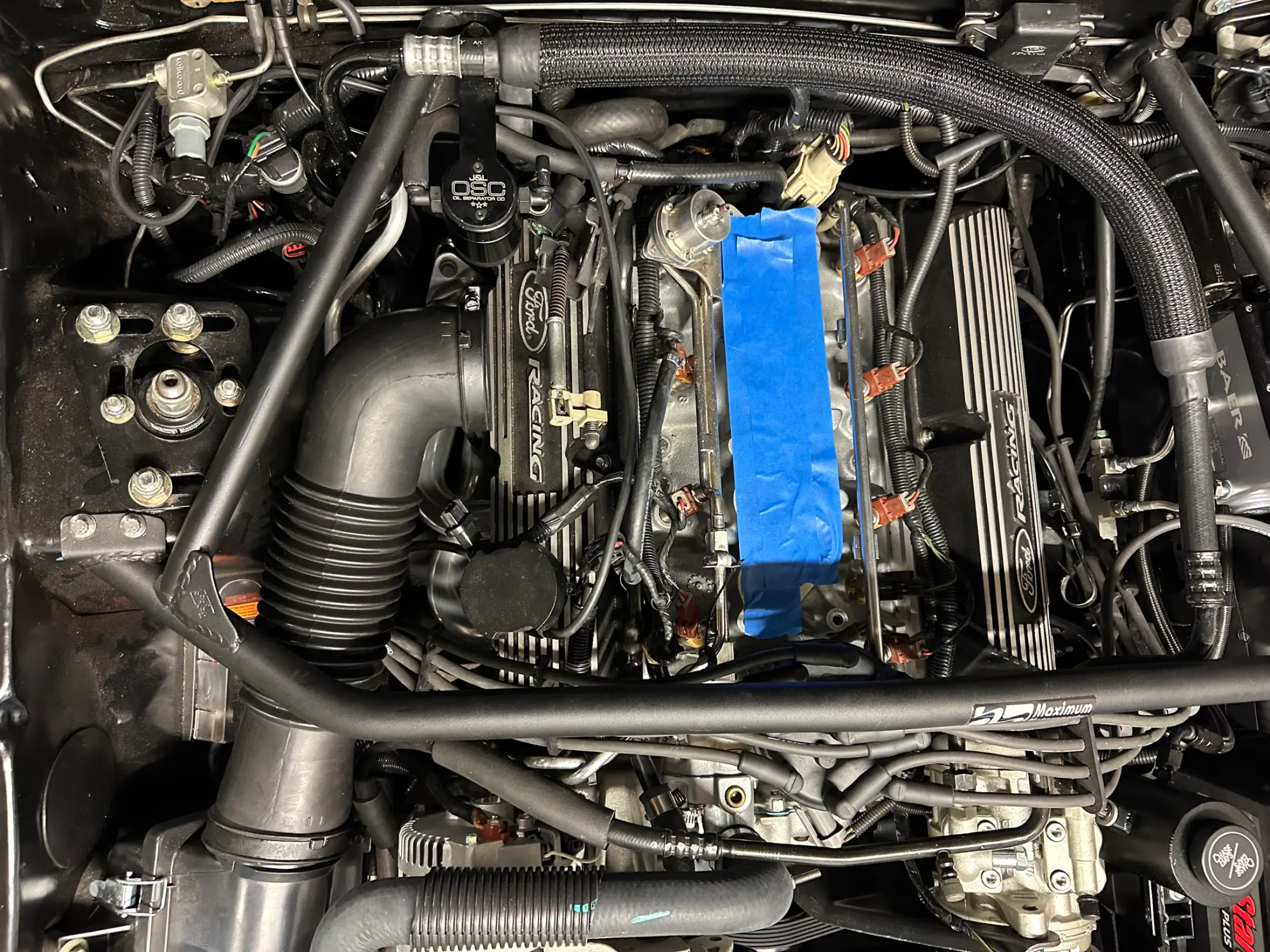

It’s a shame these get covered up.
Nothing obviously loose. A couple have a little side to side wiggle, but the pushrods spin and don’t have any up and down slop. Prob need to spin the motor over by hand and check.
