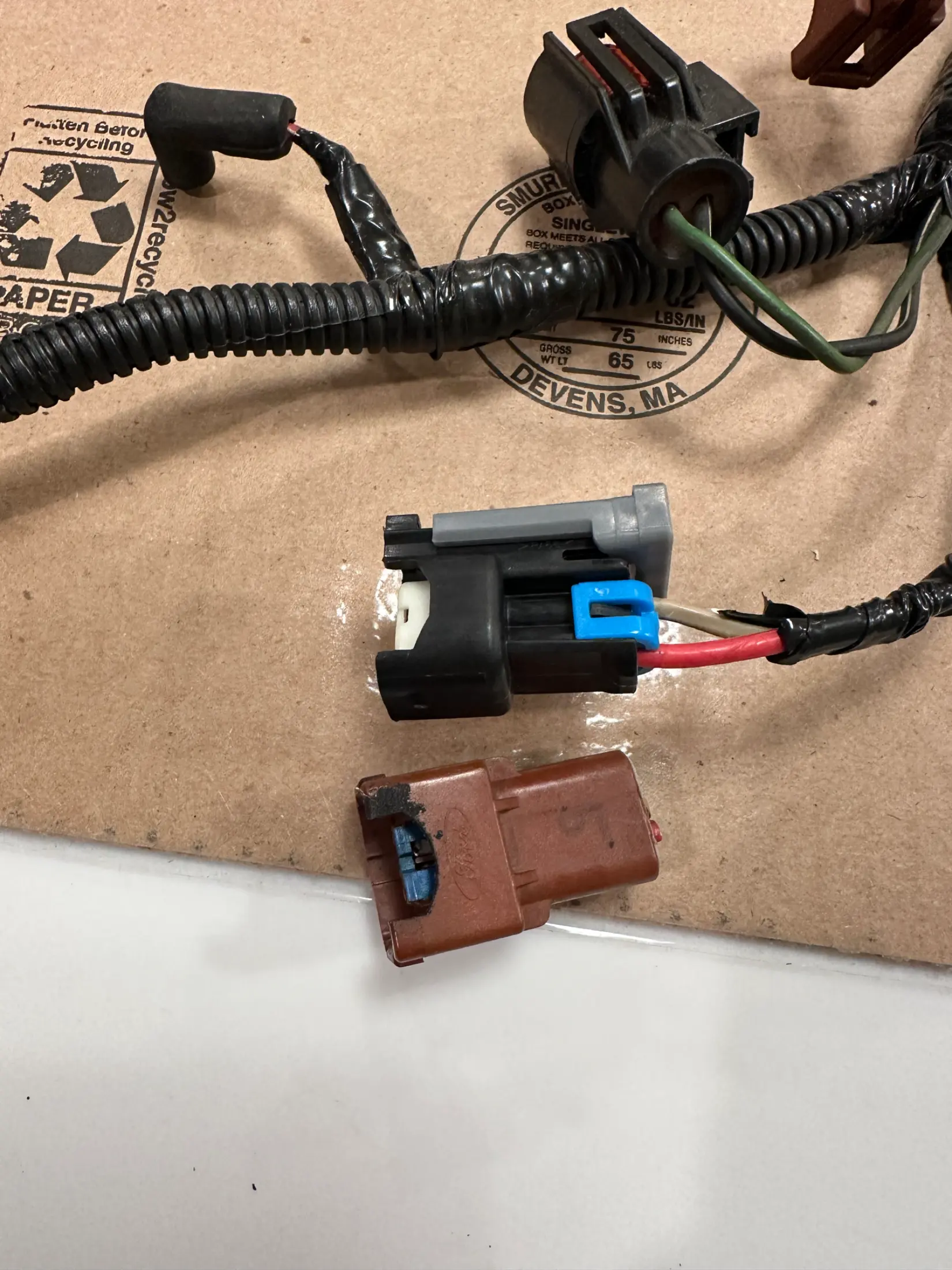

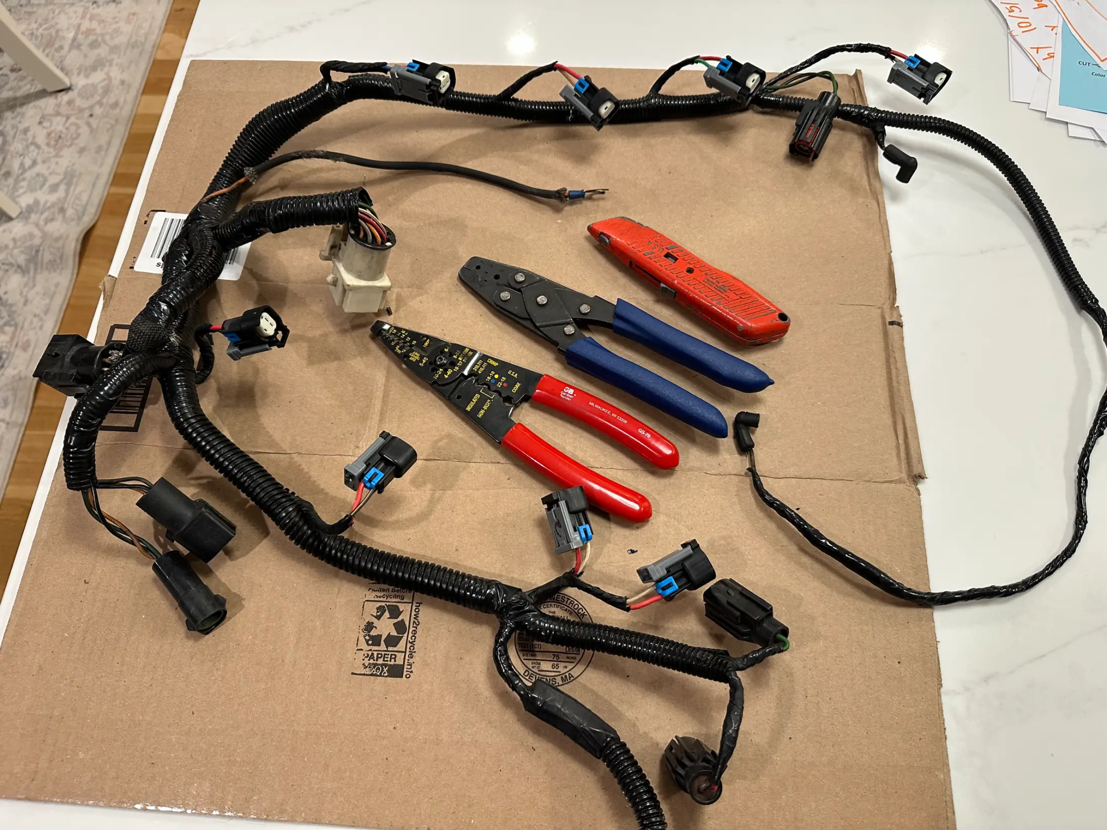

Injector harness rewired for the EV6 injectors

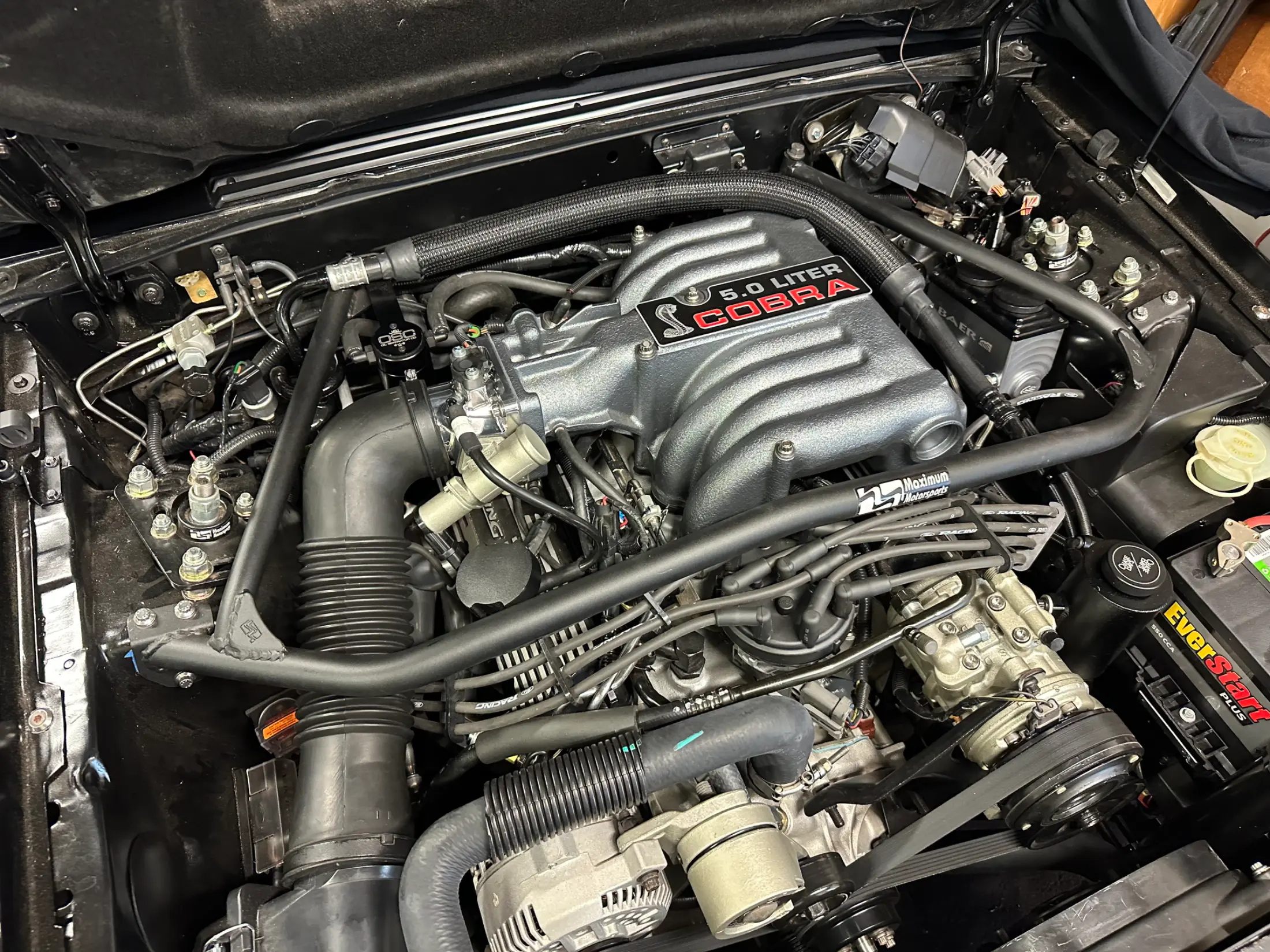

Adjusted the rockers a bit. Nothing really stood out and they seemed like they were all adjusted fine.
I need a polished IAC now
Back together. Adjusted the TPS and she fired up and idled same as before. Ok…now we can start dialing things in. I’m 99.9% sure this is the final configuration for this car. Unless I go coyote…

Is rewiring the harness required or do they also make little adapters?
They make adapters, but they are notorious for poor connections.
I already attributed my failed injector issue a few weeks back (lost one injector firing while on a drive) to a bad connection. Figured i'd just cut off the 30+ year old, tired connectors and go with fresh new tight connectors.

Solid, was just curious as sometime way later on down the road i'll probably have to do this.
