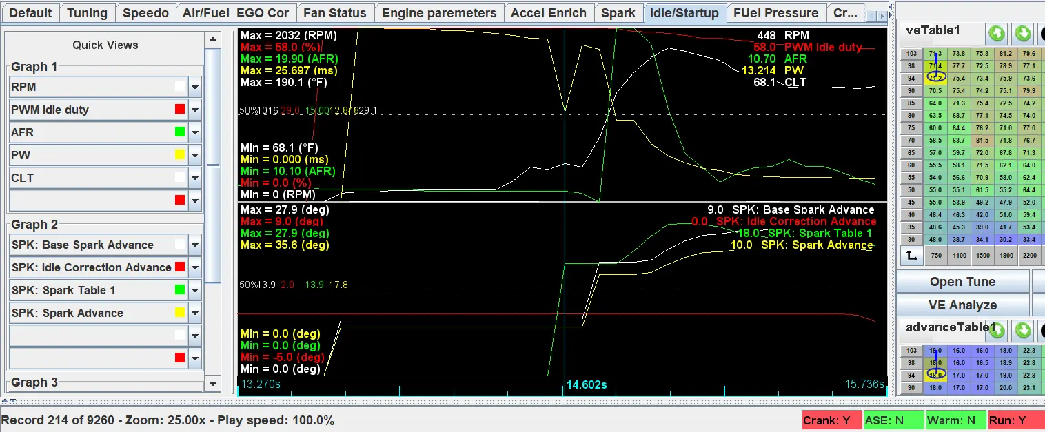

Right now i'm chasing this issue on my startup.
The little yellow dip on the top row is injector pulsewidth. RPM is the white curve in the top row. AFR is green and goes lean right after start. For some reason it drops out and I get a little stumble on startup before it catches. It's like my cranking pulse wants to go to normal VE a bit too early, and then goes back to crank.
What i'm trying to see is what is the trigger and/or what is this reacting to. Unfortunately I only get one cold start a day, so I need to think, make a change and try it and when it doesn't work I need to wait til the next day.
Right now i'm thinking my cranking taper is not long enough, but looking through the data it should go another 20 ignition cycles beyond this. I'll get it...eventually.

Even though it's 1 cold start, what does the next start look like if you shut down and recrank?
Crank taper is where my mind goes first, too. Without an MAF to measure air flow, can we look at what the IAC is doing (edit: I think I see it in red on top. Looks stable.) & the MAP? Dunno if the computer's pulling air and then PW to compensate. If you see something weird here, you can usually fix the IAC duty cycle at start up, which may prevent the computer from trying to do too much on startup.
There should be an afterstart enrichment table to play with based on CLT, but to your point, that changes gradually and doesn't explain a spike in either direction.
Another thing to look at might be injector voltages. If there's a dip, or even a subsequent voltage spike, maybe the EEC thinks the injectors can have less dead time than they actually do. I'm guessing you used published numbers for yours (30s was it?), but just don't want to overlook a possibility.
Other things come to mind... Air/fuel enrichment can come into play based on Delta TPS (accelerator pump) * Delta MAP (dealing with rapidly changing MAP, like boost). You might consider disabling these to see if you get a major change. They probably have adjustability by RPM.

another thought...
I remember you tweaking crank rpm. Is there a start or run rpm? A gap between states might confuse the computer.

crank RPM is when the ecu transitions from cranking fuel to WUE and ASE fuel combined with the normal VE table.
I made some changes to crank taper, and less cranking fuel and the next restart was better, but I have to wait another 24 hours for a full cold-restart again. I eliminated the dip but still think i'm too rich on restart. I want to try a much leaner tune fine.
I also need to work through hot start a bit. Steve has a really good video on ASE tuning here
View: https://youtu.be/b5xwmIMHyqU?si=NVgXzhaC5We6Griz
Like i said, car is much more drivable and stable, although probably not fully optimized yet as i haven't done any WOT 3rd and 4th gear pulls on a long stretch of road yet. But now i can dig into the finer details like dialing in my cold and hot starts and PID tuning idle a bit better to eliminate any surge tendency..which there is very little of already.

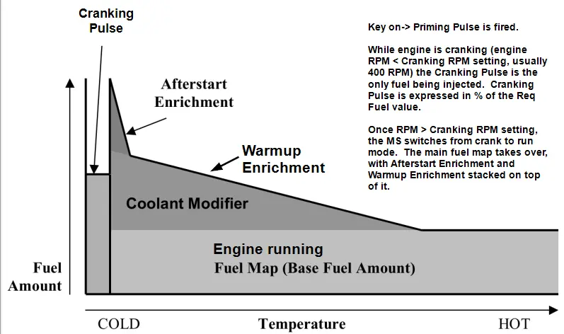

This graphic is gold with regards to the above video
Let me explain. When you start a cold engine, fuel may not immediately or efficiently atomize. It may pool in the boundary layer of air flowing near the intake/cylinder inlet walls. Because of this, you need extra fuel during cold start, and a little boost of it even during hot start.
Without it, you go lean. Do even if you nail your VE table perfectly, when you cold start or hot start, you tend to run lean. The point of WUE (warmup enrichment) and ASE (After start enrichment) is to add that extra fuel in the form of a multiplier on top of your VE table.
With megasquirt, you can control the amount of fuel, and the taper rate with ASE. WUE taper is controlled by coolant temp. The goal (as seen in steve's video) is to balance this out so that you provide just enough fuel to maintain proper AFR, and taper it off before you start going too rich due to no longer needing that additional fuel. SO you are adjusting your ASE % and your ASE taper rate by watching (or logging) the AFR and making adjustments.
Priming pulse and cranking pulse are also two different fuel modifiers. Priming pulse squirts fuel in prior to crank, and cranking pulse is your fuel added during the crank. You then set a crank RPM value as the transition between cranking fuel and when your VE, WUE and ASE take over...the big vertical jump in the above pic. In my case, i bumped it to 450RPM.
That's summing it up quickly. I spent a hour or so today doing what Steve did and just starting and restarting the car as it warmed up, and then let it cool down and did some starts in the 120-150 degree range. Essentially I watched the AFR and made my adjustments. If it lean spiked right after start, i adjusted the WUE and ASE as needed in that temp range. WHen it started with a good AFR, but then ran a bit rich, i would shorten the ASE taper a bit to bleed that extra fuel off quicker. Was cool to watch this happen. When i got my WUE and ASE right, car would start and settle in right at target AFR. As you watch, you can see it slowly richen up indicating I had to reduce the taper and wean the extra fuel off quicker. Really good feeling to know what changes you instantly need to make.

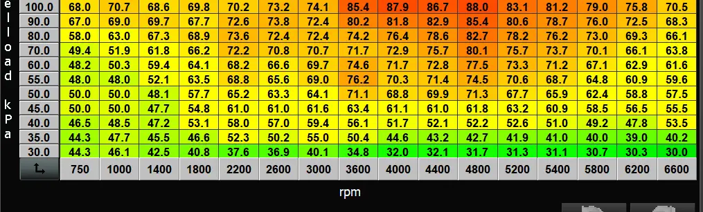

Here's how the VE table is shaping up.
Interesting observation is the VE dip right around 2300-2900 RPM. Might not have hit that part enough times in autotune so we will see how it shapes up. I need to do more work at the top left corner of the table. More WOT from a dead stop tuning. I avoided this for now to avoid spinning up the tires too much in cold temps. But this table is looking like 3500 is my peak TQ area and HP climbs to right around 5200RPM before dropping off.

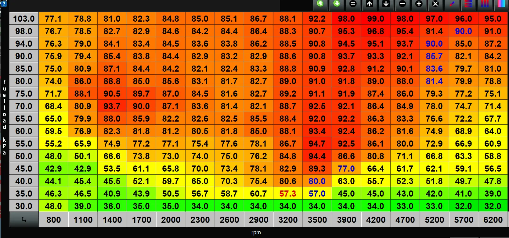

In comparison, this is the stock 5.0 base map for a 302 Mustang i started with. You can see how much fuel I had to add for my combo. I remember driving on this setup and it was lean all over.

Looking good. I don't put too much stock in the VE tables being actual Volumetric Efficiency. I just give it what it wants.

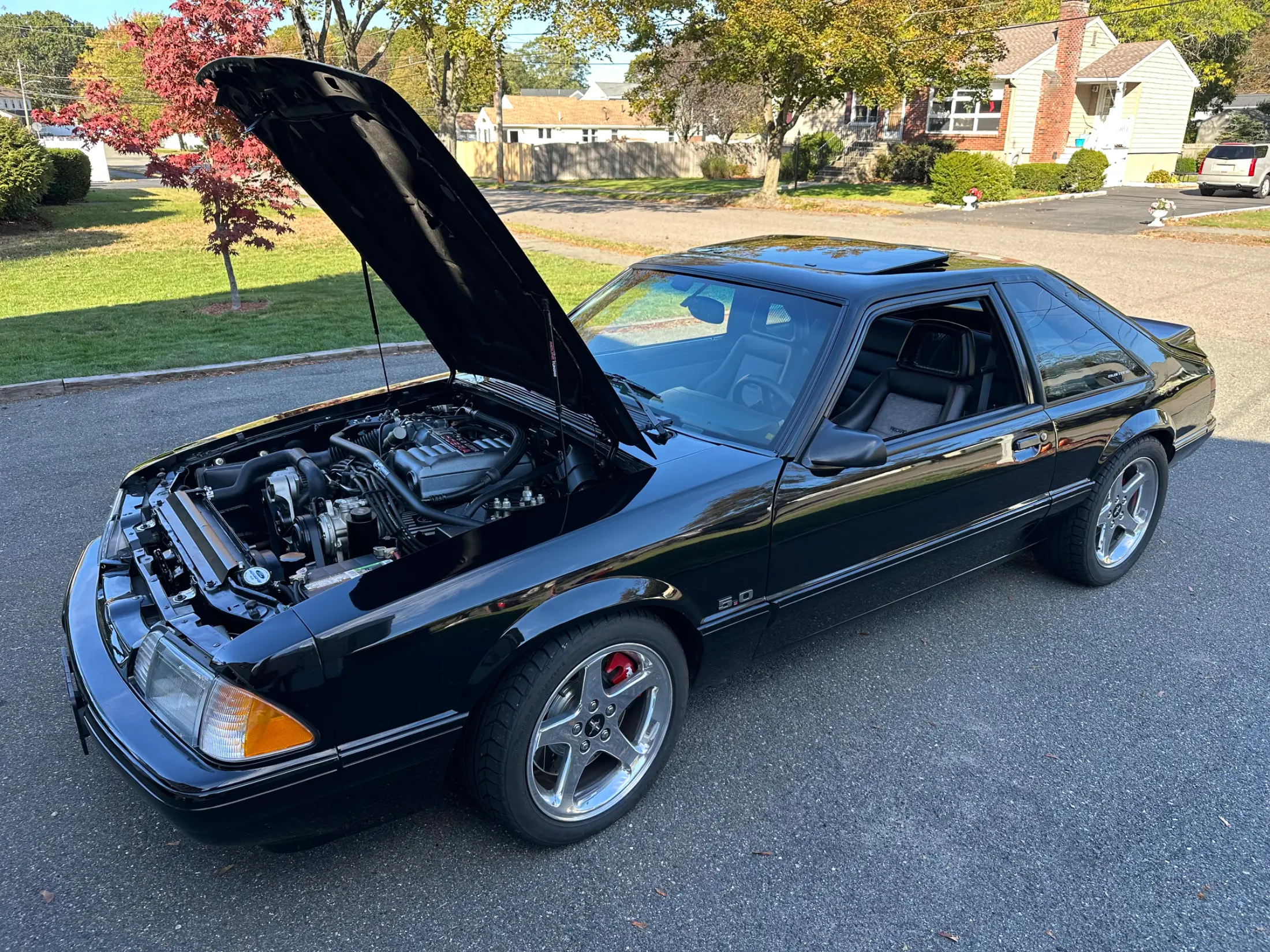

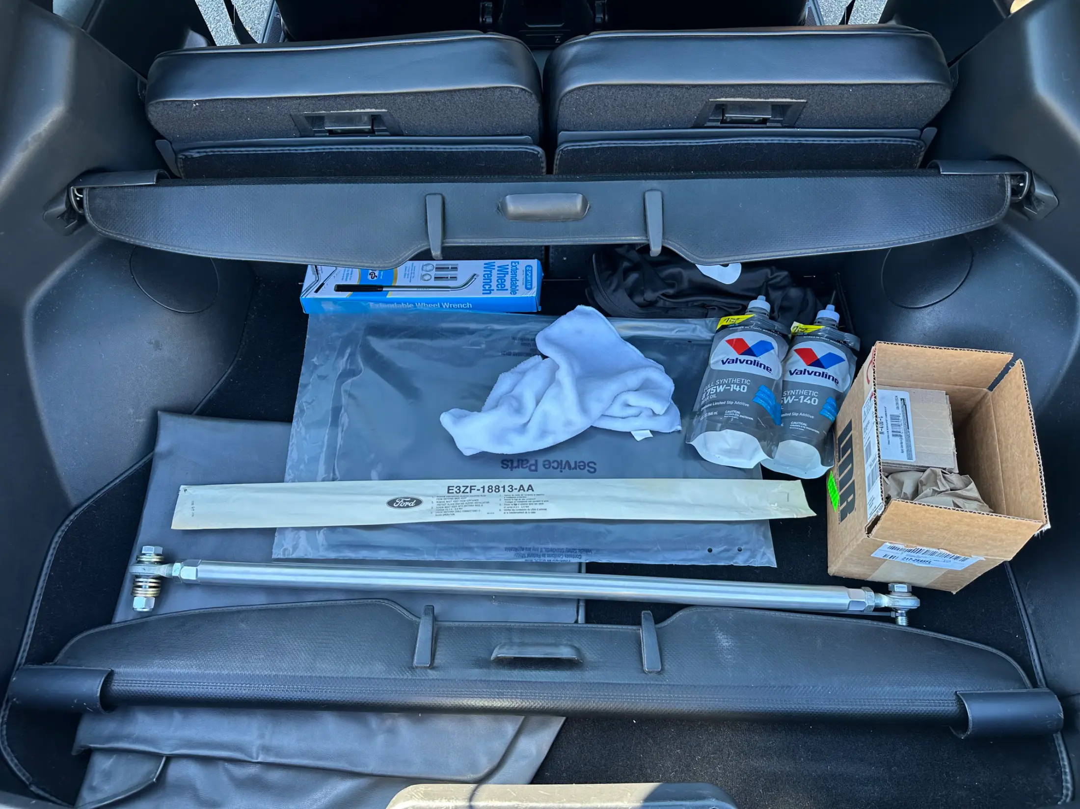

I lied. Another drive today. I’ve driven it more this fall than I have in the last few years. It’s driving pretty damn nice now. A few things to work out in the tune, but I’m 80-90% there. Working on my Accel enrich. Goes a little lean when I jump on it but I’ll get that.
Couple pics.
Haven’t popped my hatch in a while. Was surprised to see what I have in there.

AeroCoupe said:
You know it doesn’t panhard without that bar….

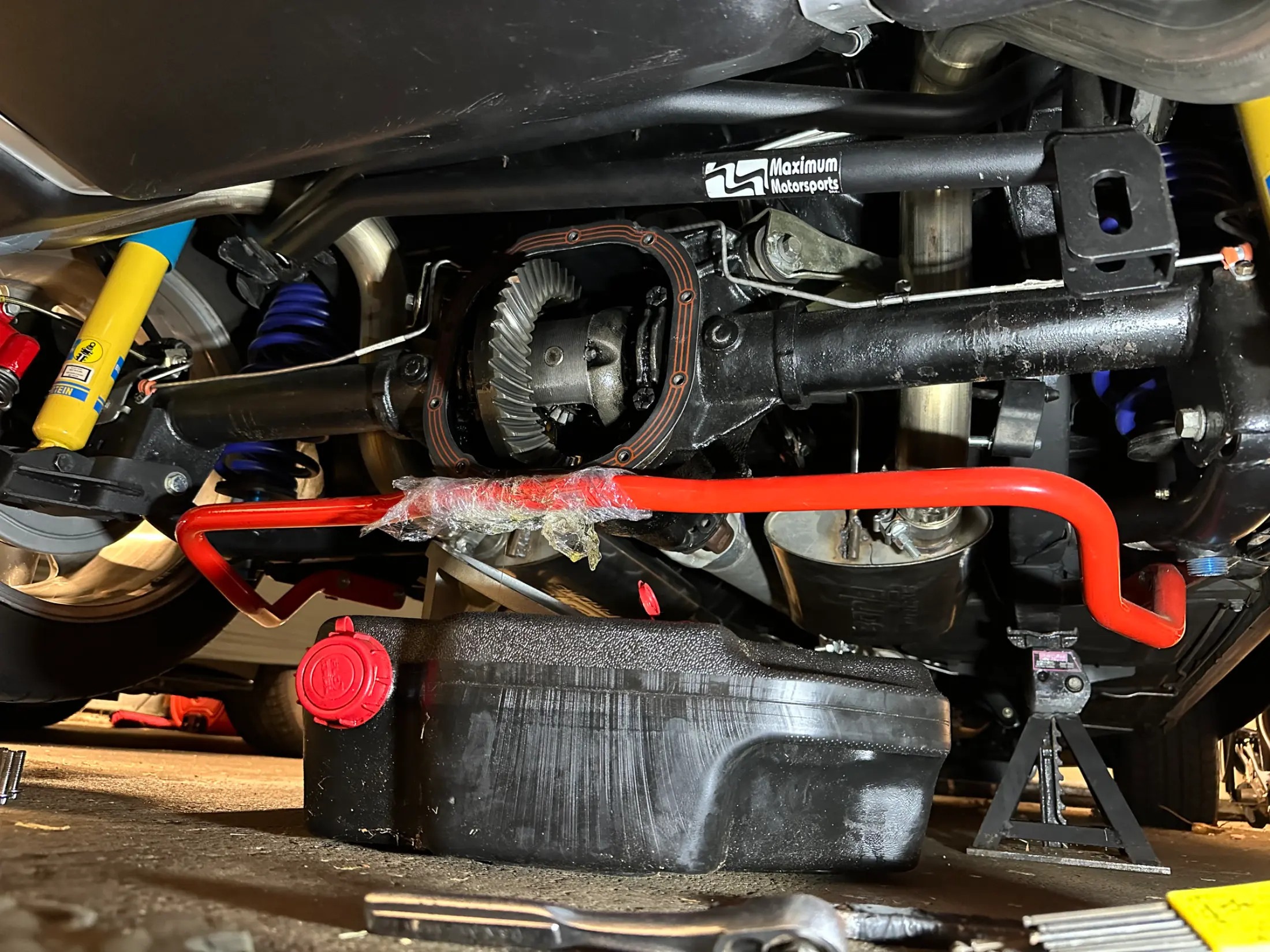

I know. I took it off because I wanted to install the carbon fiber clutch packs (box on right side of hatch with gear oil) last winter...and then just never did. On my agenda for this winter.

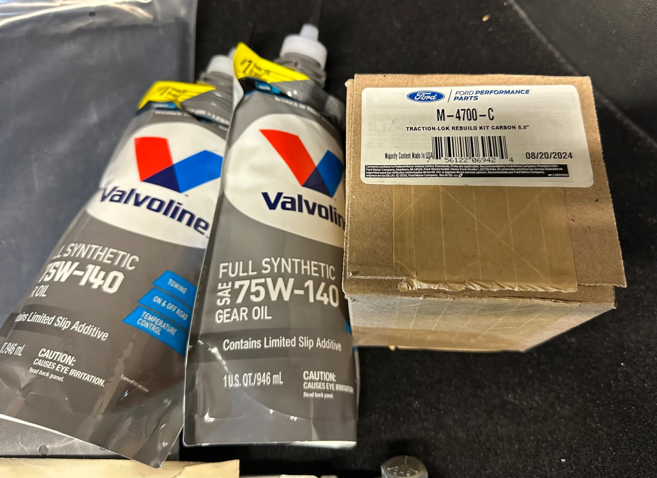

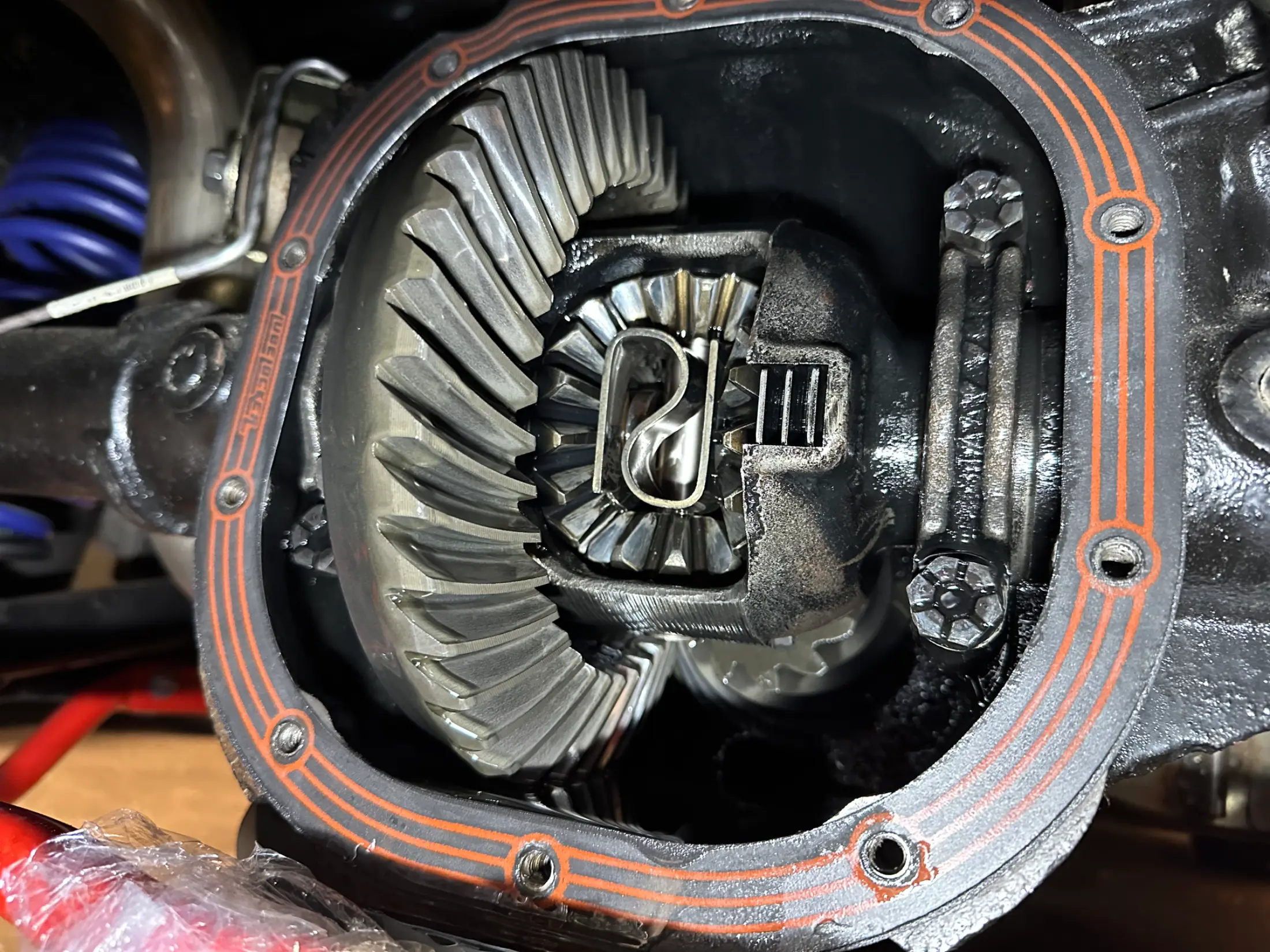

Well, was decent out weather wise so I snuck out again to do some more driving/tuning. VE table is coming together nicely. Needdd to add more fuel to WOT upper RPMs but I’m close. Had a nice 1-2 WOT pull and then remembered summer tires don’t grab well when it’s cold. But car feels good.
Got it home, and decided to start pulling the rear apart to rebuild the diff. There really wasn’t anything wrong with the diff. Still original clutches and works, but the clutches in my ‘00 are smoked and I wanted two good extra clutches to do the “every other” stack on that car. So I figure I spring for the CF clutch pack for this car, and bought the standard pack for the SN95 to add two used clutches from my ‘88 to.
Called it a night there. Figure let it drain a but and also didn’t feel like getting diff fluid on my tonight.

That the eibach sway bar? I've long considered it since i can't stand looking at mine with chipped and rusty paint.
Since i keep my car in the air half the year, i have too see it all the time, looks great on your car, i think i'll bit the bullet and buy one.
Yes it is.
I painted the stock front bar to match, but it's chipped in a few places. I guess really needed to be blasted and powdercoated vs rattle can. But this eibach bar has held up nicely.

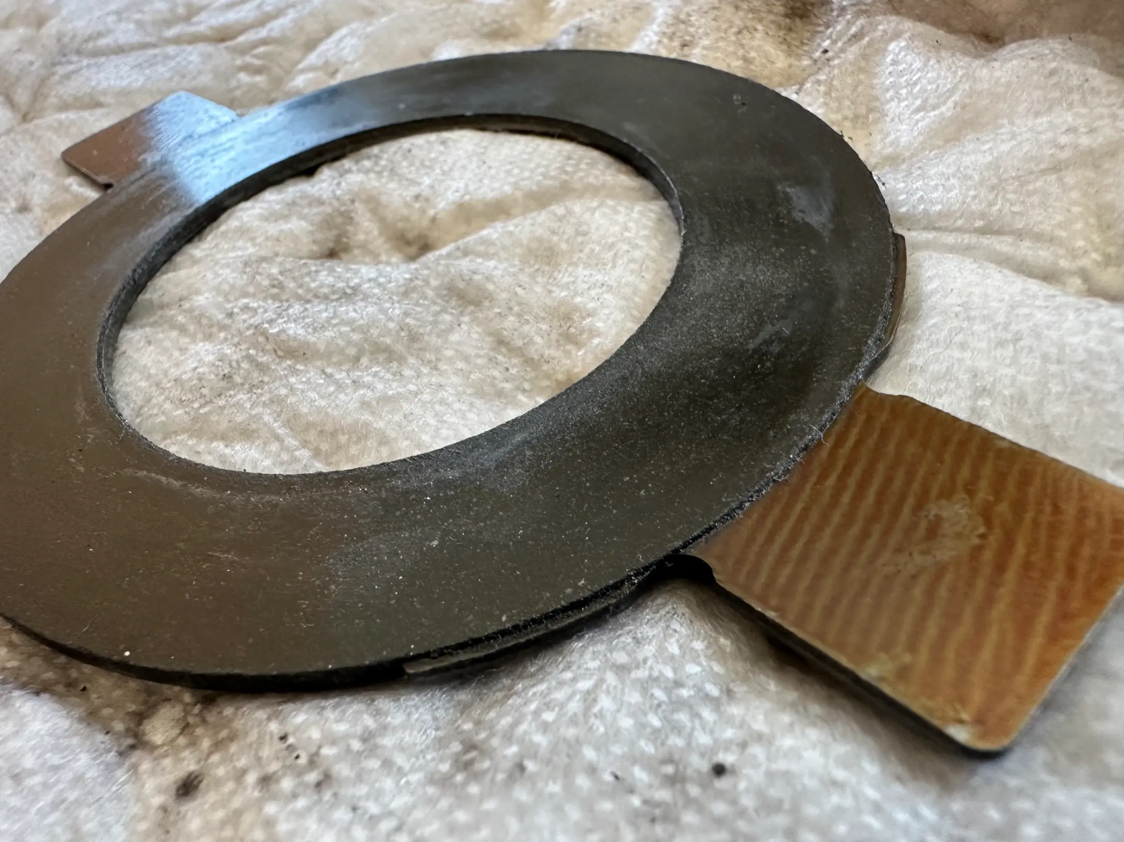

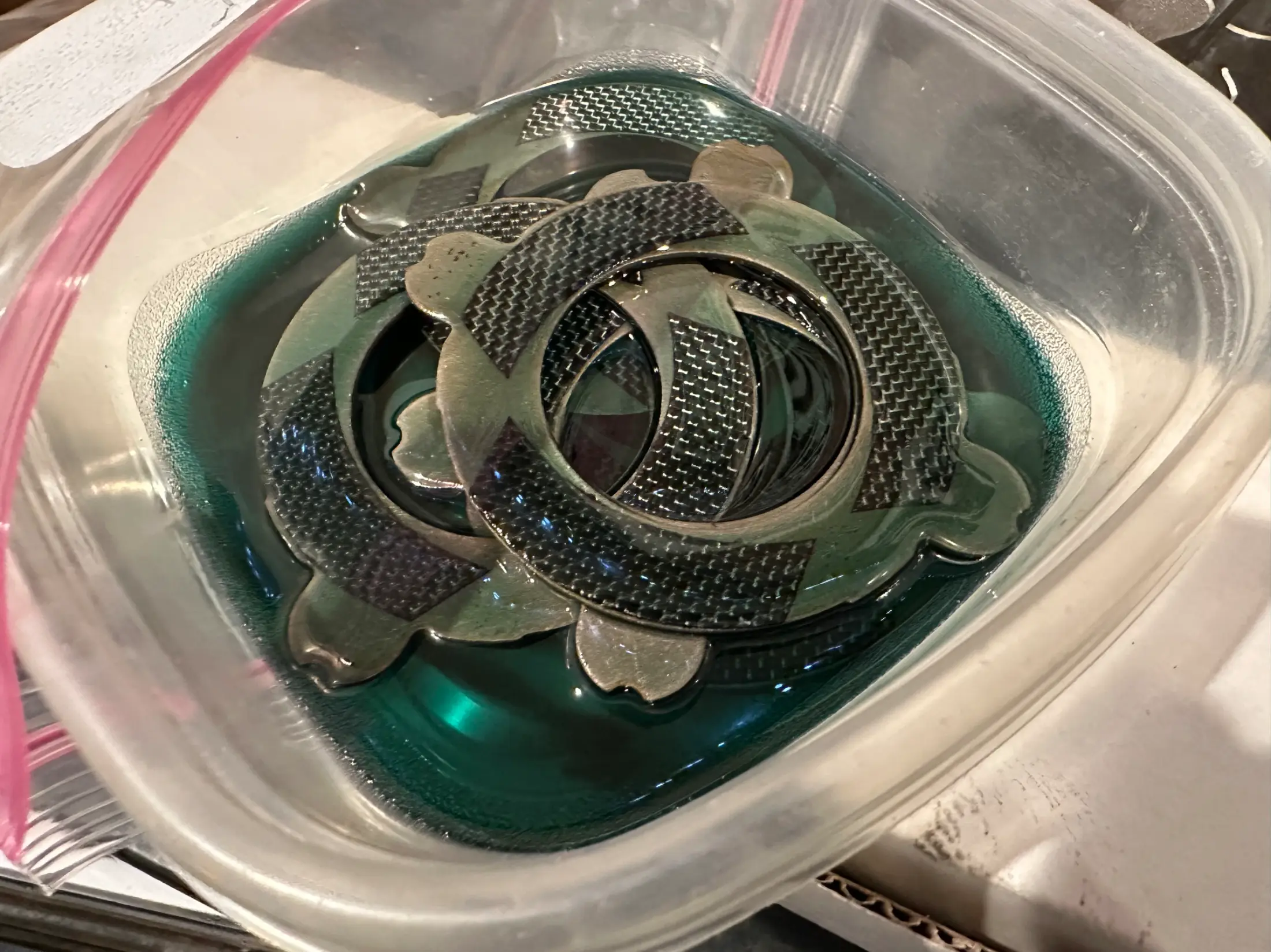

Well, almost done. Cant get the damn S-Spring in. Been trying all the YouTube methods and nothing yet. Longest part of this project.
Here’s one of my clutch disks. Wasn’t really too badly worn. These are original with ~100k miles on them. The T-lok on this car always worked well. I beleive OE spec is 0.545” thick and these stacks were 0.542” thick, so not a lot of wear. Apparently I drive my car too easy.
New clutches soaking in the smelly stuff before jnstall

I used a couple sets of vice-grips to compress the spring. Honestly, I remember it being a bit hairy, but I got it in there without launching it across the garage.
