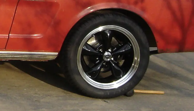

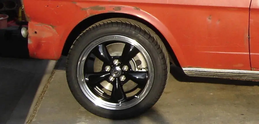

Here's a close-up of my fronts and rears.....I've got a 2mb pic of the whole car...not smart enough to know how to resize.....
Fronts are - Mustang Steve '08 conversion w/ 17x8 Torque Thrust "M"/ "0" offset/ 225/45/17 tires
Rears are - 2000 Crown-Vic w/ 17x8 Torque Thrust "M"/ "0" offset/ 245/45/17 tires
Jim
edit...and yes...that's the new "E" Brake behind the rear tire....LOL!!!!
