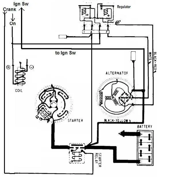

here is a pic of the basics you need for start/ignition. Get a meter and start checking.

OK, am really having trouble with pictures. THought I had EVERYTHING on photobucket but the wiring folder is empty, others are .tif, and the rest are too big, and the laptop has trial Office 2007 which expired...geeze. Try to visualize this. THe coil + post gets fed from two places. In the RUN switch pos, it comes from the ign switchvia a pink resister wire, in the start pos, itcomes from the brown wire on the second (right hand) small post on the solinoid. THese two wires are connected and feed the same place, the ign switch is where the split is made. If the brown wire is NOT conected, the coil will not get power when the switch is in the start position.
If you are putting the switch in the RUN position, and jumping the starter, and the car starts, the pink wire is good from the switch to the coil. If you turn the switch to the start pos, and the starter cranks the engine, but won't start, the coil is not getting power. Youcan prove this by hot wiring the car. run a jumper from the battery pos term to the coil + term, try to start the car with the key. If it starts, the coil is not getting power from the brown wire at the coil.
Oh wow! the attachment showed up! Look at the brown wire from the soliniod and follow it back. Wire 262 brown becomes16B which is the ign wire Red w/ greenstrip

You should not have to split anything. I went back and reread the thread. What MSD box are you running?
You say you have a SWITCHED 12v going to the MSD box. Tell us EXACTLY how you did this?
OK, I forgot about the MSD box earlier. All that is out the window. Nether of the wires matter at all. Referencing a MSD 6AL, ALL the orignal wires are removed from the coil. THe MSD Orange wire goes to the + coil post, the MSD Black goes to the coil - post. As long as you have SWITCHED 12v to the MSD Red wire in RUN position AND in the START postion of the ign switch, you should have no problems. If the car will not start with the key, you may not have switched 12v going to the MSD Red wire in the Start pos of the ign switch. Refer to you MSD directions exclusivly. Disregard all the BS I wrote. Sorry.

No, wih the MSD system, the coil gets power from the MSD box through the Orange wire in start AND run. The MSD box gets switched power from the switch 12v wire. THis "turns on" the MSD box, the ign "system as a whole" gets the heavy load curent from the direct battery connection...

THe MSD red switched 12v wire should not be connected to the factory red w/green strip wire. It needs a DEDICATED switched 12volts...this is what you need to clarify. Yes, you need to run a new wire (usually). THere are other options, butfor now, lets get the car running according tot he MSD instructions...
