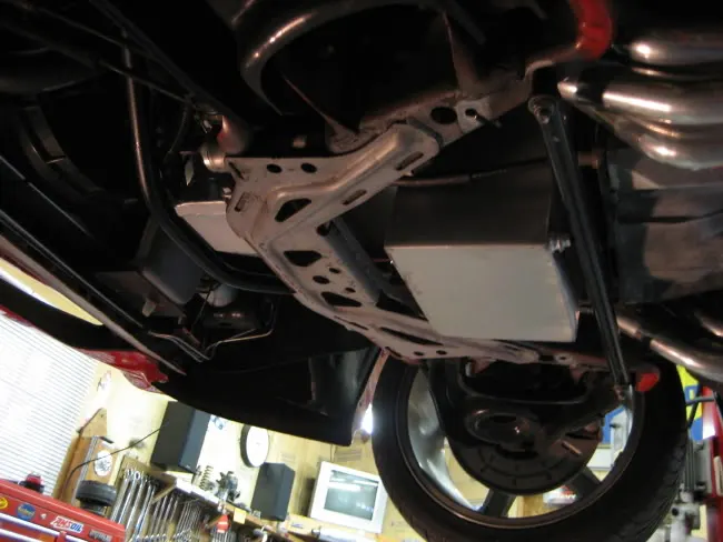

Check out another clearance issue.... had to remove the stock brace, you can see the holes, but was able to keep the Steeda bar I had... bar has to be removed for an oil chg and then the bolt ground. I had oil in the motor on the stand to prime so i caught that to late....its actually rubbing.:mad:
Front sump is ok but the front stabilizer cleared by a 1/4"
