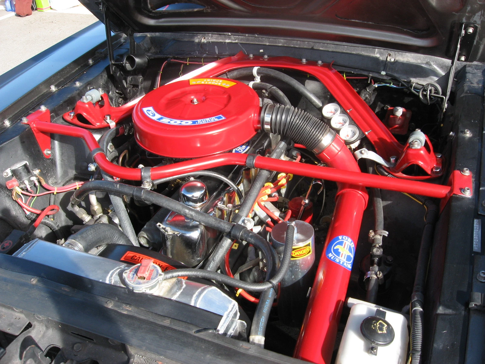

My 1965 Mustang six needs a motor. The OEM was bored to the max at .060" which is not recommended, but I had no choice. When hot it refuses to restart due to wall-flex. Once it cools a little it starts right up. Timing, points, plugs, wires, all related ignition parts are new and compression is great. On a trip to Tennessee and Mississippi last summer it did this refusing to start thing, so I understood when it was bored this could happen. If not shut-off it will run 75 mph getting 25 mpg, run well past the century mark, idle smooth in town, and works great...but if it dies, restarting is a problem. I need a 200 not a 250, and I build my own motors but send out for machine work to a friend. Any suggestions or places to contact would be appreciated. I am not looking for a rebuilt motor! I am 75 years old and raced for years, I am also an ASE certified mechanic who has built too many motors to count. This is not new to me, but the last 200 was made in the 80's...I think. All the new parts I put in this engine will be swapped into the new one and I know my mods work.

finding an inline small six can be tough, since most of them got tossed out when guys did a V8 swap. all i can suggest is searching the salvage yards for one. look under the hoods of fox body cars, fairmonts, granadas, etc. one thing to be aware of, if you find a low mount starter 200, grab the transmission that is bolted to it as well.

I kind of hate to be the guy, but "refuses to restart due to wall-flex."? Seriously? How was that diagnosed exactly? Versus like some of the more pedestrian reasons for hot-start difficulties like a hot starter, or issues with the cables or connections which can be checked by voltage drop testing. Does it not turn over well or does it spin and not fire or what? Just curious.
I just can't see replacing an engine because it was difficult to start unless it just had very low compression which got worse at operating temperature.
Strange things can happen though. I looked at truck the other day that wouldn't turn over because it was "seized". Once I took loose the fan belt and the locked up AC compressor was out of play it cranked up and ran fine. No one including me expected that one, but everyone involved was happy that a replacement engine was only estimated and not actually purchased.

GypsyR, my 200 inline had to be bored to .060" which is NOT recommended due to water jacket walls being too thin. The engine runs fine but in hot weather, which we have here in Texas in an abundance, those very thin walls flex...not much, but enough to cause the cylinders to close-in on the piston. I had a max-bored 283 chevy I raced in the 60's do the same thing. If you have ever seen "hot Spots" on a cylinder bore (heat discolorations) they are from walls that are too thin to support the pressures/heat. Shut the engine off, check the oil, get back in, and it turns over like a bad battery...way to slow, due to drag. My new 73 motor mics like it will handle a minimal .020" bore. Hardly any top grove and only about a thousands difference front-to-back-side-to-side. My history is as an ASE certified mechanic, city shop superintendent for police cars, ambulances, fire apparatus/trucks, building Street Rods frame up for 50 years, working for a man who built me a 4-bay shop in my backyard so I could build just for him...which I did for several years, plus I was a federally licensed gunsmith before retiring. Much of this work overlapped but I have never been afraid to ask engineers when I know...I don't know. MY Dad and older brother were both machinists and showed me a lot about how weird metal can be. I can start my 200 and let it idle to just warm and shut it off, then try to start it and it turns over very slowly. Let it cool...starts right up.

The hot start issue described is exactly the symptom I had when the starter shaft nose support bushing wore, allowing the armature to slightly touch the field when hot.

Ray65-71-73, there are several causes of a hard start when hot, but I am POSITIVE it is the big overbore in this case. With all new parts and only doing this after the rebuild with .060 overbore, plus having the same problem years ago with my mucho-bored-out small block chevy in a 1940 Ford coupe...I have no doubts.
