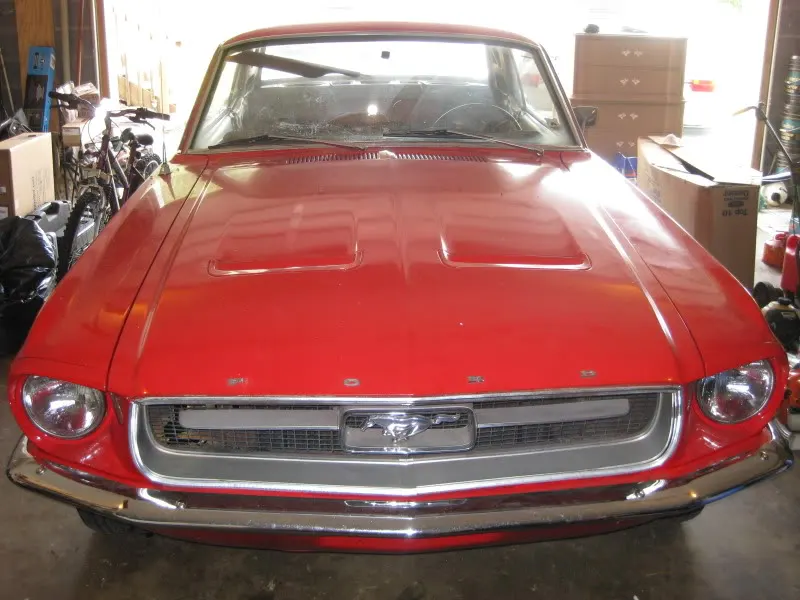

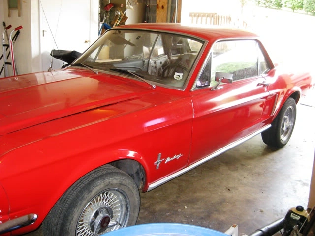

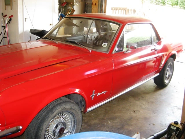

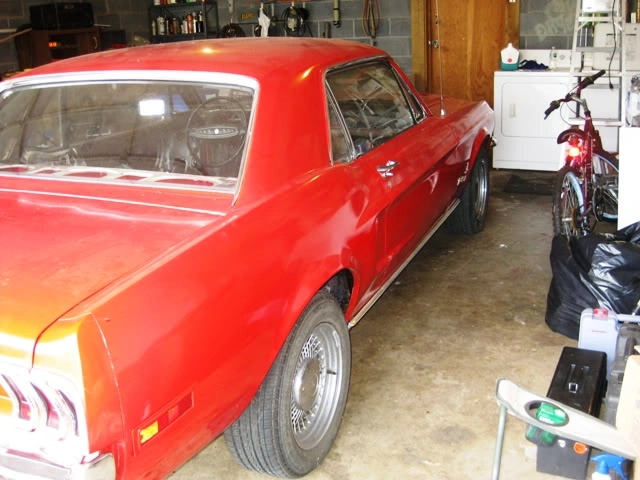

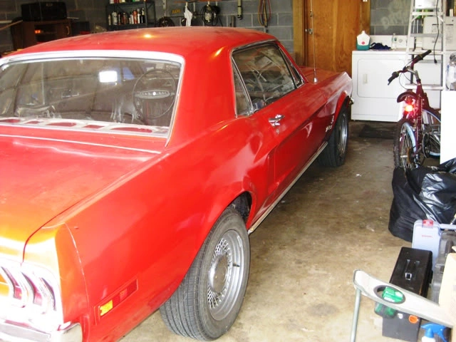

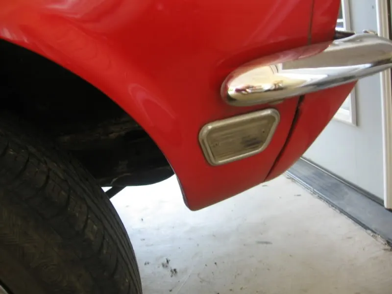

Hi all. I've been lurking for a while reading all I can and admiring all the wonderful Mustangs. I recently purchased a titled, '68 year car (8 model year) that has a grill from the '67 model with the two horizontal bars beside the pony. Other than that it has the windshield mount mirror, the signal markers in the hood, the rear marker light in the body panels and the VIN on the left fender and right corner of the dash. It does not have the front fender marker lights that I thought all '68 models had. No indication of any mods in the past other than a poor paint job of red over the stock white.
It appears all original so could this just be a late '67 car with partial '68 features? Anyone else seen similar cars? Thanks for all help in advance.

As pointed out above, it as probably a case of 1967 parts used to fix a 1968 car. 1968 cars had the VIN on the dashboard visible through the passenger side of the windshield. I am just curious if there are any 1967 VINs at the top two fender aprons? Sometimes if there are two similiar cars one totaled in the front and one totaled in the rear, they are each cut apart and the two good ends are welded together.
Same here being a '67 owner. Looks like someone totalled the front end and replaced it with '67 parts. Notice that it has the '68 side marker lights in rear quarters and doesn't have the '67 vents in front of the rear tires. I would take a good look at the front frame area, strut rod mounts, etc. to see if you notice and bent up metal or tweaking to straighten. This will help determine how serious the front ender was. Could have been minor (no damage to frame) but still bent up the hood/fenders and ruined the grille. take a look at the upper radiator support also for straighness.

67 front fender (no markers)

The VIN on the drivers fender matches the VIN in the dash. I know the car is a '68 model from the VIN and title and has the 8 model year designation as the 1st no in the VIN. I've closely looked at everything and can see no evidence of reconstruction at all. Everything points to a clean car with only a later "poor" paint job probably in someones garage to cover the white underneath. I suppose the grill could have been changed out but the rad support, inner fenders and everything in the front end looks untouched. If it were repaired I would expect to see some evidence...right?
T Hanks for the suggestions. When I get home I'm going to pull the grill and see if there is any evidence it has been changed or is a repo. I'm fairly certain the bumpers are repo.
What other diffs were certain on the model yrs? I'm hoping it's just an early 68 with 67 leftovers?? I know that's not unheard with FORD and all the others. Tim
Besides what has been brought up already, the dash panel, steering wheel and seat vinyl is slightly different between the two. All of these could be easily changed but it seems that maybe the previous owner just liked the 67 grill? A 67 steering wheel is a three spoke with the big center "thing", 67 gauge cluster will have separate turn signal indicators, for the vinyl it would be best to look at an ad for replacement pieces as they will show the pattern. I also think the 68's had a rectangular interior door release while the 67 was a rotating lever type. Also, the turn signals in the hood was a 67 option as well, not just for 68. Also, what engine is in it? If it's a 302 it would be a 68 although I think there were some early 68's with 289's.

I'm with the Majority in thinking this car has a complete '67 nose, on a ;68 chassis. It's very probable that this car sustained superficial wounds in an accident 43 years ago, and could have had a quality repair job done, utilizing a '67 nose. (Maybe '68 parts were hard to get at that time?) than painted white..... Later the Red paint job could lead you to think that it was original? Get a Marti report on the car, to see how early the build date is. And as others have mentioned, check both apron vins, to see that they match the dash vin.

Thanks everyone....looks like I jumped the gun. I was sitting in Mexico with too much time on my hands, wishing I could get started with my new project. The car appears to be all original, no damage or repair with the exception of the '67 grill which was probably replaced when the bumpers were at re-paint.
