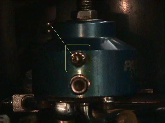

oh uh .....well that oil spot i mention wasn't oil i put it back on and ran it. I saw the puddle so i stuck a paper towel down there and smelt it. Its fuel, do i have to have a vacum hose on the regulator i never have before but im trying to think why its leakin. I think its coming from regulator or the 3-4 injector

well im saying i dont have the vacumn hose on it and ran it like that and never had a problem. I was told i dont need it since im not running a power adder. But its a paxton fuel regulator and i sat there and watched it. Its coming out where the vacumn hose is suppose to go. Is that suppose to happen or could there be something wrong with the regulator if not ill just plug it up somehow. It only does it after ~3mins are so and more throttle more gas but i turned it off right when i saw it.

oh oh, i gotcha. so fuel is coming out of the regulator (where the vac line attaches)...right.
if so, your reg took a dump. the diaphram in there went bye bye. some of the regulators are rebuildable (Kirbans maybe). if so you could try to rebuild yours (i dont know if yours is rebuildable). but do get a new one or fix yours for sure. pricey little buggers too.

Heres a pic of it to explain what i was talkin bout. Its not coming around the outlet but actually going thru it...thanks

that is the thing - most regulators are not rebuildable. it is a 50 cent diaphram that needs to be replaced, but you cant often do it. if you want call the manufacturer and ask tell them the diaphram appears to have gone south and fuel is leaking out of the vac line fitting, and see what they say. otherwise, hunker down and get a new one, unfortunately.

You can take it off and pull it apart yourself. If you call Paxton you might be able to get a new diaphram. Hopefully it doesn't cost too much. I have found the best luck with stock like regulators believe it or not, not billet ones. I use the Holley or Crane ones like this one....only $54.88.
