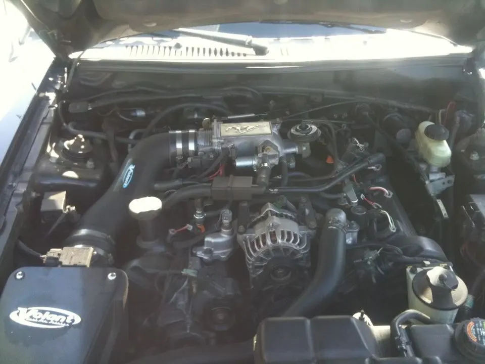

my mustang is SLOW!!
i just drove it to see how it runs.. im at class right now.. on my way to class it started acting up pretty bad.. no power at all, above 4000 it just stops trying at all, backfires, it had absolutely no balls AT ALL.. i swapped the coilpacks as soon as i got to class and just took off for lunch to see whats good with it and same thing.. just now today my car officially started running like :poo:... no new codes no nothing it just runs really bad and slow. something is definitely wrong with it and it is driving me nuts!! when i get home ill post a pic of everything.. its pretty clean! nice body and the engine is pretty nice too... another thing it started doing is when i start it warm it bogs down pretty low and almost dies then goes back to nice idle.. i wish it would just throw a damn code!!! its running so bad its hard to believe it doesnt pick it up!

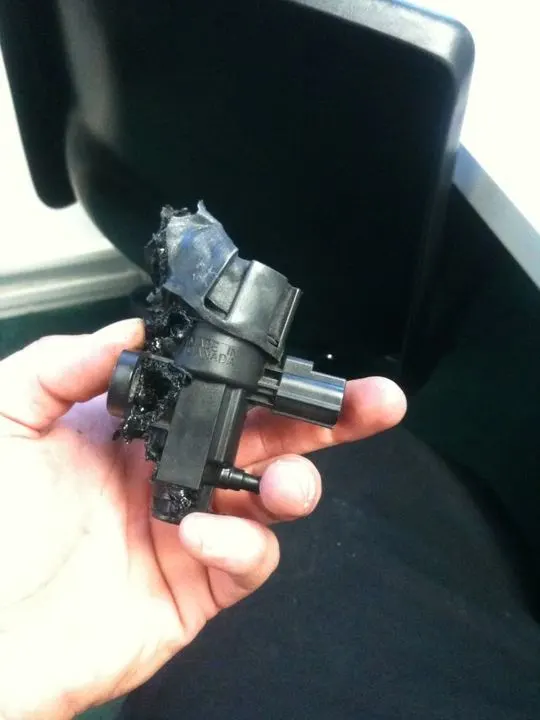

ok so today i was driving to work and the egr vacuum solenoid exploded! i replaced it then the tube that goes into the flat valve thing behind the egr vac solenoid from the egr tube. now i have raw exhaust gasses just fogging my engine bay! does anyone know what could cause this?!
theres a line going into the other side of the flat valve that is kinda kinked a bit.. could this cause a restriction causing the pressure to rise and pop the other hose off? i think thats the first thing im gonna try when the car cools off..

well i took out the bend and it still pops the hose off and it still runs like :poo:... i have no clue what could be wrong.. im gonna take off the egr in a few minutes to see if its ok.. im actually really hoping the cat is clogged so i have an excuse to gut them.. if anyone has any input please say something!! im gonna go crazy over this and start dissasembling :poo: pretty soon!
Does in run like crap before or after the hose pops off..itll be normal if it runs like crap after the hose pops off..you might have to go to the auto parts storw and but some clamps to clamp rhe hose down. There would have to be excessive pressure going through the egr valve to be popping the hose off id assume...not sure how or why that would be though
FIGURED IT OUT! i got under the car and started to inspect the cats and noticed my middle cat on the drivers side of the car had gotten hot enough to make the paint peel off my car right above it! i started shaking and banging on it to hear little pieces shaking around. the first cat had deteriorated and clogged the 2nd cat. after discovering this, i gutted my cats with a hammer and a piece of electrical conduit. it took almost 2 hours to get all the :poo: out of the cats.. after taking it all out i reassembled the car and it sounded and seemed great. i re connected the egr and all then went for a drive. the car had all of its power and i realized that the car was not even close to this fast when i bought it! THEN!! as i was stomping around the block i think it spun a bearing!!! it started knocking pretty hard and i had to call aaa to come tow her home! now i think im gonna just put a 2v 5.4 in it. so in conclusion to all this: bad cats cause egr problems! also they cause a lack in power!
