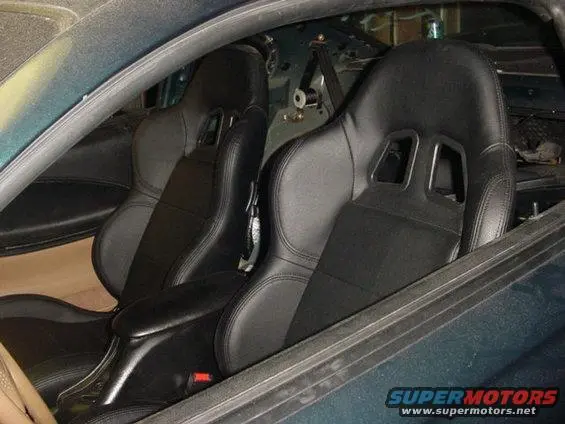

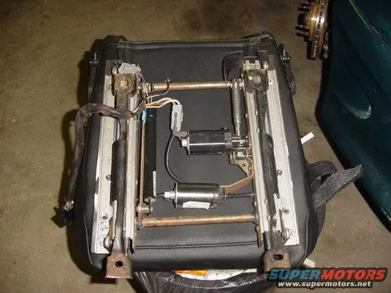

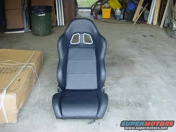

I like my jeg's seat......It looks good and has lasted 3 years or so. And it basically just bolted to the stock frame that i reinforced with aluminum(mine snapped). The non power pass seat was a bit harder, i had to weld the new seat brackets to the old frame...more work.

Depending upon where and how the break is, you might be able to have a shop weld it back together. It's common for the ears to break off the brackets where the brackets bolt to the floor.
Kyle, the seats look sharp. :nice:
Can't really imagine paying someone to do 4 bolts and a electrical connection. Pull the drivers seat out and see where it's broke. Mine the track was broke, but the seat is fine, or as fine as any other 14 year old seat anyways. 4 bolts to take the seat off the track and bolt to used replacement track and motor from the junk yard, (MPS) 4 years now, no new problems.
