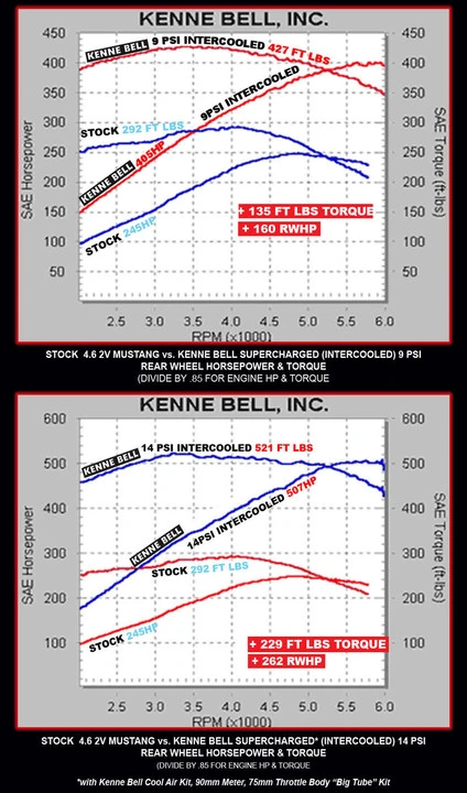

Here's a reference from the KB website for a 2.1L Big Bore kit on a 2 valve (96 to 04).
You can see that at 9 and 14 psi., it's a LONG way from 850 HP.
So basically unless this car is running a fully built motor and 20 psi out of the KB 2.2 then what I am looking at is probably more like a 400 hp car?

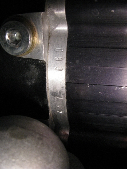

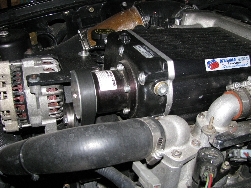

Actually, it's at the front of the blower, just behind the drive cover. You can see the stamping here on mine:
and up close:
The '417' refers to the Autorotor 417 (1.7L) case size. I don't know what the larger ones had (421, 422?). The '660' I assume is a serial number (?)
See if the guy can get a clear pic of it. Maybe it will at least tell you the case size.
