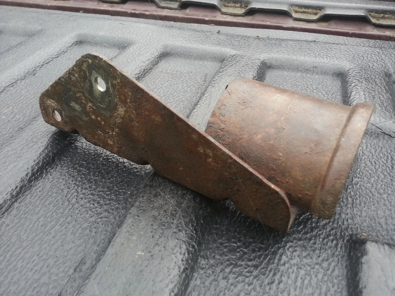

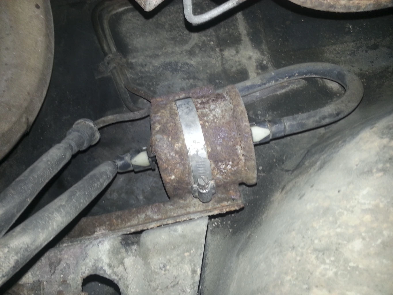

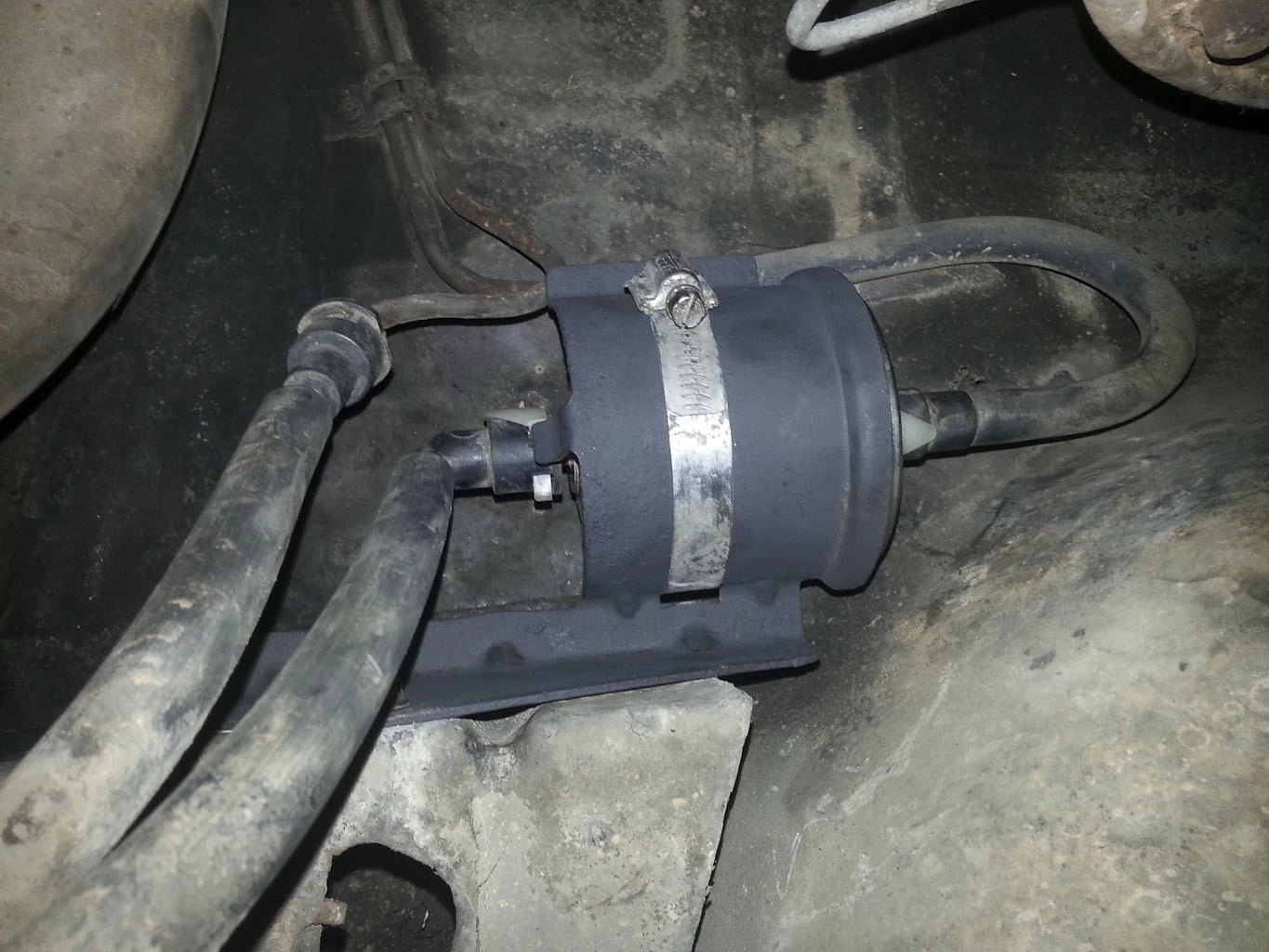

Hey Guys wanted to give an update. Everything is back to normal I did some double checking and cleaning yesterday and here is what I found out:
  • NGKs where not spaced properly, swapped them out for my Motocrafts I spaced (and re spaced) The tips on those NGKs all had a white film on them (not sure if that's significant)
  • Checked my MAF, Cleaned it with a Q-Tip and some MAF cleaner (rubbed the wires, didn't break one thankfully )
  • Check my connections on my CIA (all fine)
  • Changed my fuel filter, pretty sure this helped a lot because this thing looked like it had not been moved since 1989 (Pictures attached)
Once I got all that done I started back up and it ran much better. Still has a bit of a timing issue but its nothing like before. It is smooth and I think everything will time up perfectly now.
I will get the car timed and check the codes ASAP.
