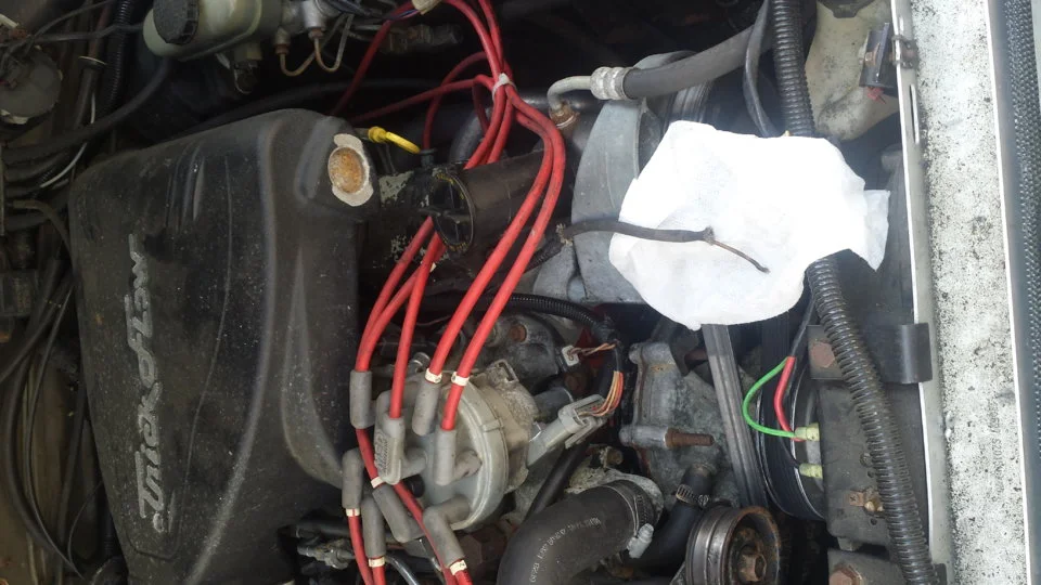

The wire is located under the hood and it is grey and red. I have attached a picture of it. It is a single wire with no connector at the end.

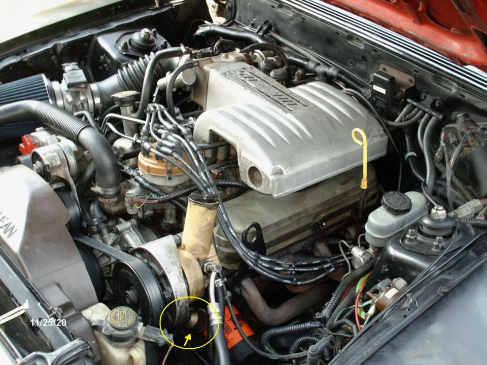

I believe that goes down to the oil pressure sending unit. Its the round shiney thingy under the A/C compressor, right before the header on the drivers side. There should be an elbow plug connector on it that's supposed to be attached to your lost wire.
Here's a pic I found of it. "Yellow Circle"
Reactions: jrichker
After looking at the Mustang wiring diagram I have, I agree with the two opinions above - oil pressure sender wire.
The diagram says white/red. but after years of heat, oil residue and dirt, it probably does look like gray.
