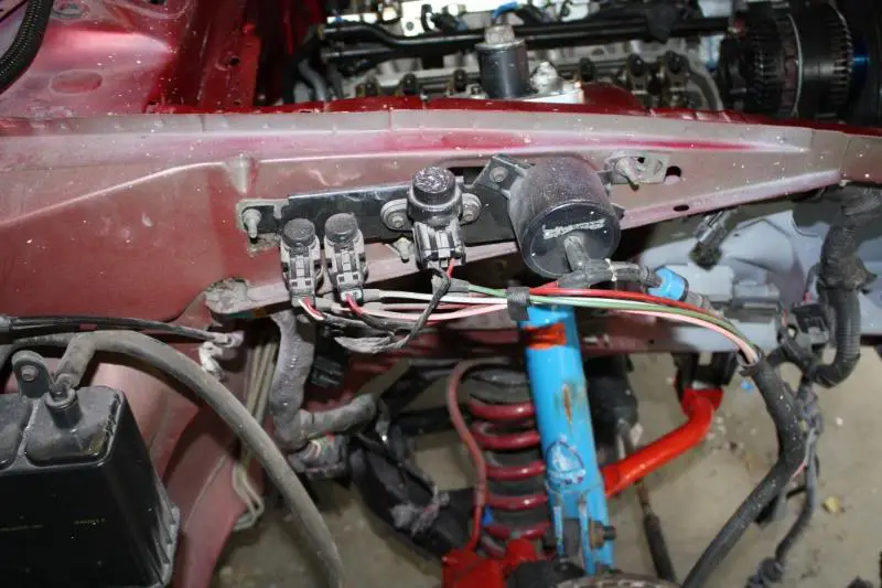

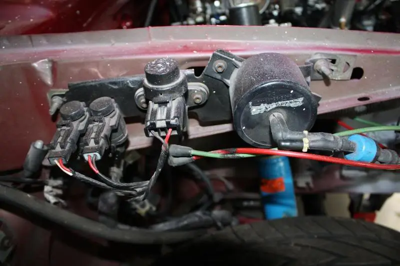

I took some picture of how i did this.
Tell me if i this this wrong, And also i took out the little vacuum module thing on the passenger side because it broke...I don't even know what that piece does.
For the smog pump i plugged this while line and orange line
For the EGR I routed the vacuum this way. Is this right?
Currently there is no vacuum lines going to the EGR. I still have it plugged in.
I also broke this. What is this. While i was deleting the EGR, i unplugged and threw it.
Let me know
What is that green and red vacuum lines? I thought i could use it as vacuum source for the fuel pressure regulator. Am i wrong on this whole process?
Let me know
Thanks guys
That pic is of the purge solenoid (the charcoal cannister solenoid empties the CC cannister, which stores vapor from the fuel tank). It hurts nothing to leave this system stock. If that line is open and you park near a pilot light (furnace, etc), you have fuel vapor and a pilot light in the same vicinity (as a chemist, you know that's not good).
Red supplied manifold vac to the EGR and smog solenoids. It would probably be ok for a FPR source *if* you don't use it for *anything* else (you don't have smog or EGR solenoids).
The FPR should have had a blk/blue vac line. Your intake might not have the provision, but the stock FPR line is super short (and a dedicated line). You want the FPR vac source to be super close to the FPR (and don't tee into that line).
Green is a branch off of the Red line. It goes to the EGR solenoid. Don't use this (for length concerns. Red is more direct if red isn't used for anything else).

Okay so the piece i broke is called canister purge solenoid. Since i don't have the EGR or the Smog pump can i just get rid of this? If i don't have the smog pump this solenoid and charcoal canister is useless along with the smog and EGR hoses and connectors inside the fender...I think :dontknow:
I researched a little and it purges gas fume back in to the intake and tells the computer to lean out. So it is basically another emission equipment that it will be malfunctioning.
I went and got another purge solenoid just in case. but i do not see the need to hook this up...
I want some opinion. I am going to get the car tuned so i will be deleting the EGR and SMOG, Emission stuff out of the ECU.
Let me know
Thanks :headbang:
Let me know
Thanks :headbang:
Read the post two above yours. It is not just an emissions device but a safety device. You will never know if it's functioning or not. All it does is vent gas vapors in a closed loop. It has nothing to do with the A.I.R or EGR systems.
