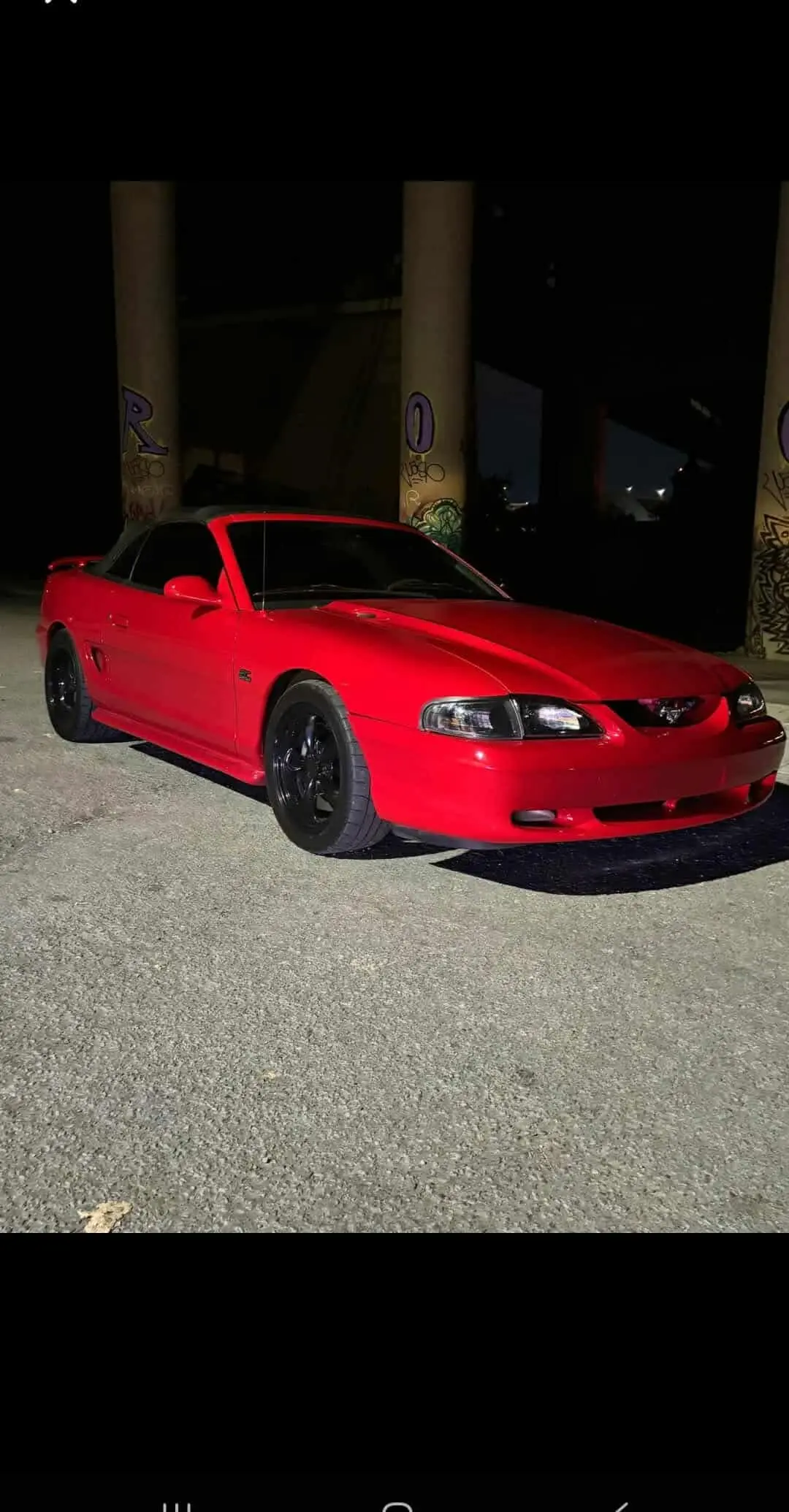

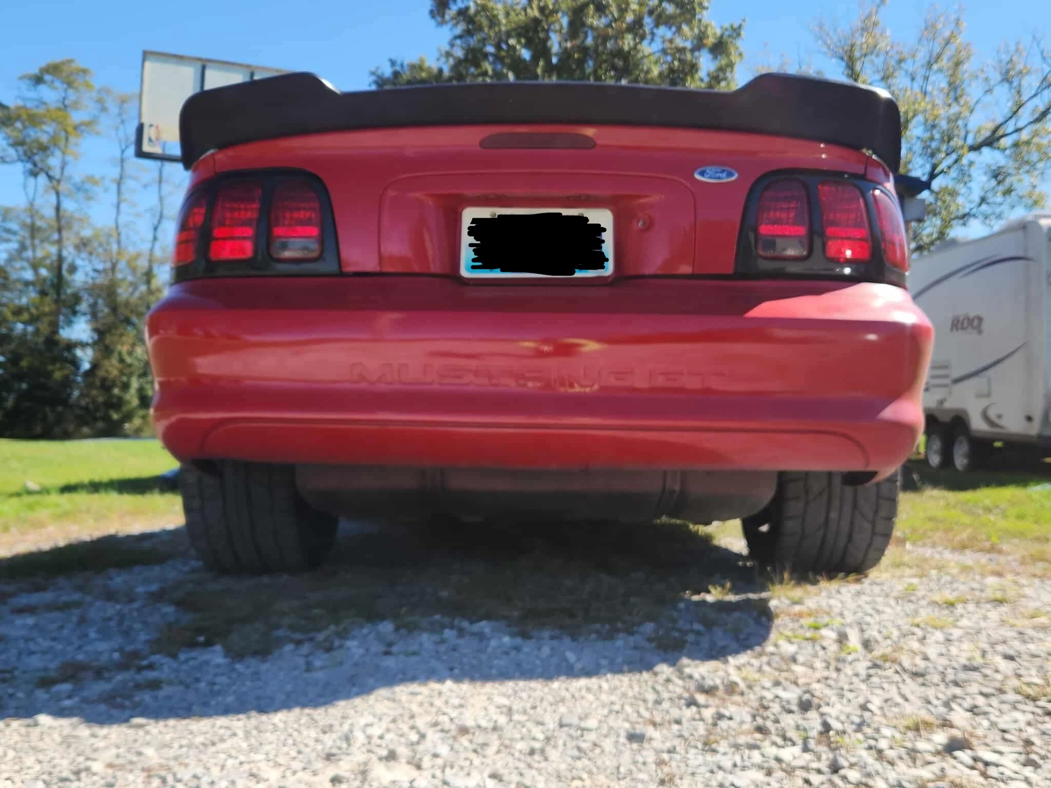

Recently got a convertible 94’ Mustang GT (automatic) as a trade and it’s been a bit of an interesting ride so far..
Upon looking at the car it’s in great shape. Zero rust to be found on this thing anywhere, the top works, and all the interior plastic is still in pretty good condition. Essentially stock aside from some BBK headers with an exhaust that currently dumps out underneath the car, double din radio, and an EGR delete.
