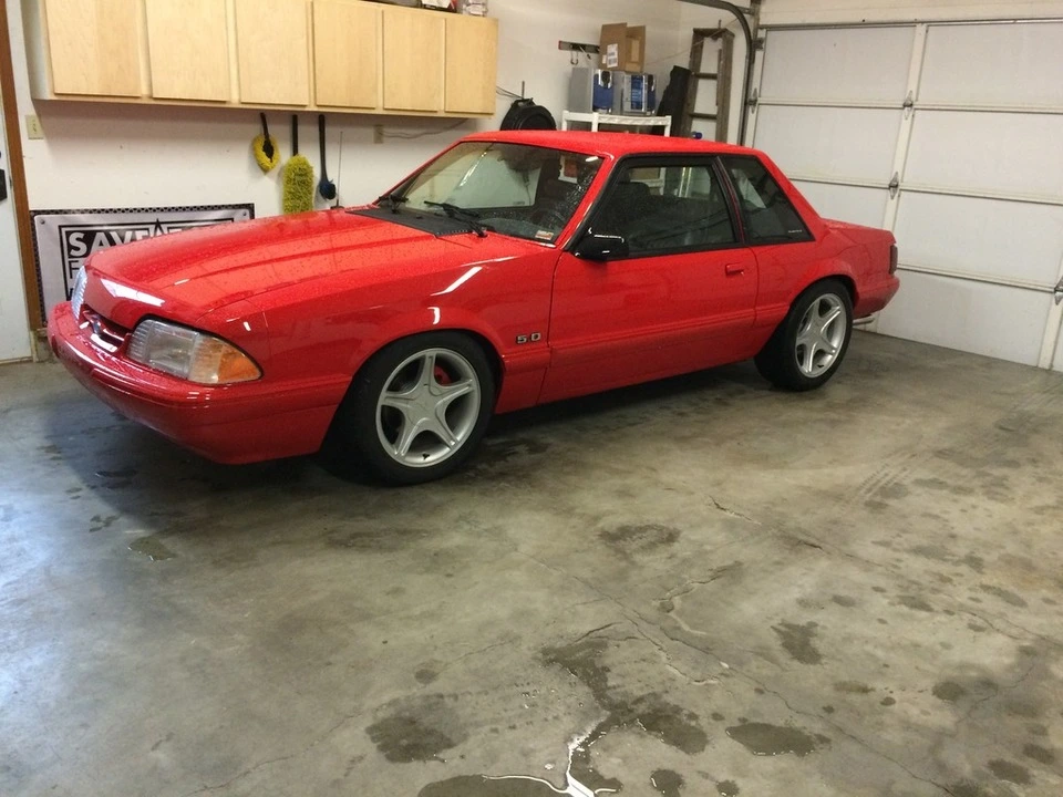

Finally in the shop.

That's with V6 springs? That looks low
Also, that's an '86?

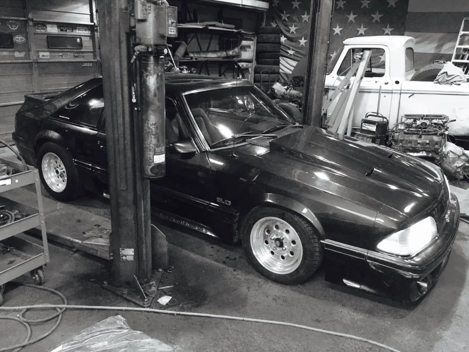

Here is my car on v6 vert springs. (front only) I think they were cut but saw no signs of it when I removed them and placed in the dumpster.
They sit low and ride like ass in a fox.

1999-2004 v6 spring
I think it's a 87 or 86 I don't remember off the top my head
