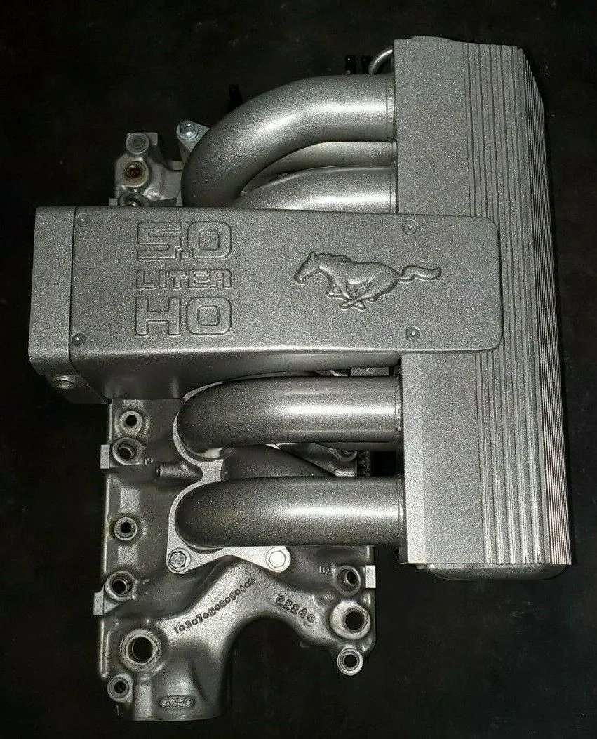

What can you tell me about this lower

Give us the big picture please

It is likely the lower from a cobra or explorer engine,

Thanks for the reply That's exactly what I'm trying to find out
The seller says the lower is for a Tubular GT40 but is it?

It will fit the tubular upper.

This could help out:
http://tmoss.efidynotuning.com/Ford_GT40_Cobra_Explorer_Intake_Design_Observations.pdf

Thanks LILCBRA that help immensely .

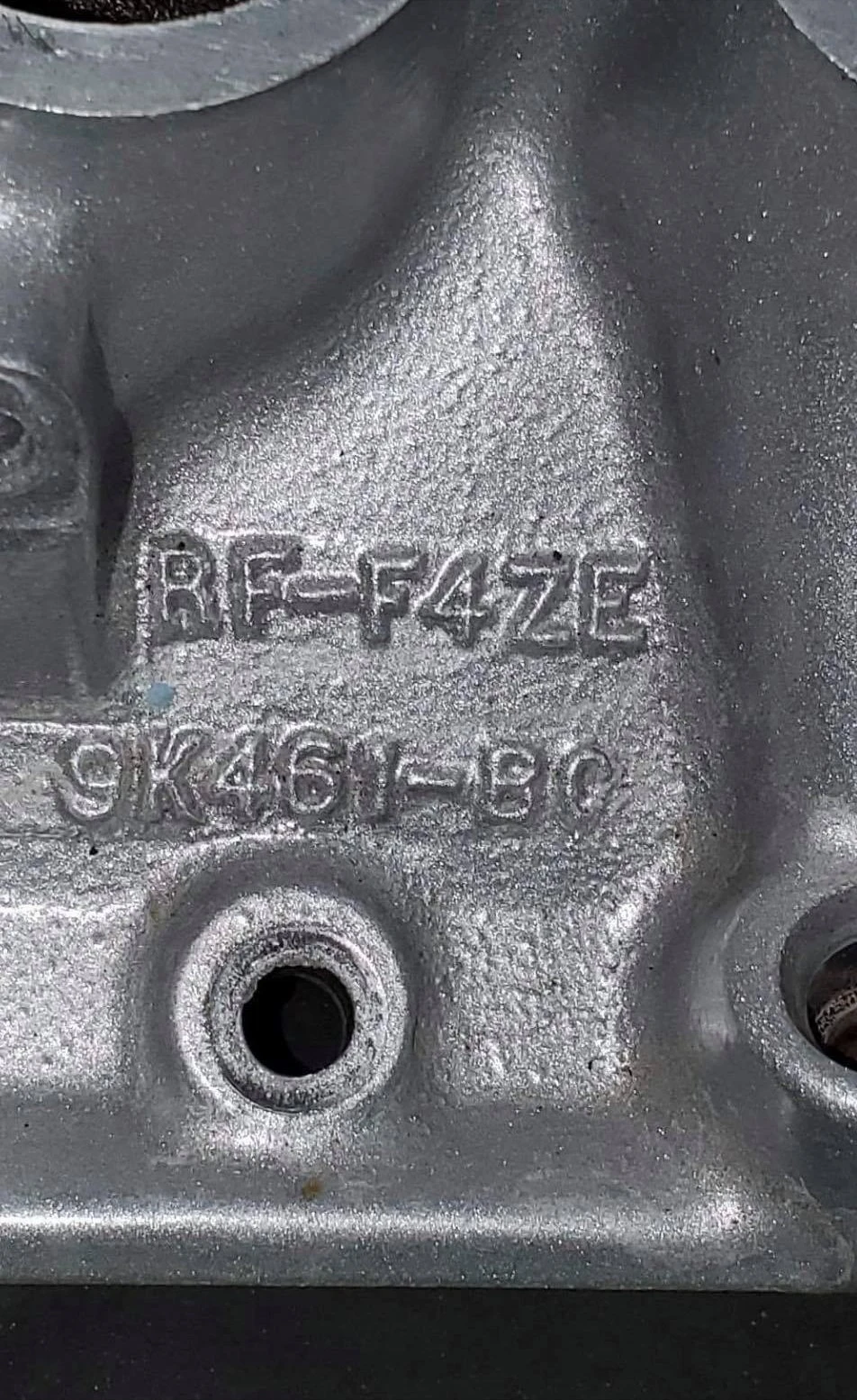

Ford motorsport intakes came with whatever lower intake was in production at the time. The lower is a 94 cobra engineering part number. Around 1997/8, Ford started shipping them with explorer lowers with the properly drilled out act and coolant ports. So likely, if that lower and upper are an original pairing, it was manufactured sometime around 1994-1998.
Exactly the info I was looking for Thank You.
