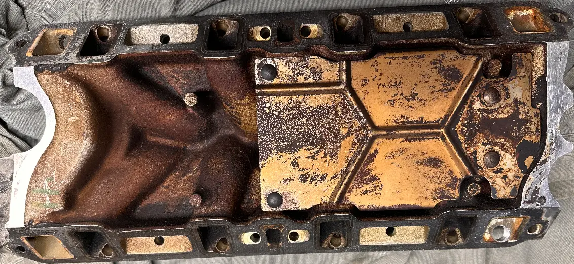

I recently purchased a 95 upper and lower explorer intake from ebay that looked great! Only to find out, especially the lower, needs a really good cleaning internally.
It has the baffle riveted on which i really don't want to take off. I got the gasket mating surfaces really clean but what can I use to soak or clean the valley?
Here's a pic before the gaskets surfaces were cleaned.
I cant find anything online that give a definite answer so I thought I would ask all you professionals!!
What do you think??!
If you don't want to spend a small fortune on Chem-Dip and you don't have a parts washer, get a pan big enough to set the manifold in, buy an engine cleaning brush kit from HF and a gallon of Purple Power from HD. You should be able to scrub underneath the baffle and reach up inside each runner with the brush kit. Just don't leave the manifold soaking in the Purple Power for too long. It's pretty caustic and may start to eat the aluminum.

I was against it, but I decided to take the rivets out to make cleaning access better and I'm glad I did. Under the baffle, it was really caked on and had to be scraped before soaking and scrubbing.
After researching about the rivets, I've learned they actually have threads and can be twisted out. I took vise grips and they actually twisted out pretty easily which was scary. After cleaning, I'll reuse the rivets and twist them back in.
