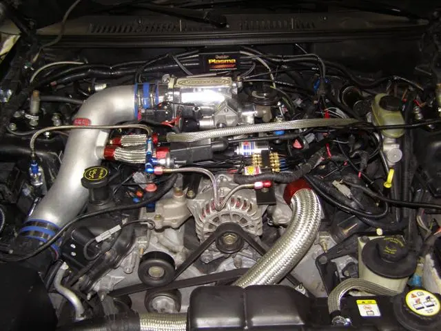

I have an NX 2v plate kit. I have the bottle hose run from the trunk under the car to the blue selenoid. the from the blue to the plate beneath my plenum. i tapped the fuel from the test port and can it to the red selenoid. then from the red to the plate. Running a 100 shot with a can tune, im going to the track next week when its dry.:flag: you can see the selenoids in the pics. i dont have a pressure gauge in the cab yet but the one on the bottle is a zex. works great :)

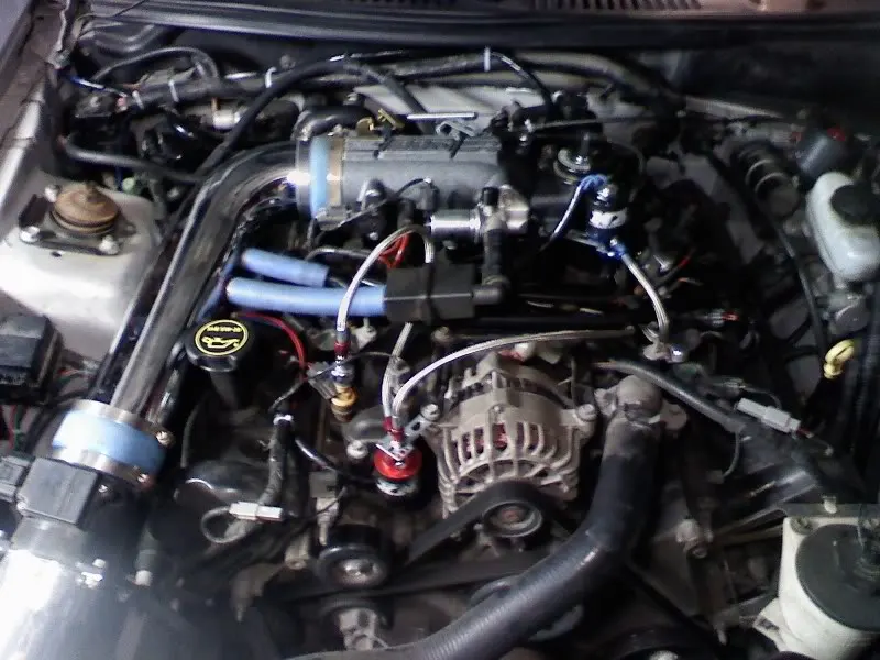

Fuel Pressure Gauge setup on my old 2002 GT.
This was the NOS Noszle kit, direct port injection. It rocked.

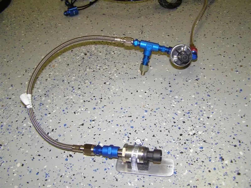

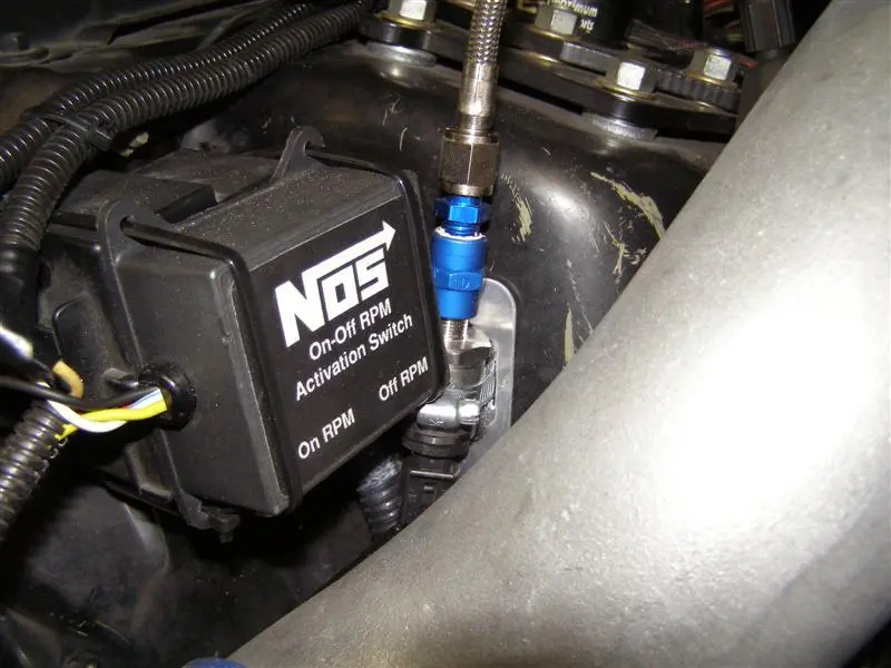

I mounted the FP sender on the shock tower as recommended by Autometer (they recommend remote mounting). I made the mounting plate out of a piece of scrap aluminum, a small hose clamp, and behind it I put a piece of black dense foam. SS screws held it to the shock tower.
I had to add the short length of SS line and a couple of extra fittings, but it's the right way to do it.
