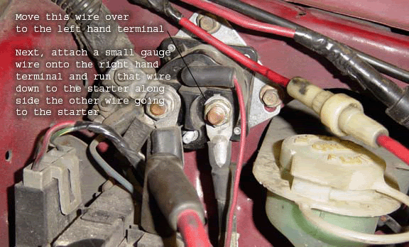

If someone can, please post a picture from a fox body that shows the wiring to the starter relay, coil and battery areas. Thanks

positive battery cable to one side of the relay and everything else including starter wire goes on the other side dont forget the little red wire on the post. Sorry no pics

here you go hope this helps! its not mine i got it off of the internet! the words on it arnt mine either so you can diregard the words to!

Thanks. Appreciate the help!!

The starter wire doesn't seem long enough??
