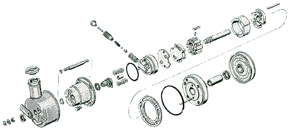

The only criticism that hold any water is the Bendix PS has such high boost that it makes steering too easy. I have to wonder, though, if this comes from using high pressure reman pumps in performance cars intended for lower pressure pumps. Perhaps there's a way to assure the pumps produce only as much as they need to.
The 64-82 Corvette had the same Bendix system as the 65-70 Mustang.
You can put a regulator in the PS pressure line but it may cause the pump to heat up/fail prematurely.
I've never seen a stock pump with an adjustable pressure valve. I know KRC sells a pump that has an adjustable valve and a remote reservoir.
The valve is internal and cannot be seen with the reservoir installed. The parts sticking out the upper left side in this view are the regulator.
