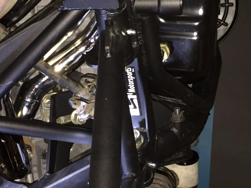

I've had my AJE for 5yrs...daily driven for first three. I love this thing. I run the stock control arms. Its been under a 347...306... And its going under my 331. I've never had an issue. Through snow and pot holes here in Maryland...with salt brine and all. Only touch up I had to do was on the upper spring perches just a little surface rust on the back side where the powder coat was compromised. I like the fact that you can get mounts for almost any motor through them. Absolutely no header or pan clearance issues. Best money I've spent so far....I've broken everything else at least once. [emoji108] [emoji108] [emoji108]
