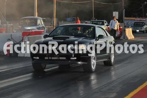

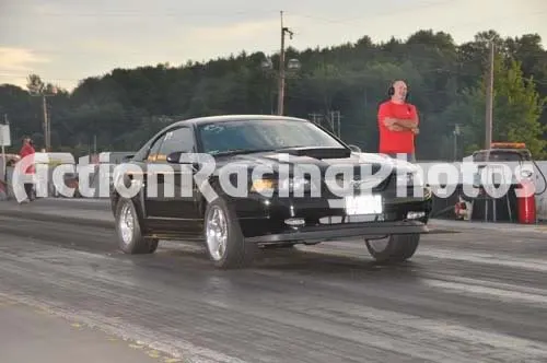

here is a couple of pictures of my launches
