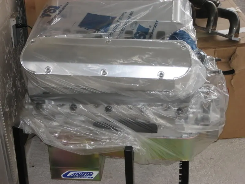

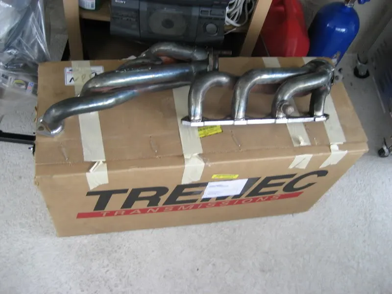

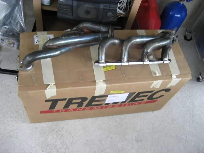

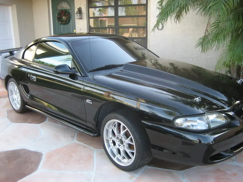

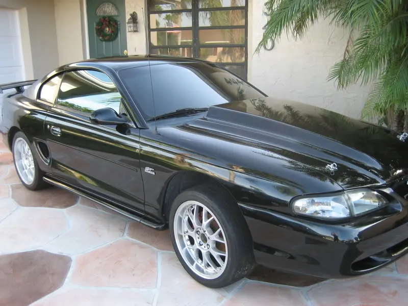

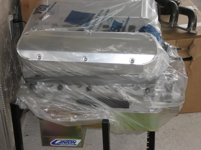

Pics

beautiful car.... ill take the n20 off your hands...
Yobi1Kanobi
Apr 9, 2003
559
Dec 12, 2006
  • Dec 12, 2006
i might consider that but not right now i gotta chk to see if its working
