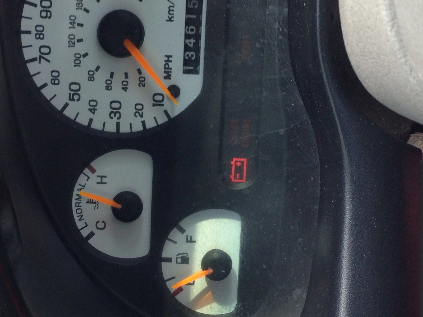

Wes medina New Member Sep 22, 2013 5 0 2 Miami, Florida Sep 27, 2013 #1 Sep 27, 2013 #1 I changed my alternator two days ago because it wasn't charging my battery and today my battery died again what can it be? The battery is a month old Attachments image.webp 304.7 KB · Views: 172

Nick D Member Jan 13, 2013 38 2 19 New York, NY Sep 27, 2013 #2 Sep 27, 2013 #2 check the connection between the alternator and the battery, make sure the wire is not warn out, also check the Fuse, it could be burn out http://brianesser.com/technical-information/alternator-wiring-diagrams-and-information/

wmburns SN Certified Technician Aug 14, 2009 5,892 514 204 Houston Texas Sep 28, 2013 #4 Sep 28, 2013 #4 In addition to checking the fuses and the battery terminals also check to be sure that the correct alternator has been used (2 wire vs 3 wire).

SyberSaint Founding Member Oct 24, 2000 252 5 19 San Antonio, Texas Nov 6, 2013 #5 Nov 6, 2013 #5 What did you find out about this problem?
Wes medina New Member Sep 22, 2013 5 0 2 Miami, Florida Nov 6, 2013 #6 Nov 6, 2013 #6 SyberSaint said: What did you find out about this problem? Click to expand... It was a cable going to the alternator that was touching ground but now everything is working perfectly
