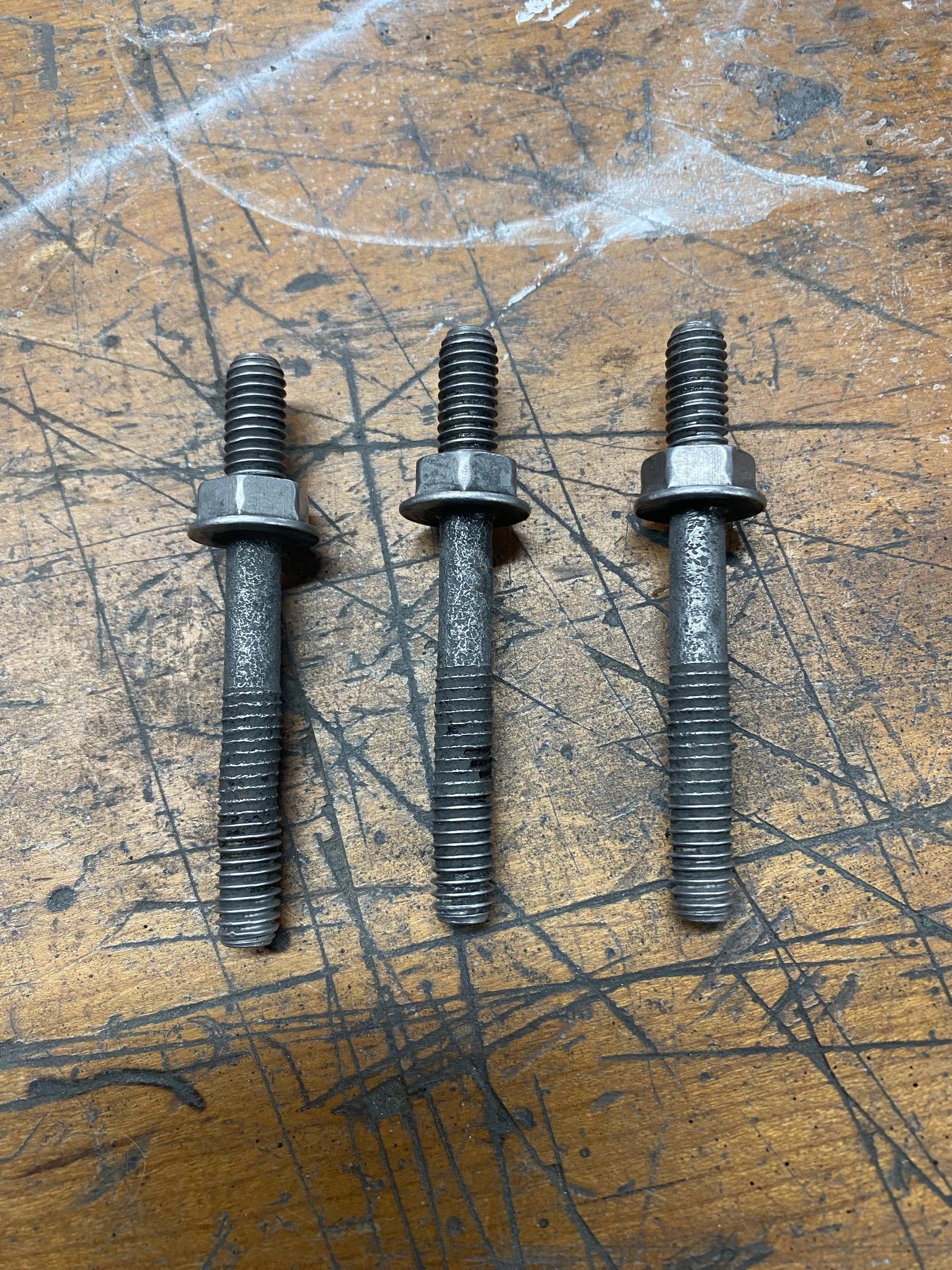

Anyone have a source for these 4 lower intake bolts (I broke one removing the manifold)? There the ones on the 4 corners. I haven’t been able to source an OEM replacement. Thank you.
I want to buy 4. I have 5; one for the heater tube, two up front to support accessory drives, and two in the rear that I’m using to support wiring and vacuum tubes routed in the rear. I broke the one in the rear, and the other one is eaten-up by the cooling system. The two up Front didn’t cleanup well, so I want to replace those 4 corners.

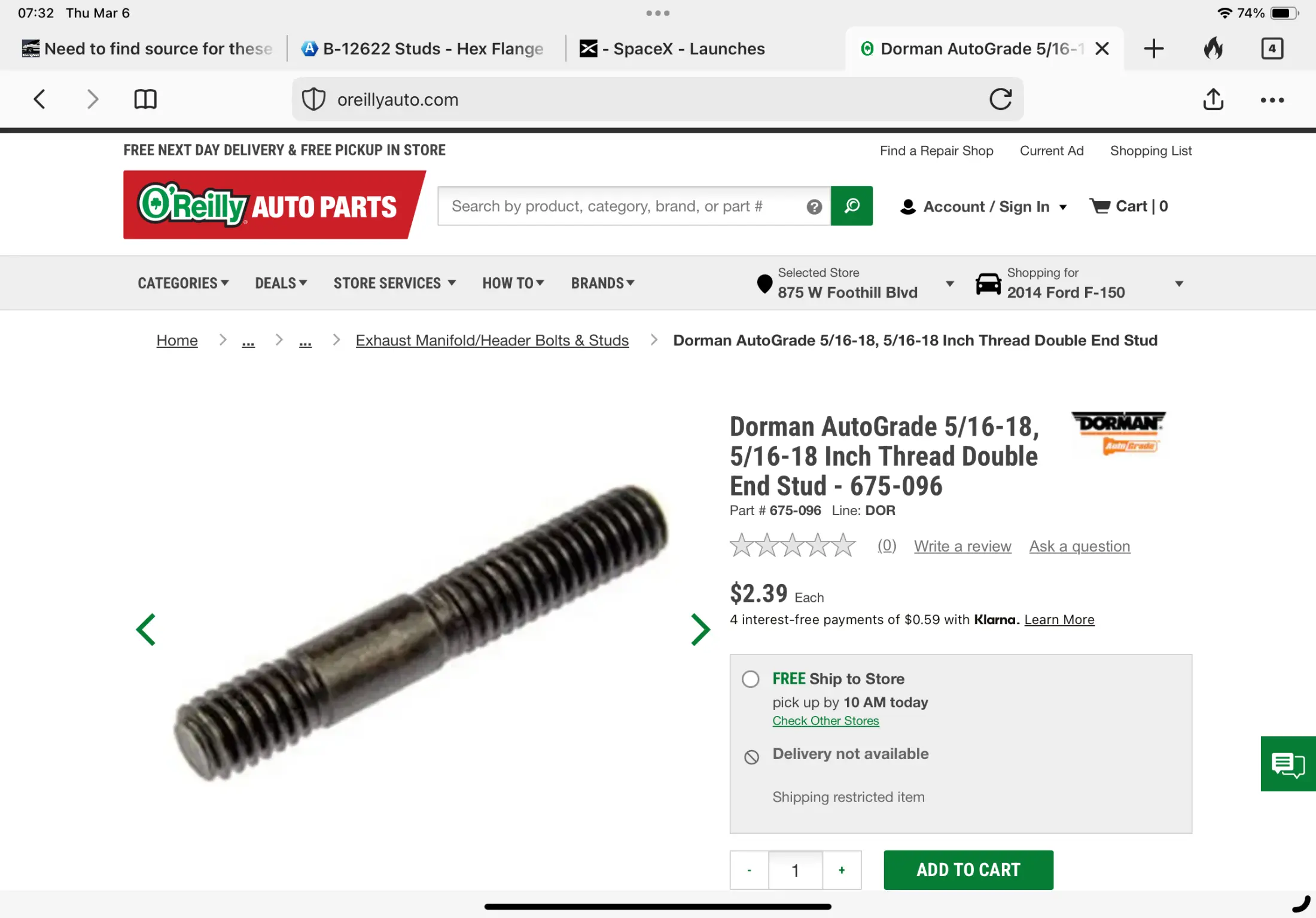

Should be able to get the studs from an auto parts store.
The threads that go into the heads are 5/16-18 and the stud need to be 2-1/2” long. Typically the threads and nuts on to top are 5/16-24 or at least the ones on my cars are.
Search the following:
Double End Stud 5/16-18 X 5/16-24 X 2-1/2”
They are typically called out as an “automotive stud” or “manifold stud”.

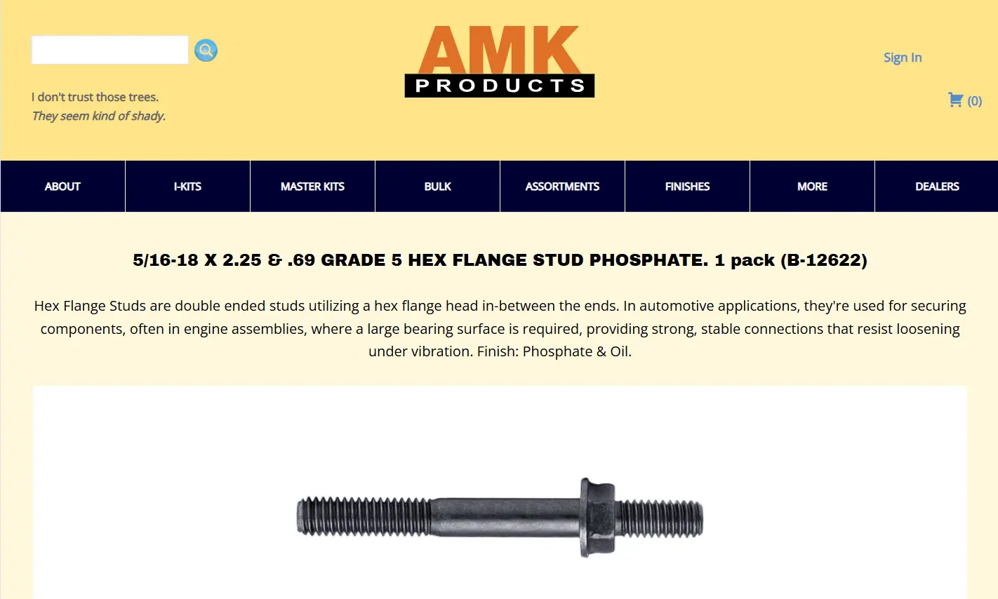

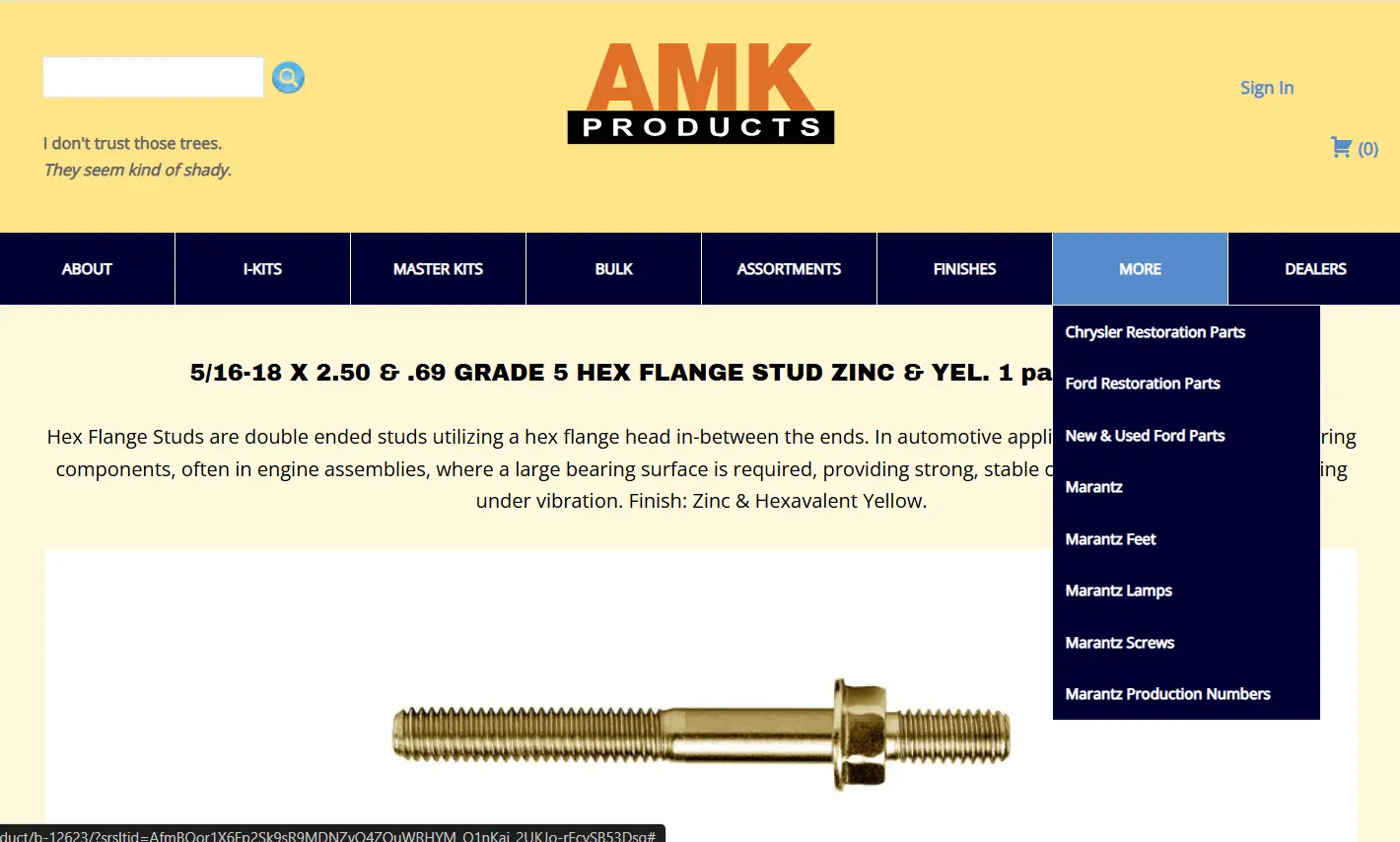

I did a little searching, that site has been the only one I've been able to find so far. I found that they offer that style in both black oxide and yellow zinc. Pricing is the same.
I didn't follow the links above, but it looks like they may offer different specialty fasteners if you need them. :shrug:

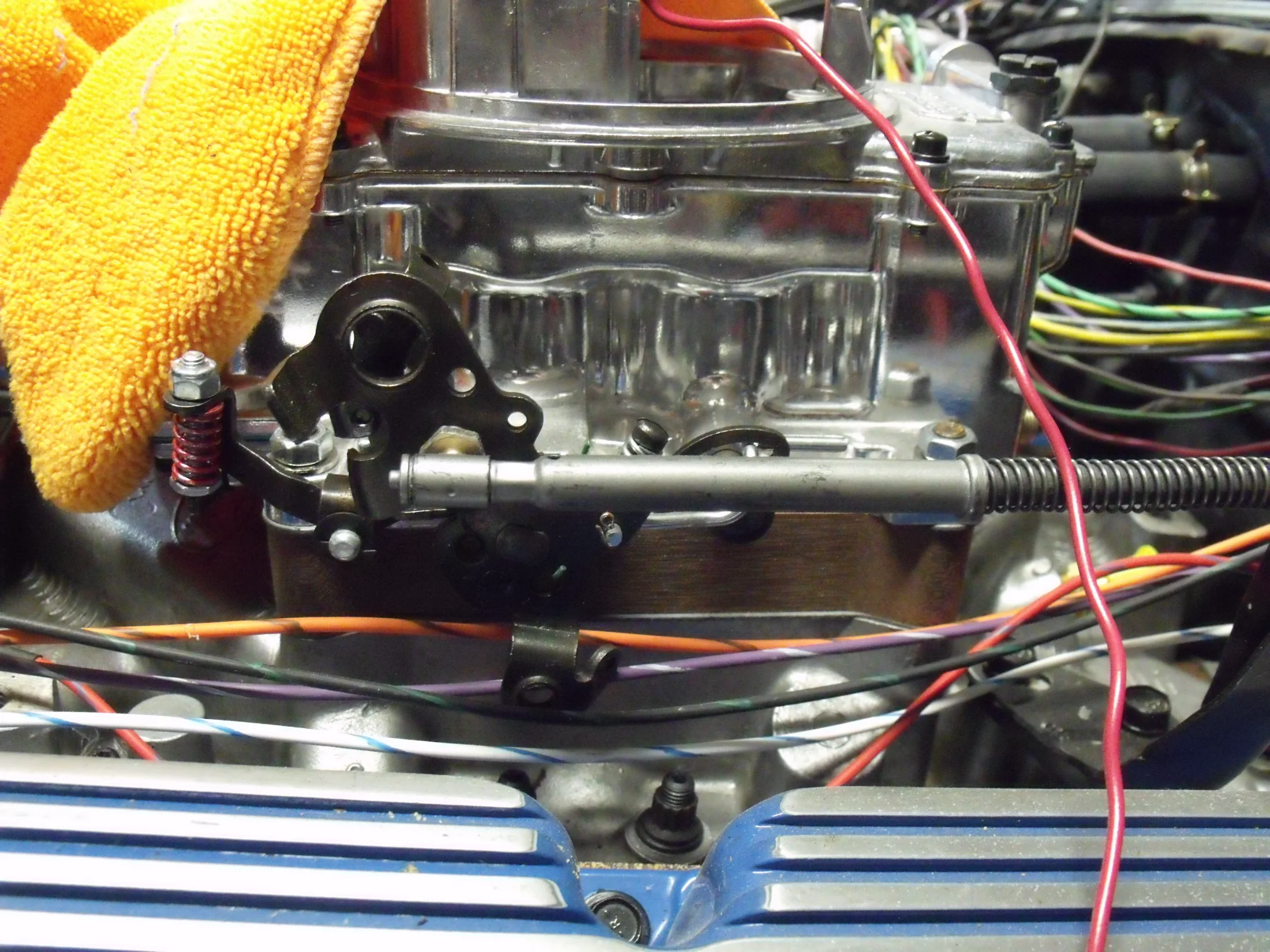

Hell, I may buy some myself! I could use something like these for the coolant tube I installed in the Cobra, maybe have a couple more on the opposite side of the engine to be able to secure wiring, then my GT may need replacements when I work on that.... :chinThe wheels are turning! :rlaugh:
