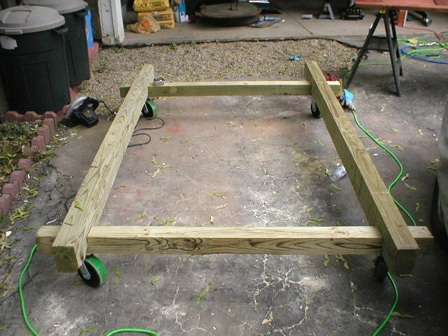

Without seeing it, I think your best bet is to build a wooden dolly and strap the car to it.
I stole this pic from Google, but something like this.

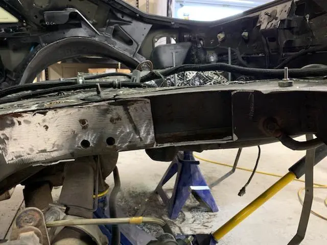

Is the car caged? If you are using a trailer the concern would be where you attach the tie downs, the wheels or the rear axle/front control arms would be my choice, I'm concerned about the frame notches, are they behind the springs?
Not at the moment but i guess they could be?...the reason im asking this is bc i havent notified the shop yet...i will be doing so monday and they are 4hrs from me. So when i ask them to get it ready to be transported via trailer i want to be prepared when i go down in case i need to bring extra stuff. They havent been the friendliest people to deal with and it really upsets me to be dealing with this. I searched for almost a year for a shop and all decent ones are hours from where i live (rural area)...and of the few that even responded to my inquiries this place seemed the best for what i was looking for...needless to say ive already spent way more money than i believe i should for the little bit of work thats been done and after our last conversation i dont feel comfortable having him continue.
Im glad u mentioned that bc ive been so flustered i was trying to figure out what i was going to do...and gas tank etc is obviously out so ill just have to push it onto the trailer...the trip should be mostly highways which is good...you think the frame cut is okay to travel with? I dont tow much if you cant tell lol.

If they cut the junk out of the inner frame rail to make room for the wheel tub, they more than likely cut the upper stock spring perch away too (I would have). And unless they have fitted an upper shock mount in there will be no way to keep the car off of the tires when they put the car on its suspension. You can cut a couple of 4x4 wood blocks that will sit on top of the axle and the bottom of the frame to serve as a temp "wedge" to act or serve as a coil over to keep the car off of its tires instead.
If they have fabricated both upper and lower shock mounts, then they could just build simple tube spacers that will go in place of the coil over that would be cut and welded to ride height.

They havent fabricated any shock mounts etc...another issue ive been having with them. I had a whole layout of what i wanted and what i needed done and would require their knowledge to make sure everything works properly. He hasnt done anything about shock mounts yet etc. Been 3 months and this is all thats done. I stripped the whole car except the fuel tank so i could drive it on and off the trailer so it was ready to be worked on. I dont know if the spring perch has been cut yet but after reviewing the pics i believe it is. Maybe the 4x4 blocks will work and i can run a strap around the housing and up through the tubs to hold it all together.
