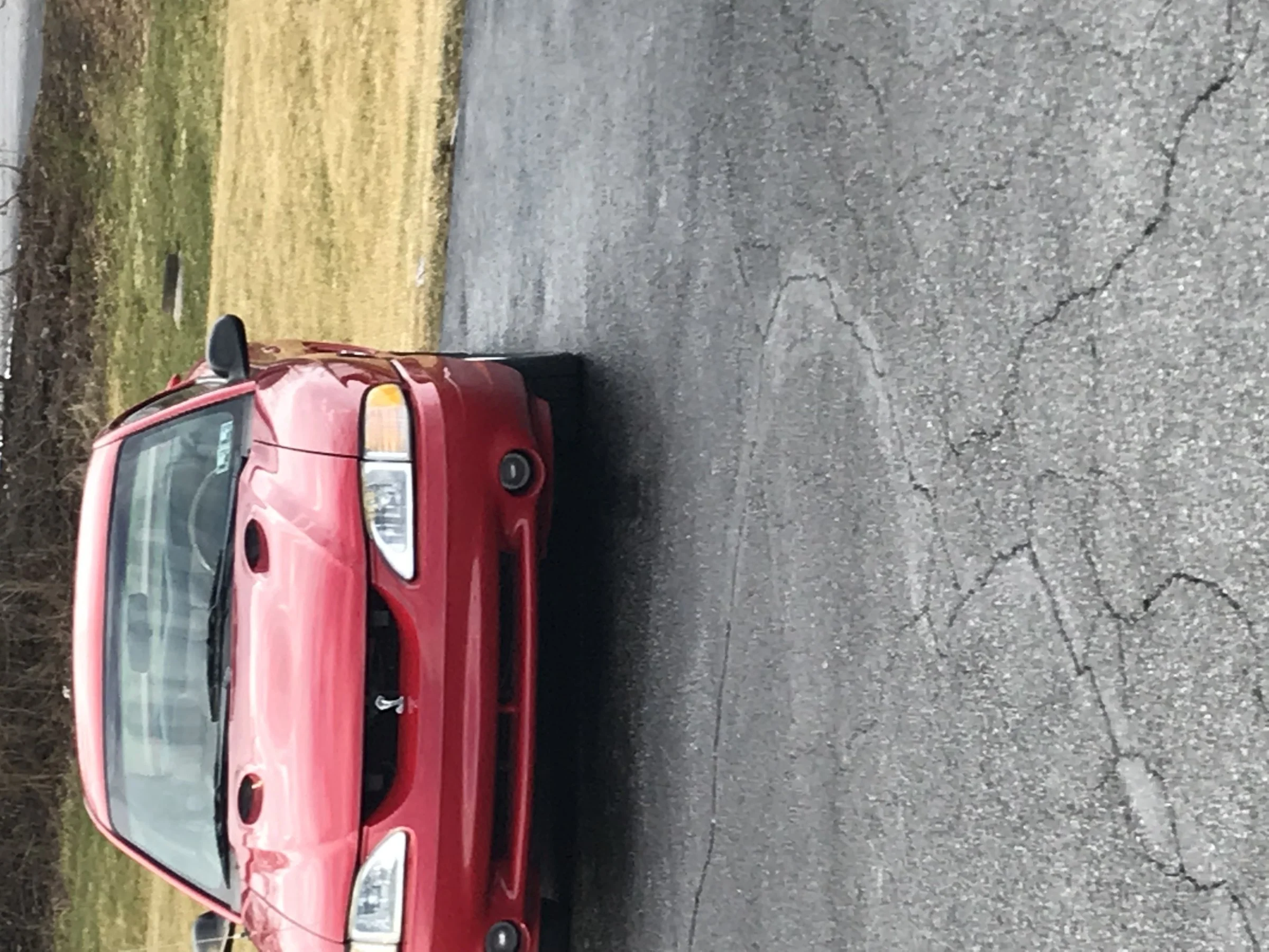

Hey guys I just noticed the other day that I have negative camber in my drivers side front wheel it’s not horrible but it is noticeable. The car is a 97 cobra and there is sqreeching noise when turning the wheel and the steering wheel and been off a little since I’ve owned it. The car has sat for most of the past 4 years and probably only 1000 miles in that time. Any suggestions what to look for would be appreciated. I should be getting under the car soon whenever the weather is a little warmer. Sorry that’s the only picture I got of it so far

I would jack it up and remove the wheels, then you can turn and check it out, of course it might be evident when you first pull the wheel. Strut or ball joints come to mind though.
Yeah, you are going to want to pull a wheel and check that out ASAP. I really wouldn't delay here as it could lead to a suspension failure depending on what it is.
