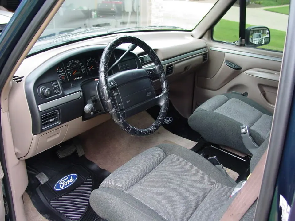

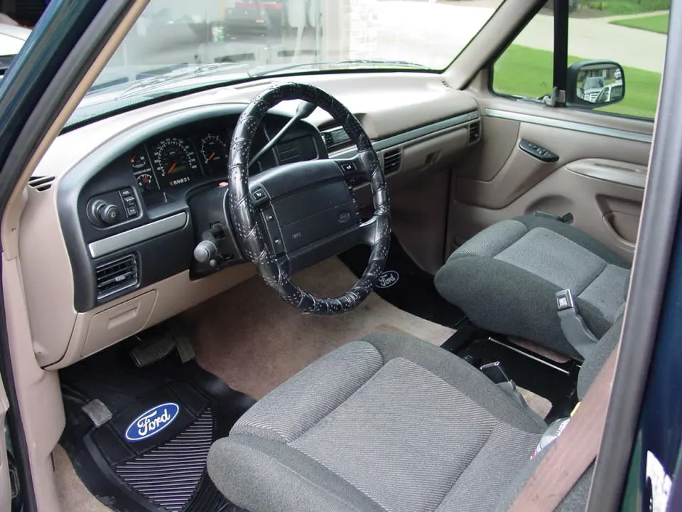

Here are pictures of truck it was built for..
Already has complete 93 lightning suspension, lightning 8.8 with 4.10's, and put the lightning seats and gauge cluster in... And will have lightning motor when this one goes in..
