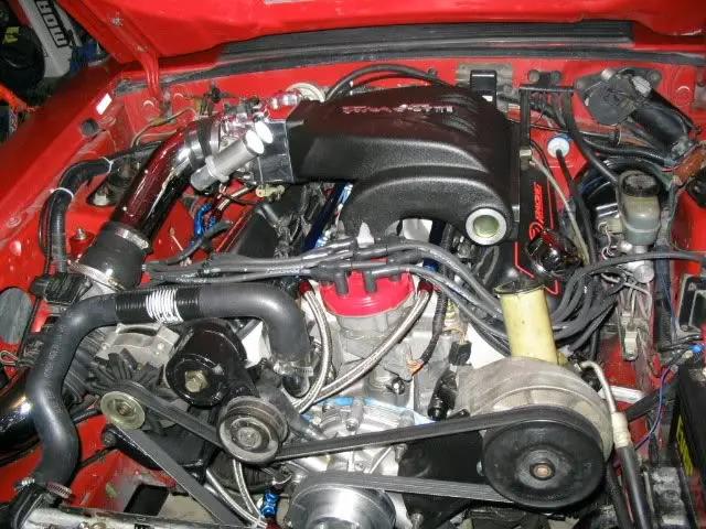

here is my buddies 351 setup. he is using the FMS P/S bracket.
