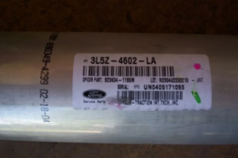

I finally got around to getting my Ranger Drive shaft down to Advanced Driveline to have it shortened. I purchased this Driveshaft off of Ebay for $100.00 + $30 shipping. I then purchased the Cobra Pinion flange for $25.00. Well I dropped off the driveshaft and 2 days later they called me to say it was completed. The total cost for having it shortened 9 inches,Balanced and Trued was $80.00. I then looked to see what would be need for the install. I had to purchased a Harmonic Balancer puller($8.00),a quart of synthetic gear lube (just in case)($13.00)and 4 Flange Bolts ($11.00). I dropped the exhaust and the P.O.S stock shaft. Pulled off the stock pionion flange and the Gear oil can running out. I expected that and had a pan ready. Installed the Cobra pinion,torqued to to the correct specs. Spun the wheels to check the torque. Installed the aluminum shaft and refilled the 8.8 rear end.
The car does feel a little different. It feels lighter through the excelerator. I dropped 2 tenths at the track. Ran it up to 130mph with no vibration. A driveshaft loop will be installed by the weekend.
