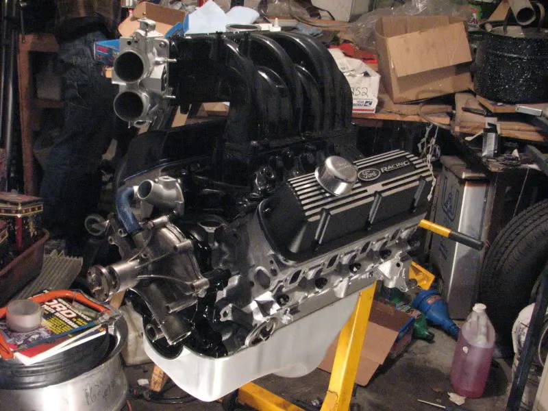

sweet looking intake, is that the stock truck manifold? would be sweet to get a tall spacer, then have the hood cut so just the upper sticks out, haha that'd be badass

And yes it is a truck intake that i powercoated, along with the majority of the engine parts.

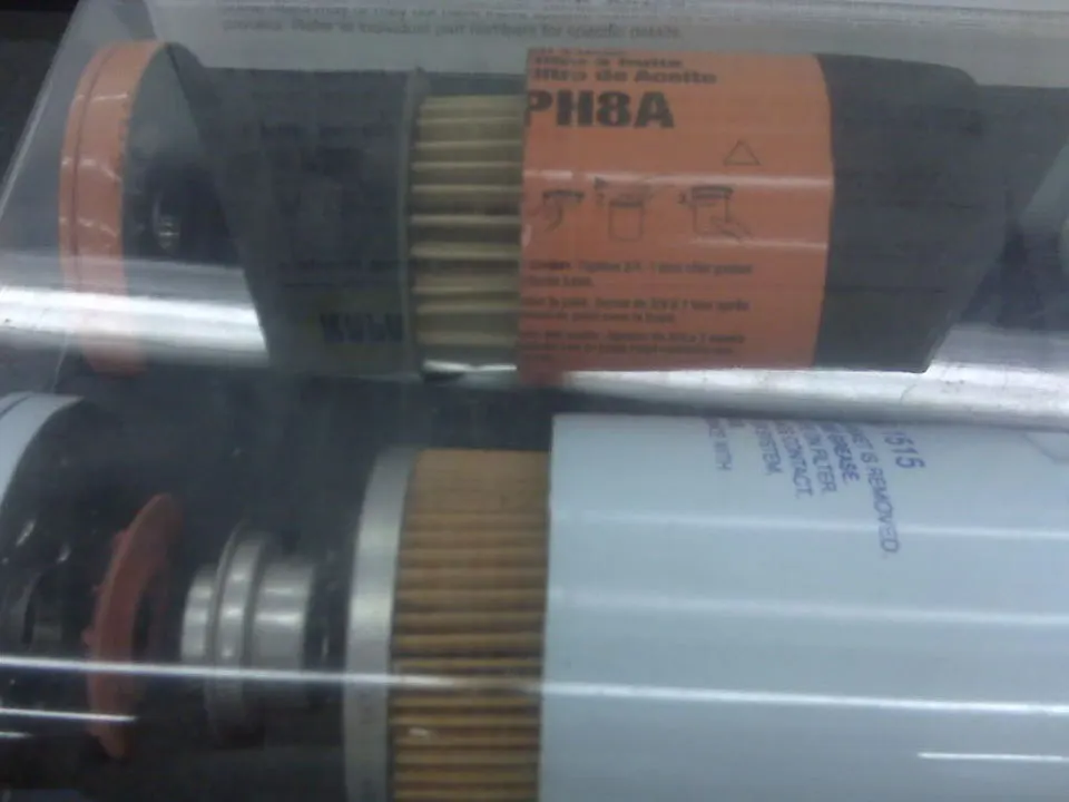

If the oil pressure is low I'd question a cheap filter. A guy that used to do machine work who has been in the field for 40 years told me once about an engine that he machined for a customer. He went to take it out on a TD and lost oil pressure completely. He tore it apart and couldn't find anything wrong. He took it back to the machine shop to find that his Baldwin filter had imploded. Baldwin makes Fram filters.
Here's a pic of a Fram filter and a NAPA (wix) filter just for a visual to see how crappy these filters are.
