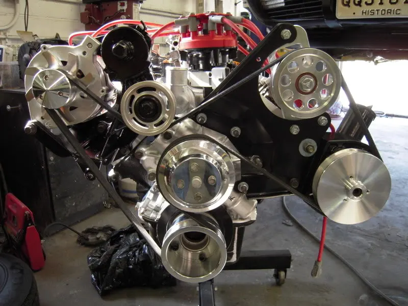

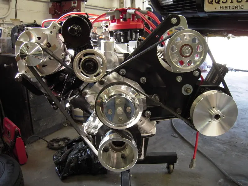

I would just go the cheap route and take it out and run a short belt. I am running a short belt on my engine and it worked great with out the belt being really close to the water pump pulley like other short belts that go from the water pump to the alternator instead of my set up. The belt I am running is napa part # 060837
Here is how the belt routes:
Then you wont have that annoying sound the smog pump makes.
