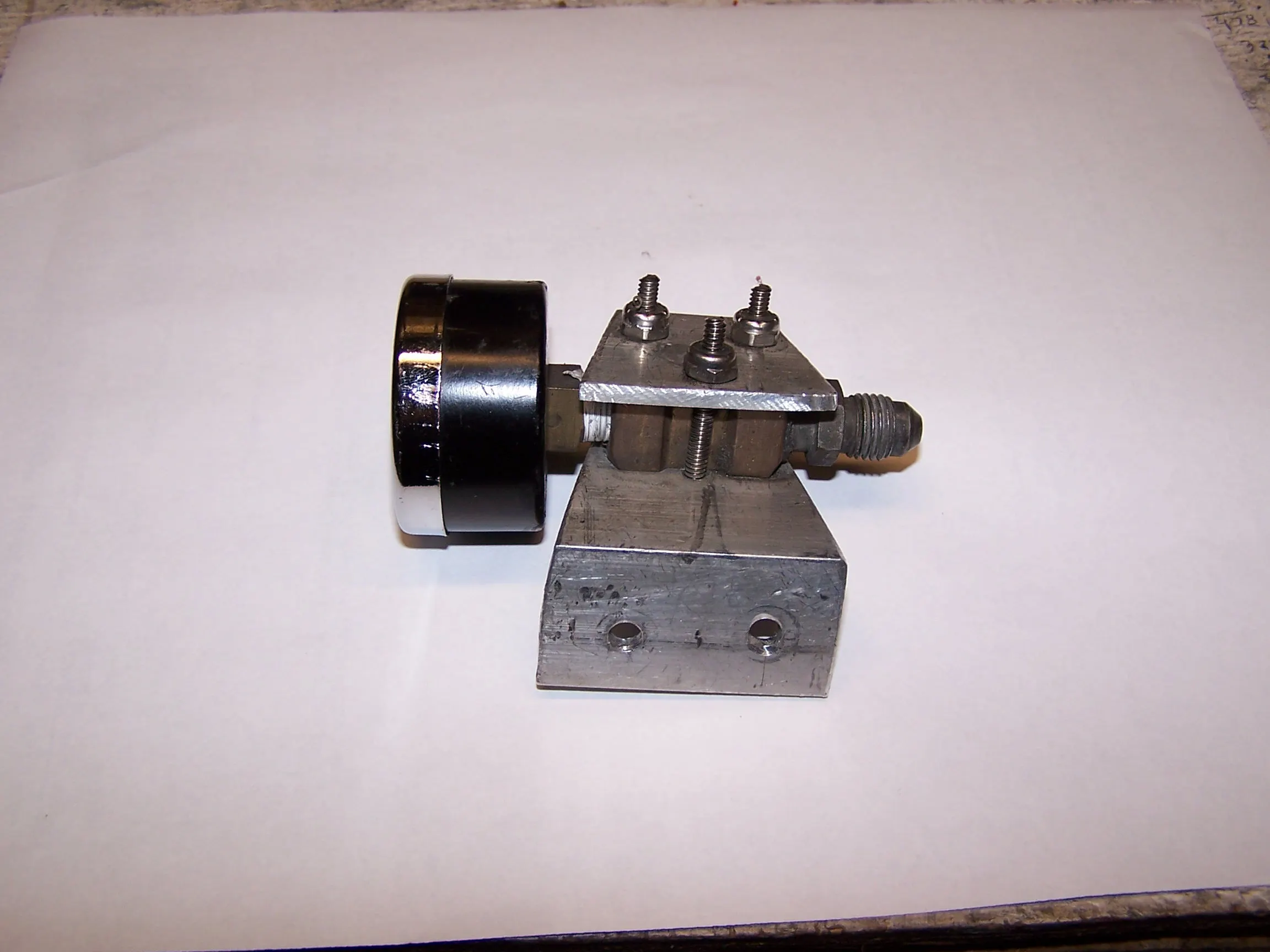

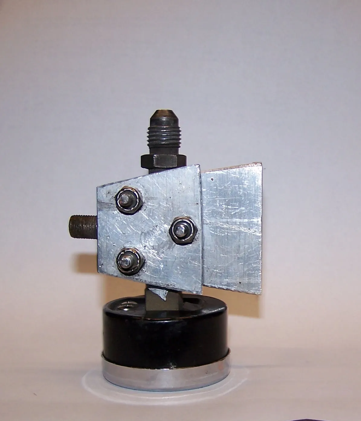

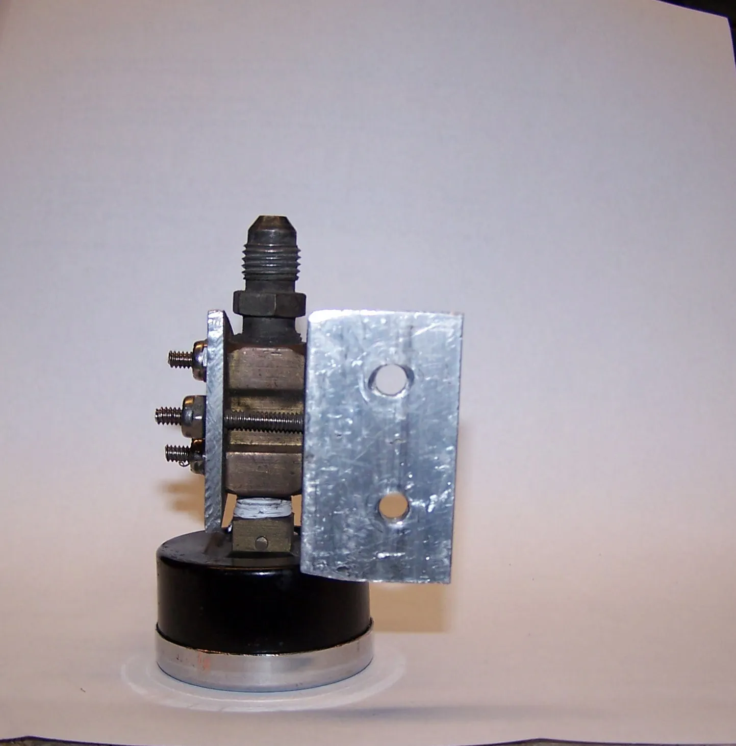

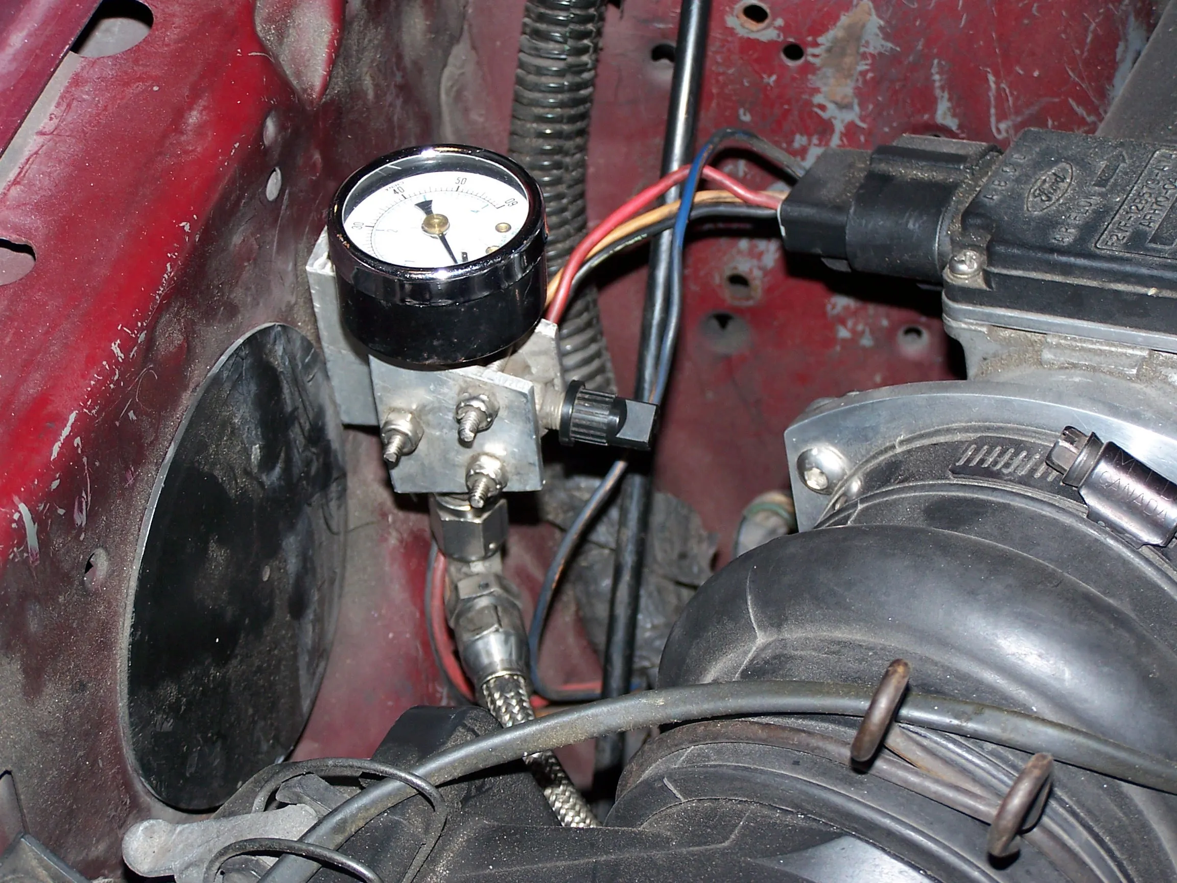

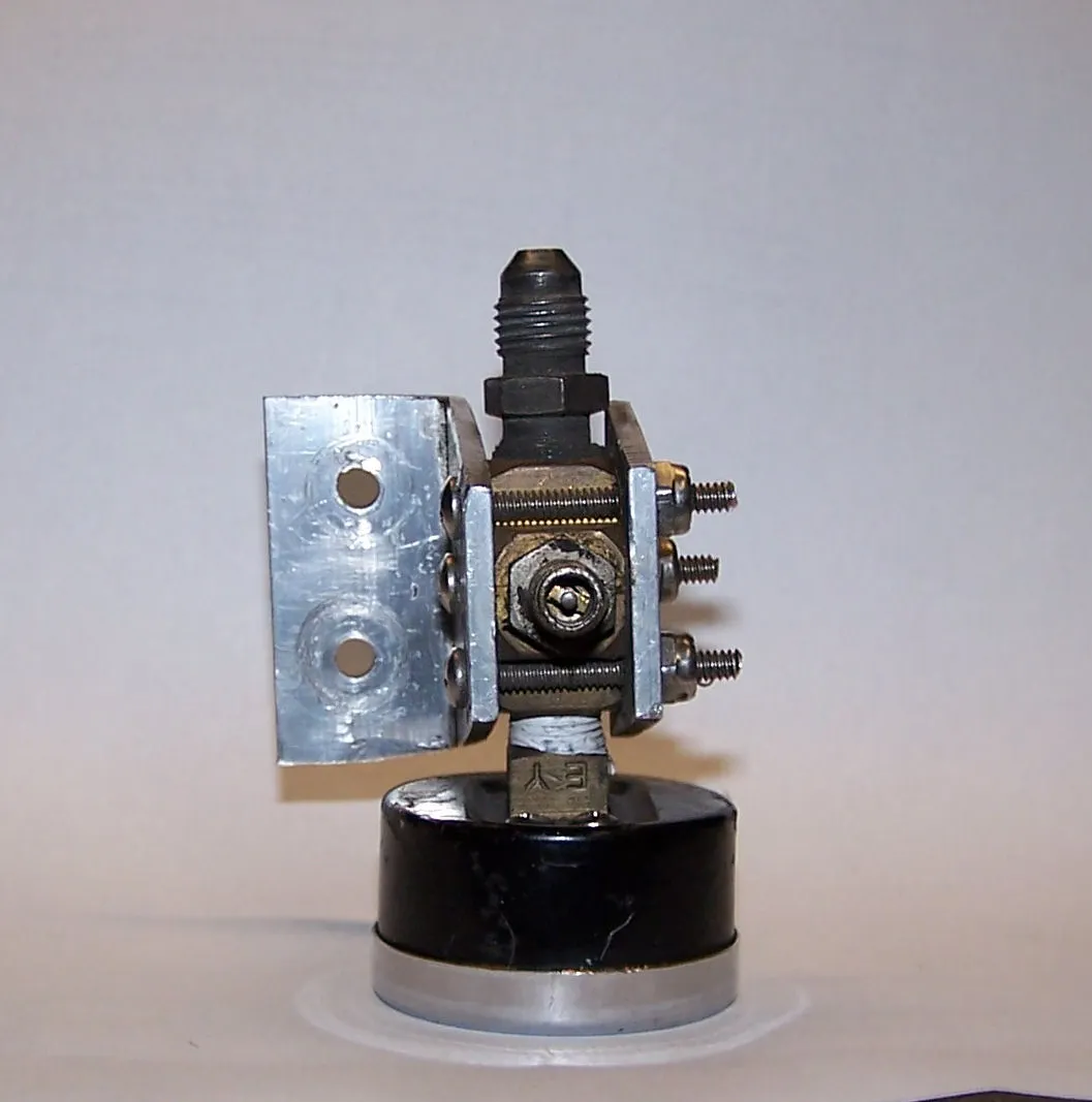

I made my own pressure gauge and holder. I bought the NOS or Autometer adapter that you screw into the place on the fuel line where the schrader valve goes. You have to remove the Schrader valve, but save it, since you will reuse it. I ran a piece of SS (stainless steel) braided hose to a 1/8” pipe brass tee fitting that I mounted on the fender well by the MAF. I made a mount bracket out of aluminum angle I got from Home depot and bolted it to the fender well. Then I mounted the brass tee to it with some machine screws and a plate. I sandwiched the brass tee between the aluminum angle and a flat piece of aluminum that I trimmed off the extra aluminum angle. Three screws laid out in a triangle pattern go through both pieces of aluminum to clamp the tee in place. Put the Schrader valve in the spare port of the brass tee. I used a cheap industrial gauge from MSC Direct (http://www1.mscdirect.com/ P/N 56468499). It works great and was cheaper than (less than $8) anything Summit had.
If you look through the MSC Direct catalog, you can find any type of gauge you want, including liquid filled. You only need a liquid filled gauge if you mount it directly on the engine. The liquid filling dampens out the vibrations. .However there are a couple of people who have had nasty engine fires when the gauge or the fuel injector rail broke due to vibration because of the gauge directly mounted on the fuel injector rail.
You can buy the Autometer Stainless Steel braided hose for like $60. Or a local shop that makes hydraulic hose assemblies can make it for you at a cheaper price. Ordinary low pressure hydraulic hose can be used in place of the Stainless Steel braided hose, the Stainless Steel braided hose just looks nice. I got mine for $4 at a place that sells industrial and military surplus parts of all kinds. The Stainless Steel braided hose goes for about $4+ a foot and the fittings are probably about $6-$10 each. You can make your own and save some $$$, the shops may have a setup or labor charge to fabricate the hose assembly.

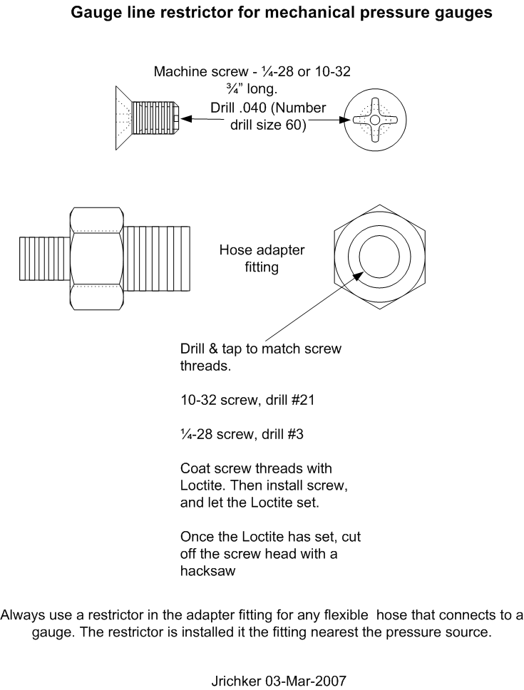

Safety device to prevent major fuel loss in the event of a failure of the hose, fittings or gauge...
attachments\596576
That fuel gauge looks great, I like the fact it's off the fuel line and mounted to the inner fender. Thanks for the advice on liquid filled gauges as I live where it freezes four months of the year and the car sits in an unheated garage. I won't need one with your setup. I used to have a friend who owned his shop and would loan me his Snap-on fuel gauge. The beauty of it was the rubber extension as you could run it out under your hood on the passenger side. That let you see the gauge when you drove the car. Now not down the highway but you could get a few hard hits in first and second and watch your fuel pressure at the same time. Pull over and adjust the FPR until she holds 40 PSI. I know you can blip the throttle and watch the gauge with the car not moving but I don't know if that's as accurate as there's no load on the engine. Sure seems simpler though.
