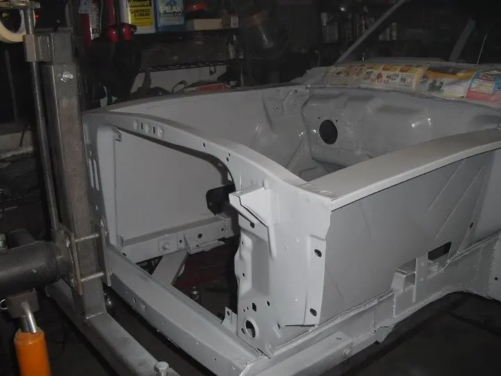

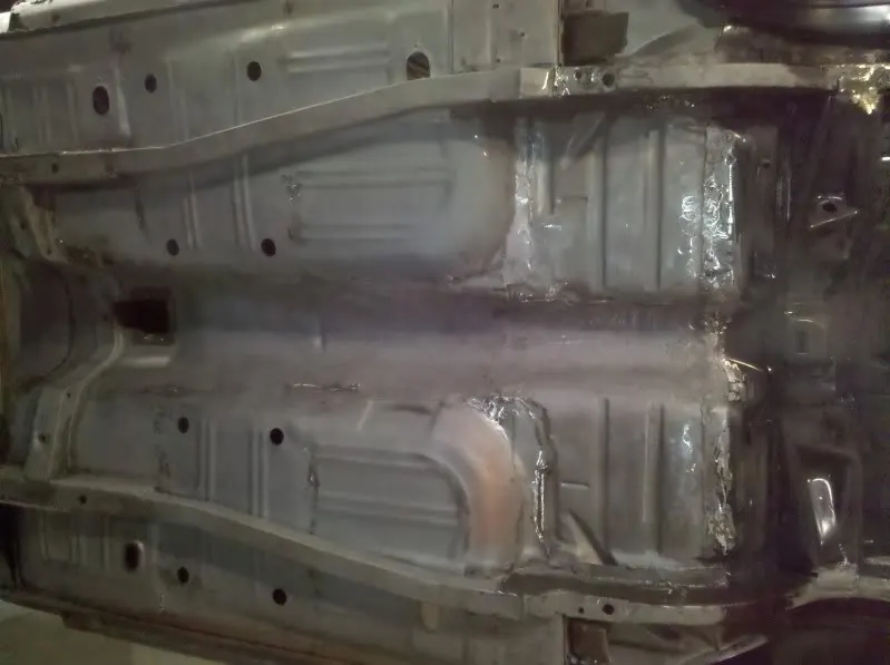

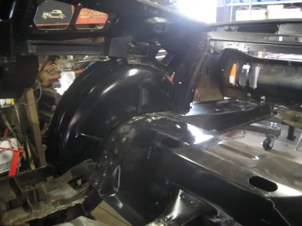

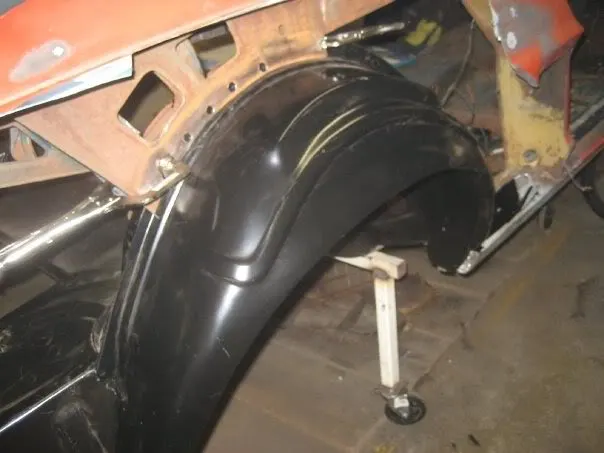

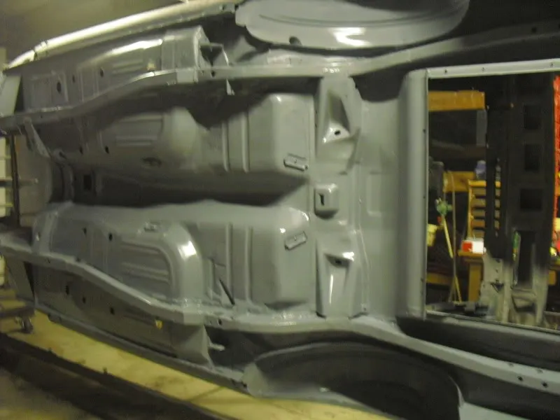

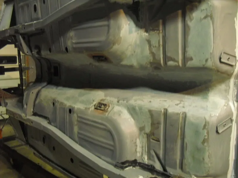

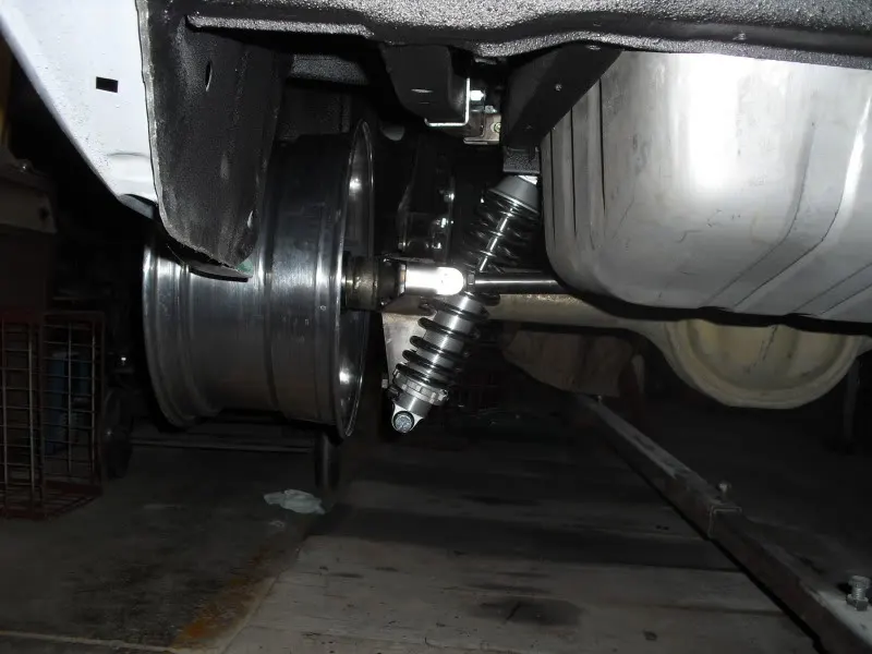

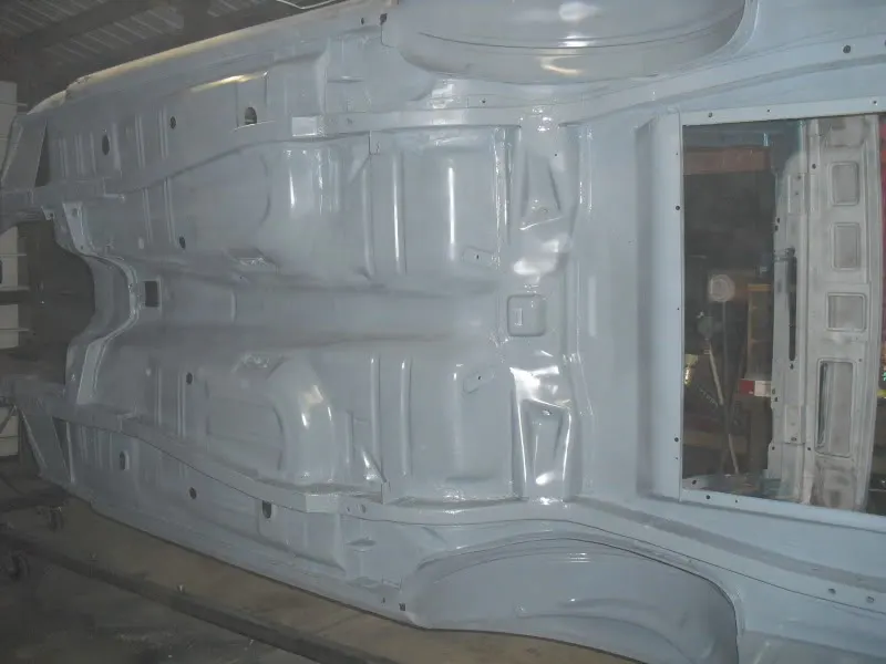

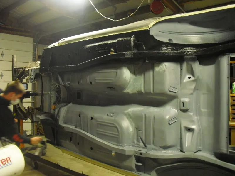

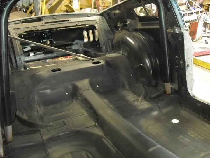

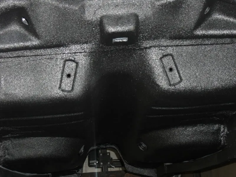

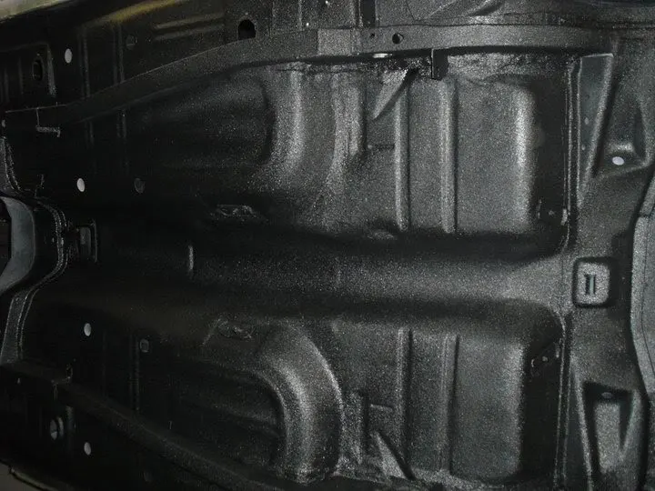

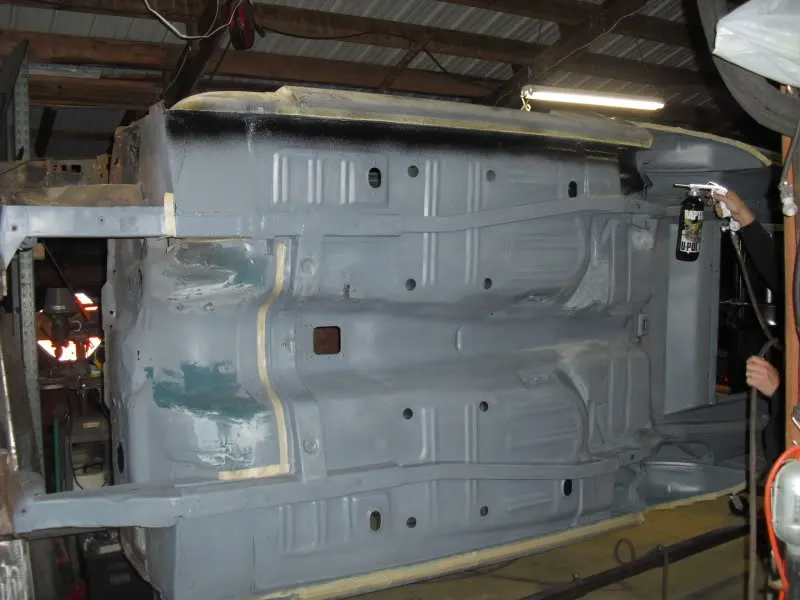

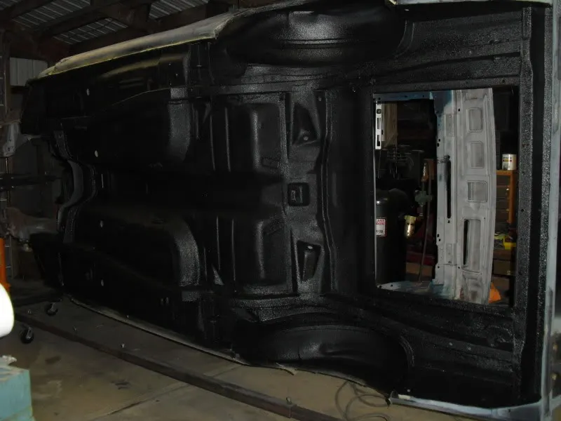

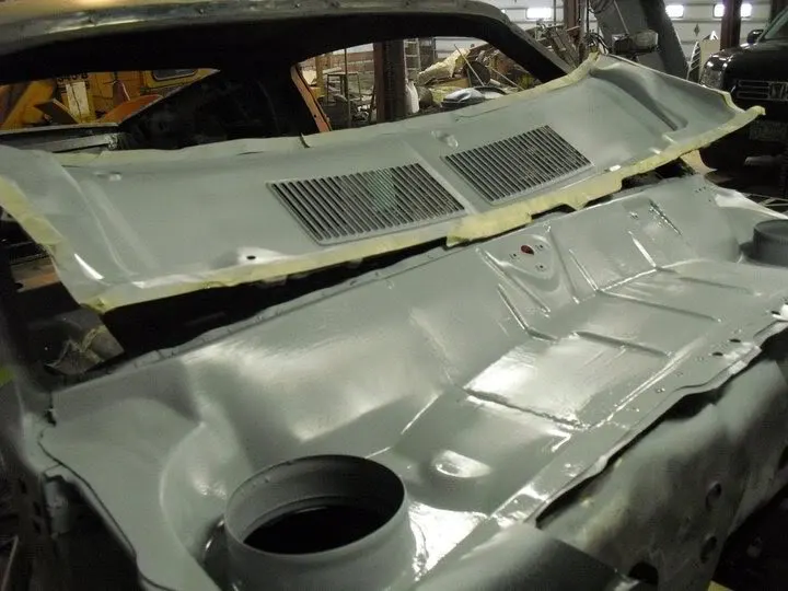

Realmongo: we coated the bottom with U-POL Raptor. We were going to paint it but I really plan on driving it and we thought the textured finish would be the smartest move. We spend lots of time on the bottom sandblasting, replacing brackets, epoxy priming and finishing it with the Raptor. It turned out great. I would highly recommend the product.

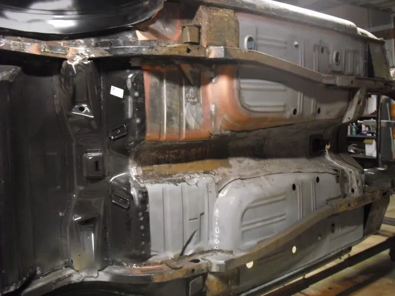

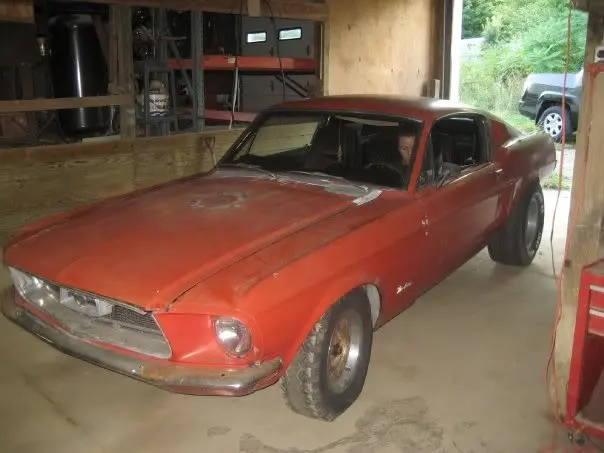

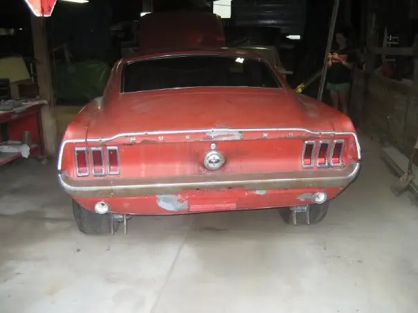

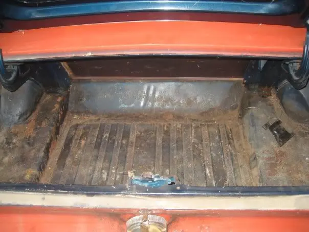

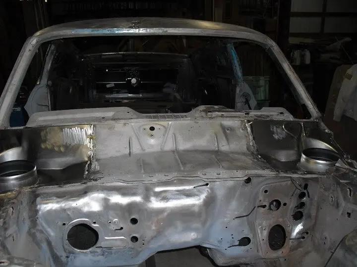

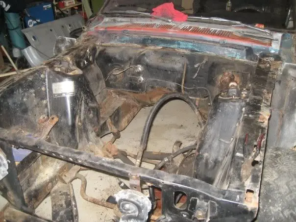

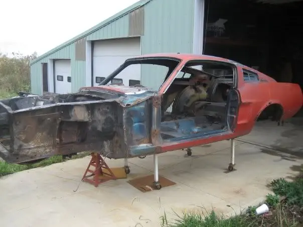

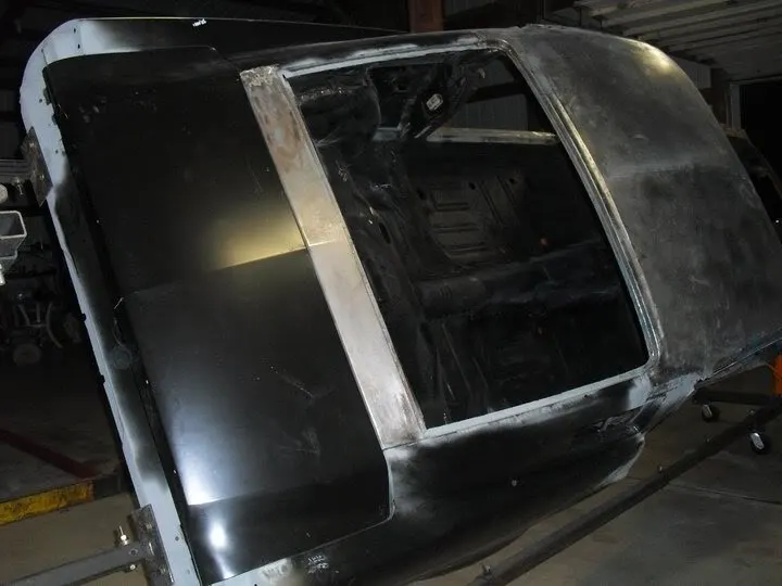

Here is a photo timeline
Before:
Getting there:

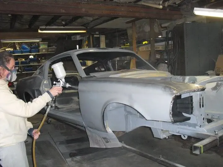

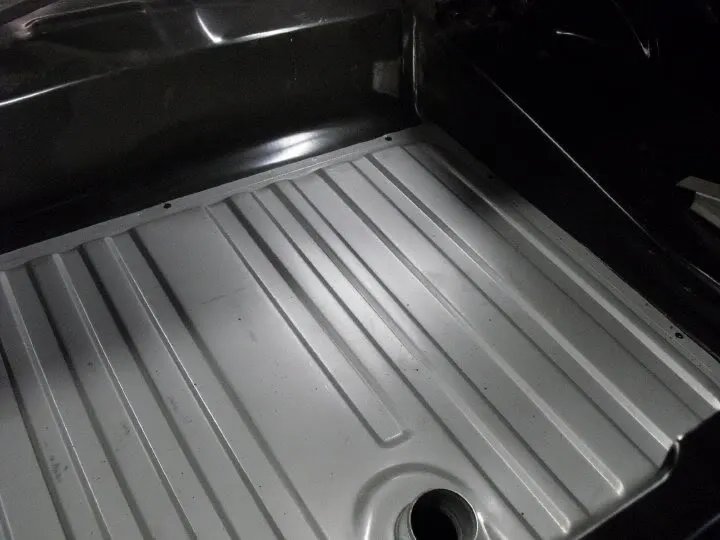

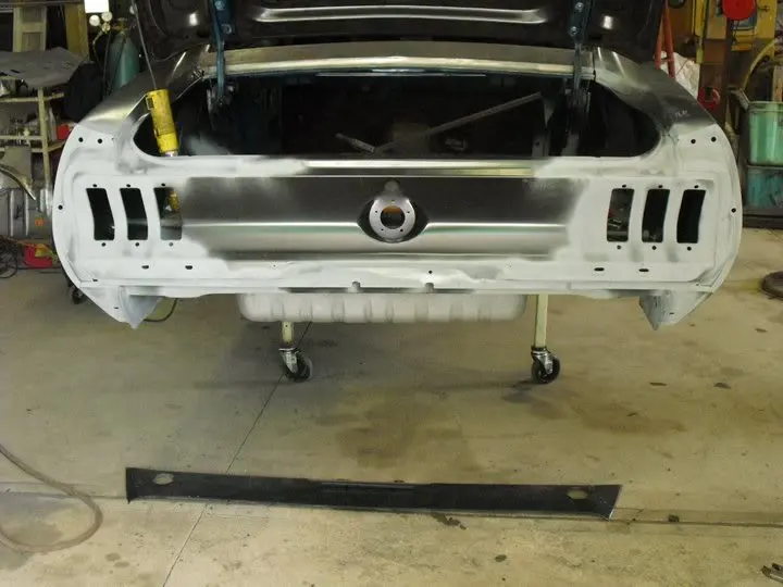

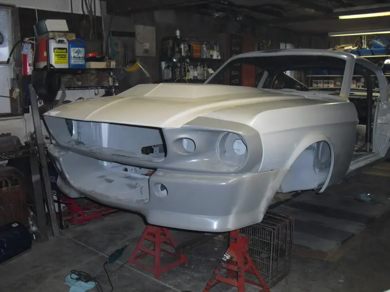

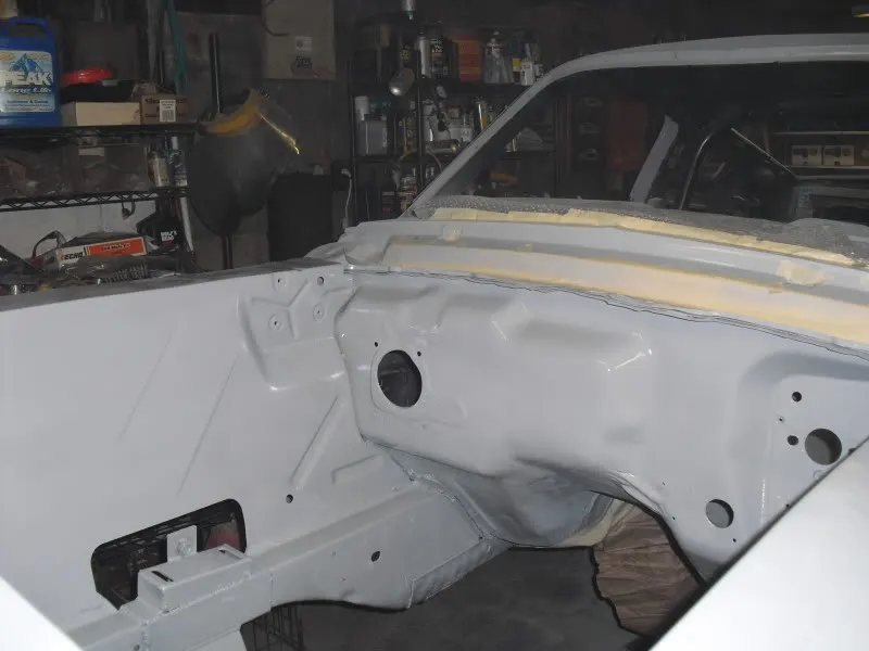

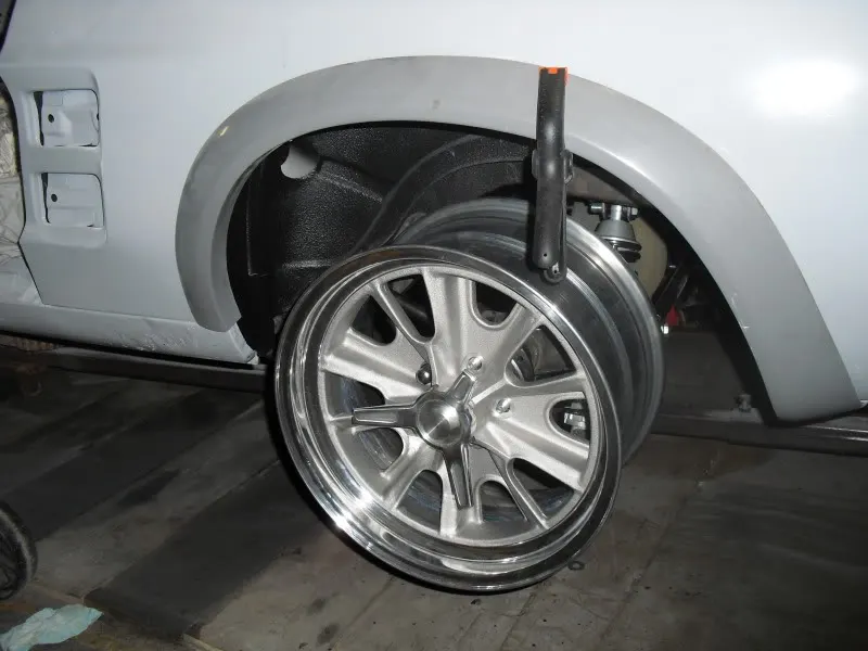

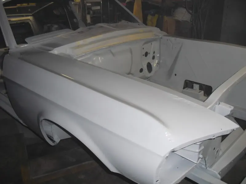

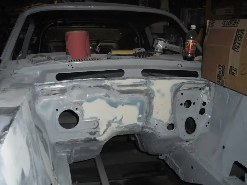

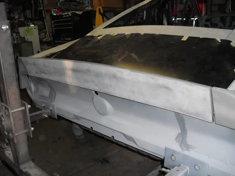

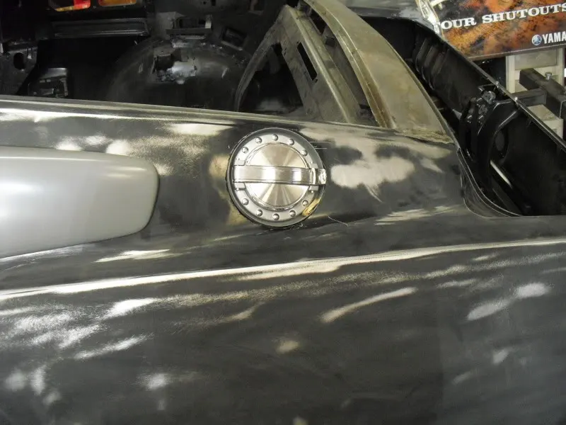

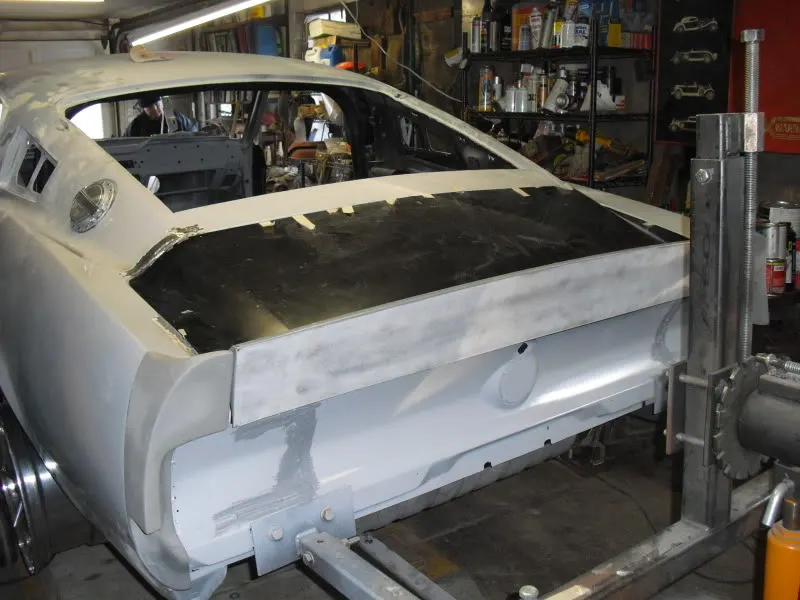

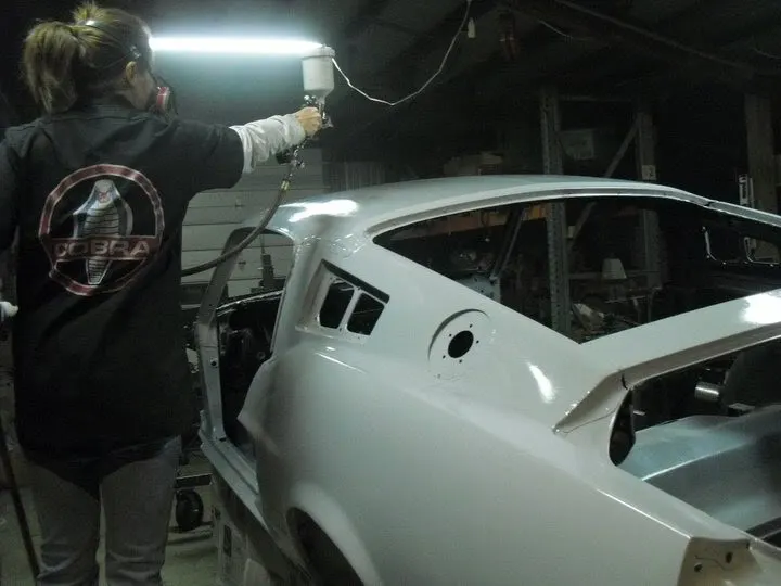

Thanks guys! We got a few more things done this weekend, mostly correcting some gaps between aftermarket panels but she is coming along! We also got some sanding done and were able to set the trunk spoiler in place to see how it would all look.

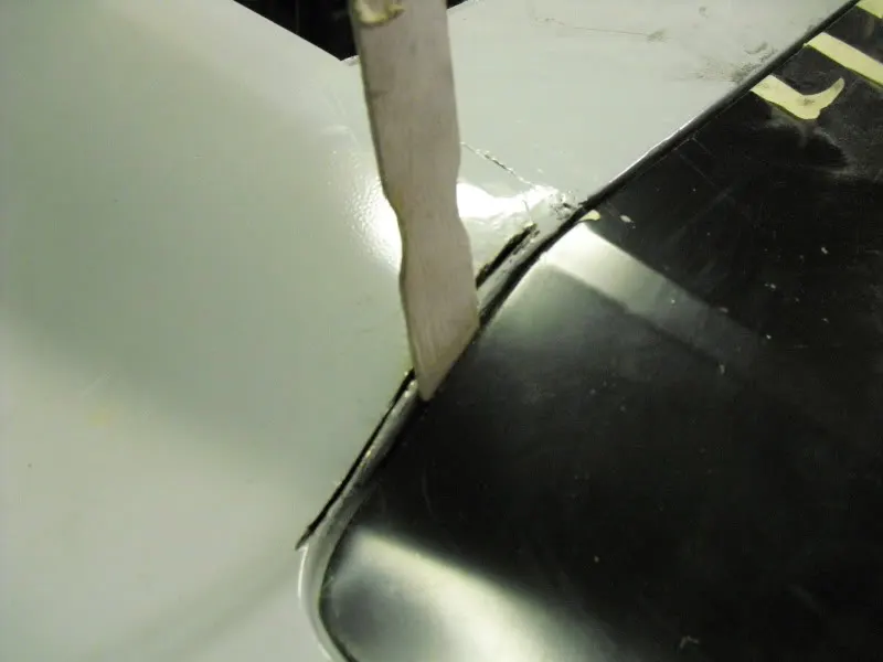

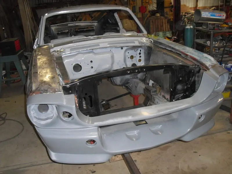

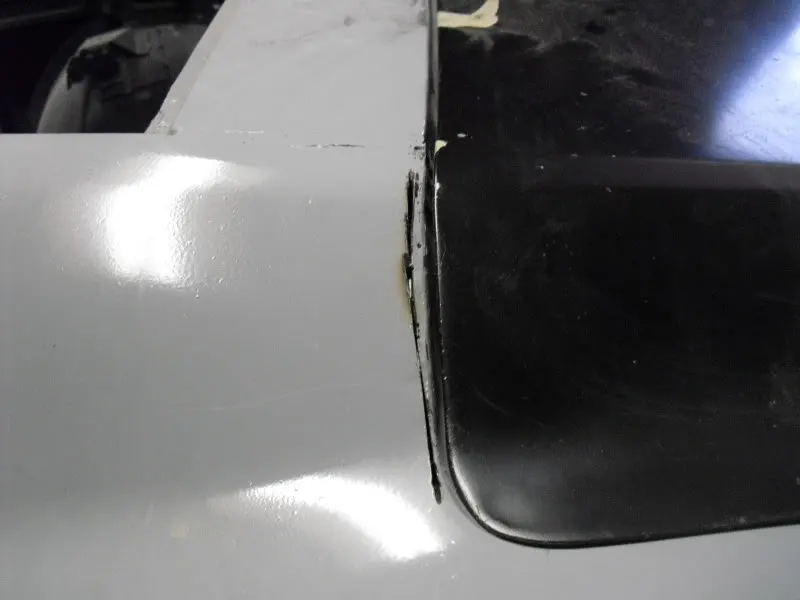

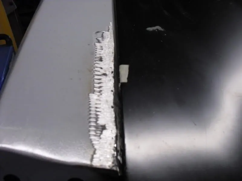

The gap between the aftermarket deck lid and the quarter needed adjusted. Here is what it looked like before:

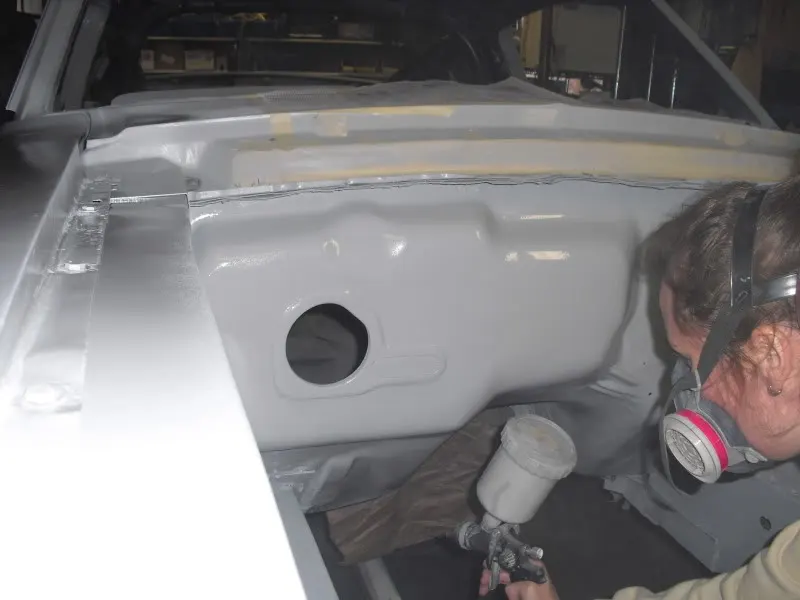

Had to slice it to move it back a little...
Welded and cleaned up:
